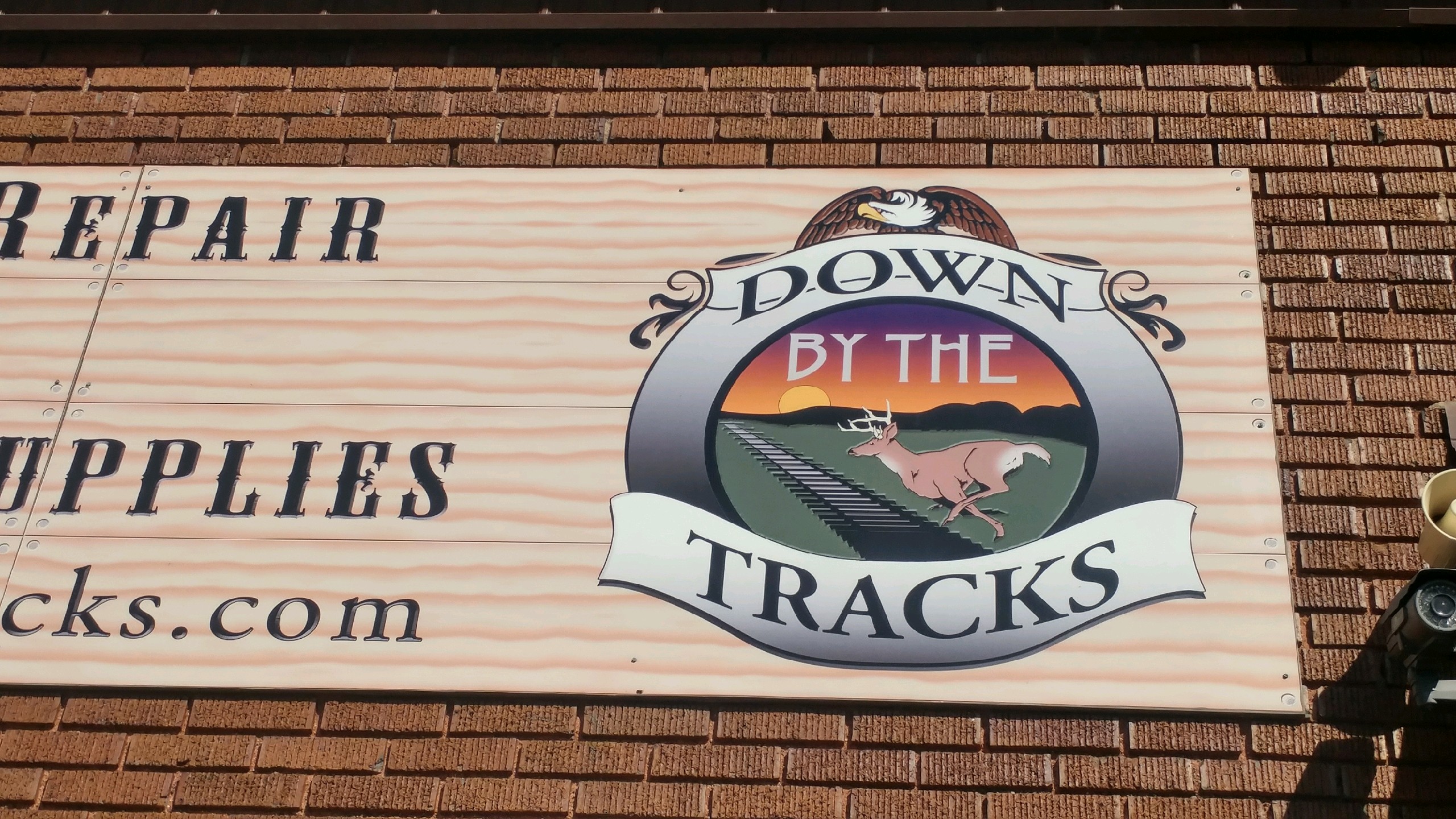

Our gun shop sign was printed on an HP 25500 in the summer of 2010. I dont know what vinyl and laminate was used, but its mounted to MDO. Its about 18 feet off the ground facing due west so it gets full afternoon sun.
Located in central indiana we can get some pretty hot summers.
