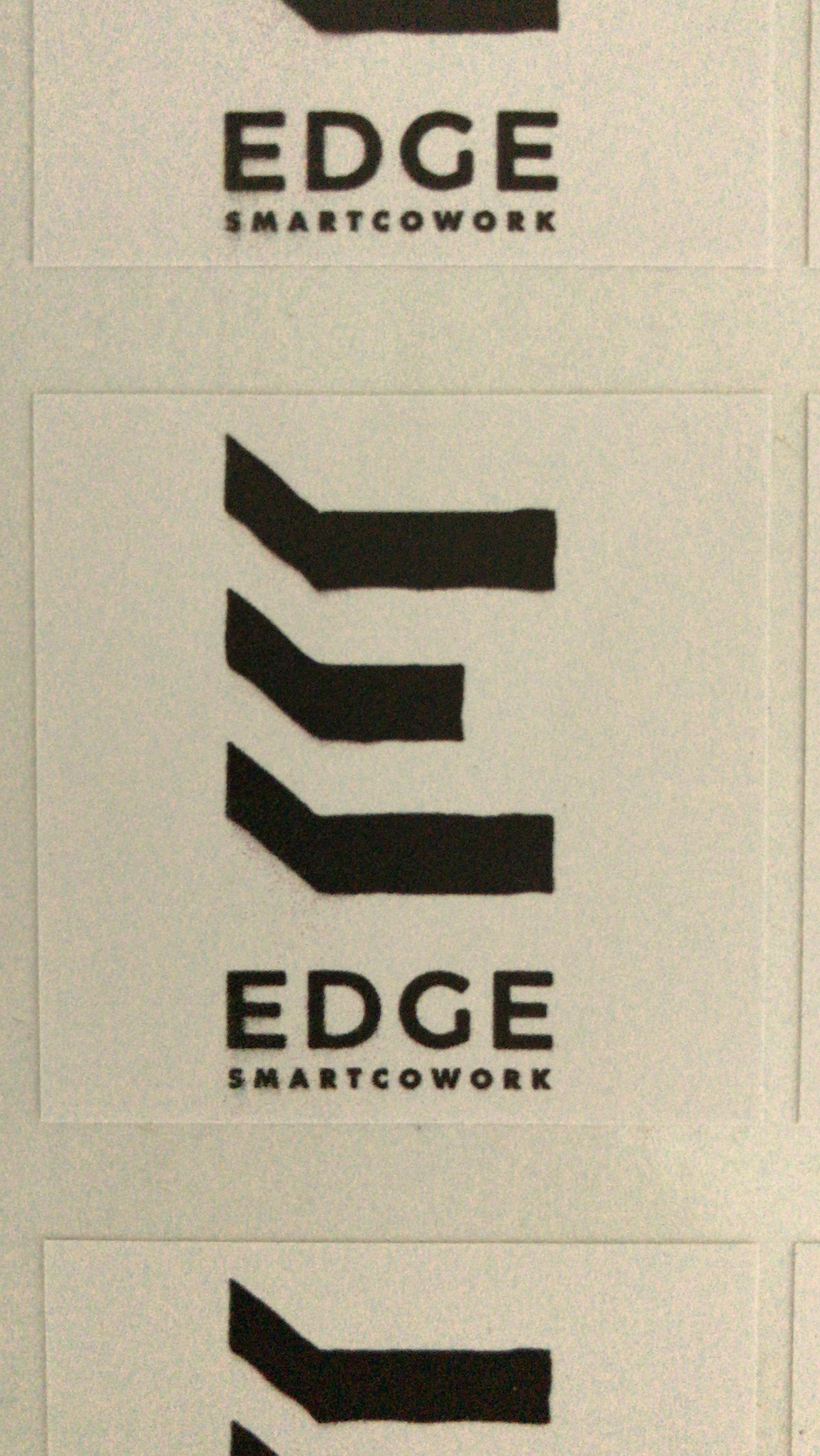

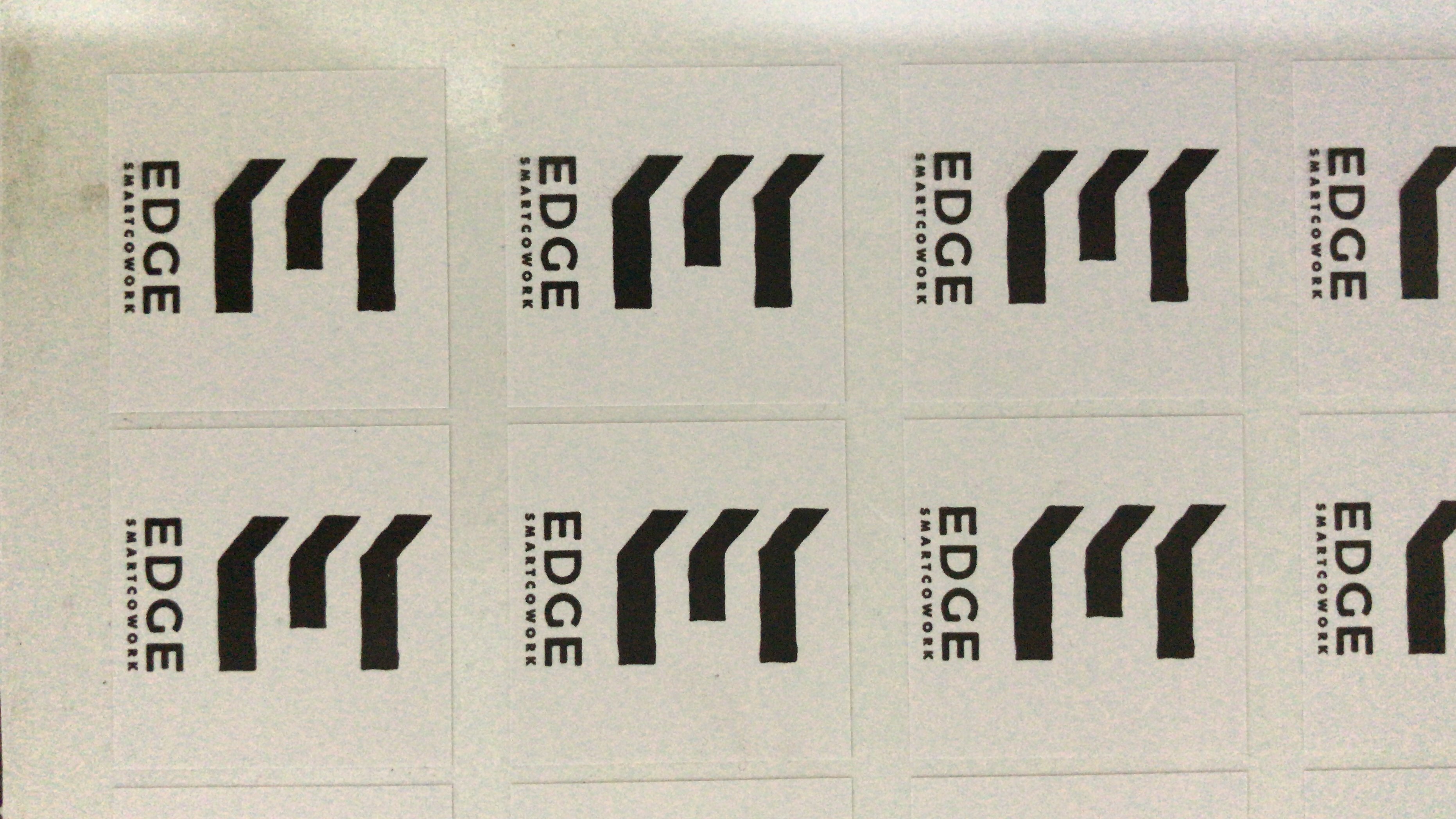

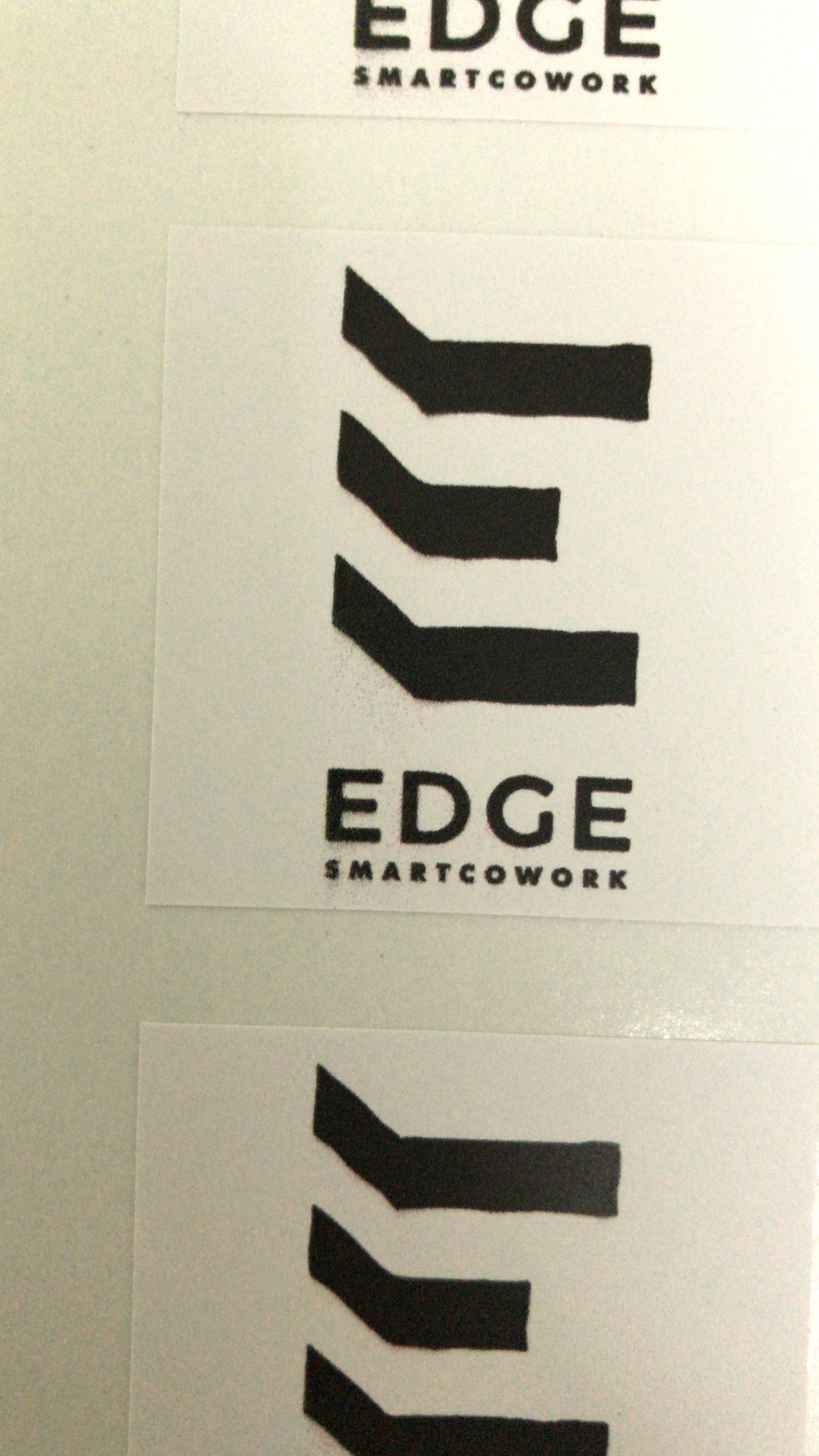

Anyways besides that, I've been having problems with prints, the last rows always come out with an error, a small little detail that makes the ink look like they had been slightly rubbed or to put it another way it is like the printheads "spray" a little ink right at the end.
I am attaching photos that show the last column and the one next to it.
This happens no matter where I am printing on the roll, always at the end of it, the last portion of the print.
So far I've mostly printed tests, labels and stickers, so it'll always show at the last column of the group. It'll happen regardless of where the printheads print the last part of the graphic, I am using 54" rolls, it won't matter if the graphic ends at 50, 40, 30, etc.
The technicians have looked into it and haven't figured it out yet, it has been over a week now, and they decided to call HP just now, so I figured I'd ask here see if anyone else has had this problem or knows a way to solve it, since it'll probably take longer than expected with the technicians.
We've tried aligning the printheads, optimizing print quality, we've tried with different materials, we've double checked that the materials are in the right position before printing (they look fine, we first thought that one side could've gotten up a little bit), the technicians adjusted temperature too and other stuff, the metal holders too.
Any input is very appreciated, thanks!

uploading photos, forgot to attach.

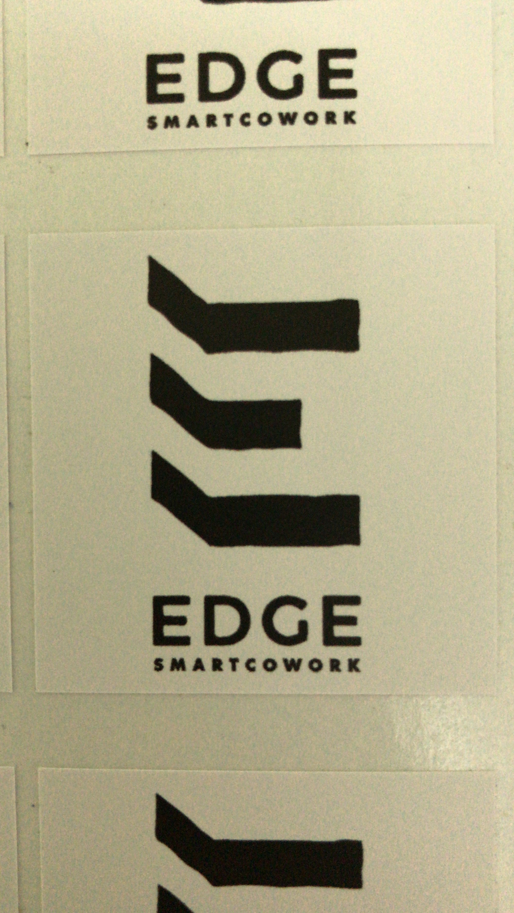

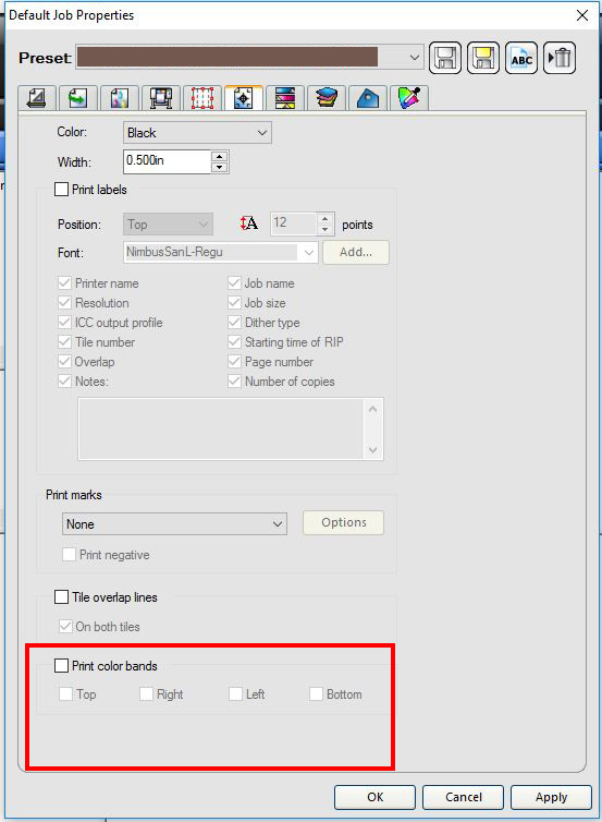

Try printing with a confidence strip / color bars at he edges of your print. Not exactly sure what Flexi's term are for those colorbars.
+1.
In SAI/ Flexi, they are called Color Bands. You can enable them on any of the four sides of the print (see attachment). They are found on the Labels Tab of the Default/ Job Properties dialog.
nico
thanks guys! really appreciate that, had no idea those existed, I am a totally new to Flexi and printing with latex in general.
That should definitely work, I think, since the errors I am getting are always at the left end of the print, will try it and let you know.
makes me wonder if issues like these are common with some large format printers? or do color bands have other uses, can't think of any right now.

I don't normally use those color bars but I do notice when I print banner trim lines where the banner print ends the trim lines beyond that are fuzzy.
ikarasu
Color bands help make sure all the heads are firing, it prevents drips from heads not being used much / prevents lines from clogging. Works great on solvent... I've never used it on my latex though.
It might fix your problem, but I'd still be curious as to why the problem is there in the beginning, as it shouldn't be. How are your nozzle tests? I sometimes get a lot of spray on the marks at the end of printing... Never really thought about it until now, since every time I print it's perfectly fine.
I'd suggest static since its winter time... but if it happens at the end only, I doubt it's that!

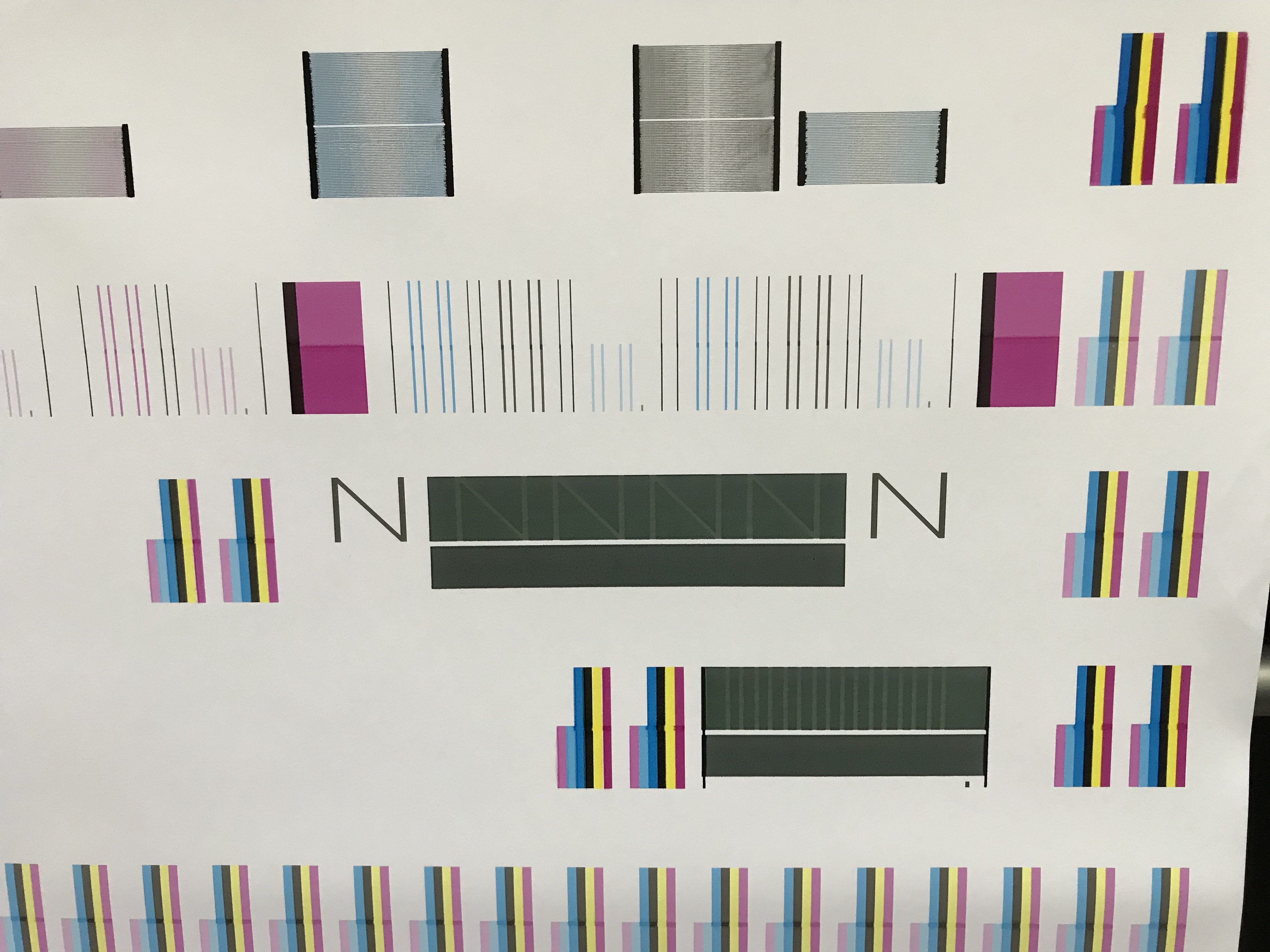

nico

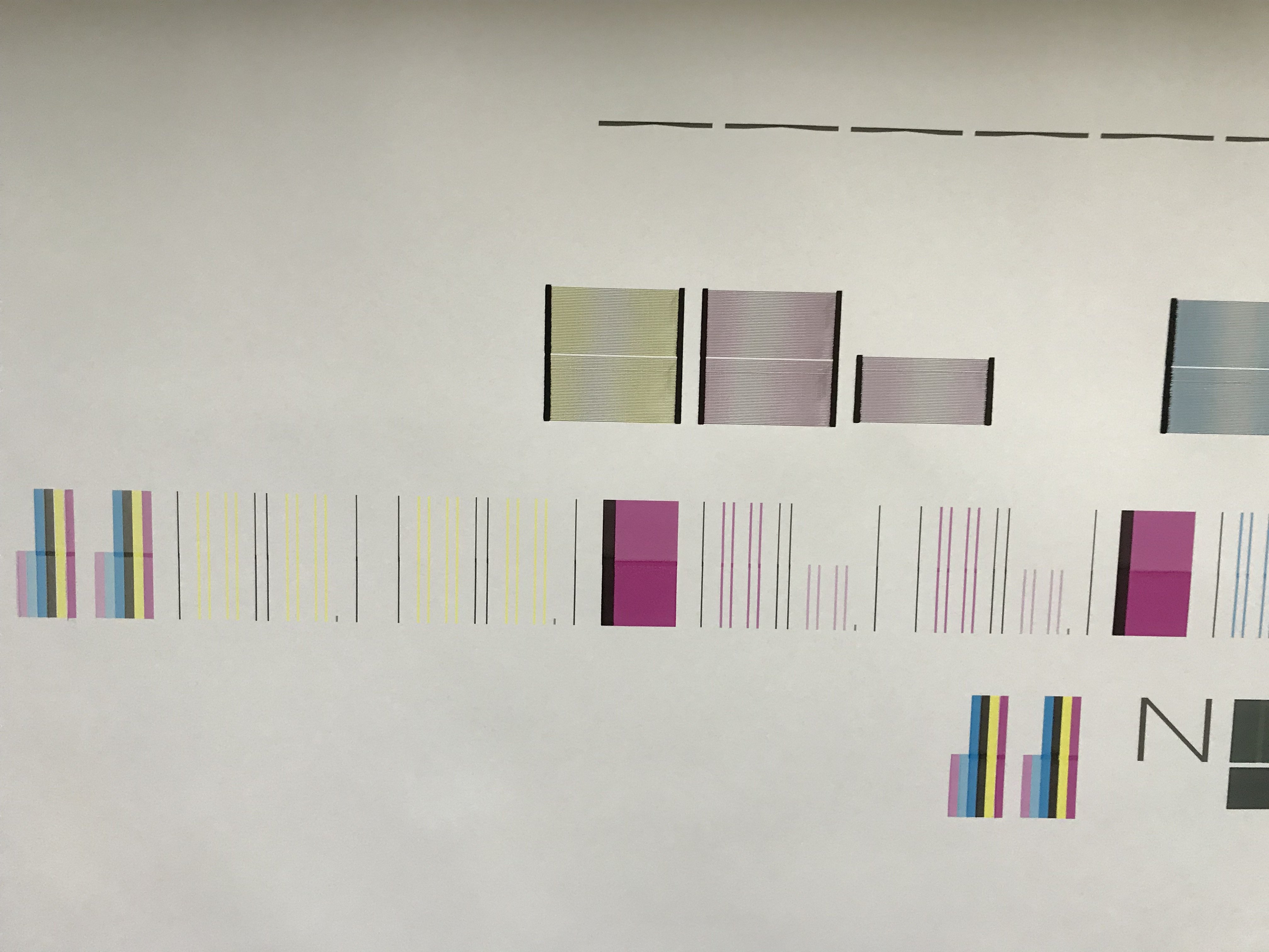

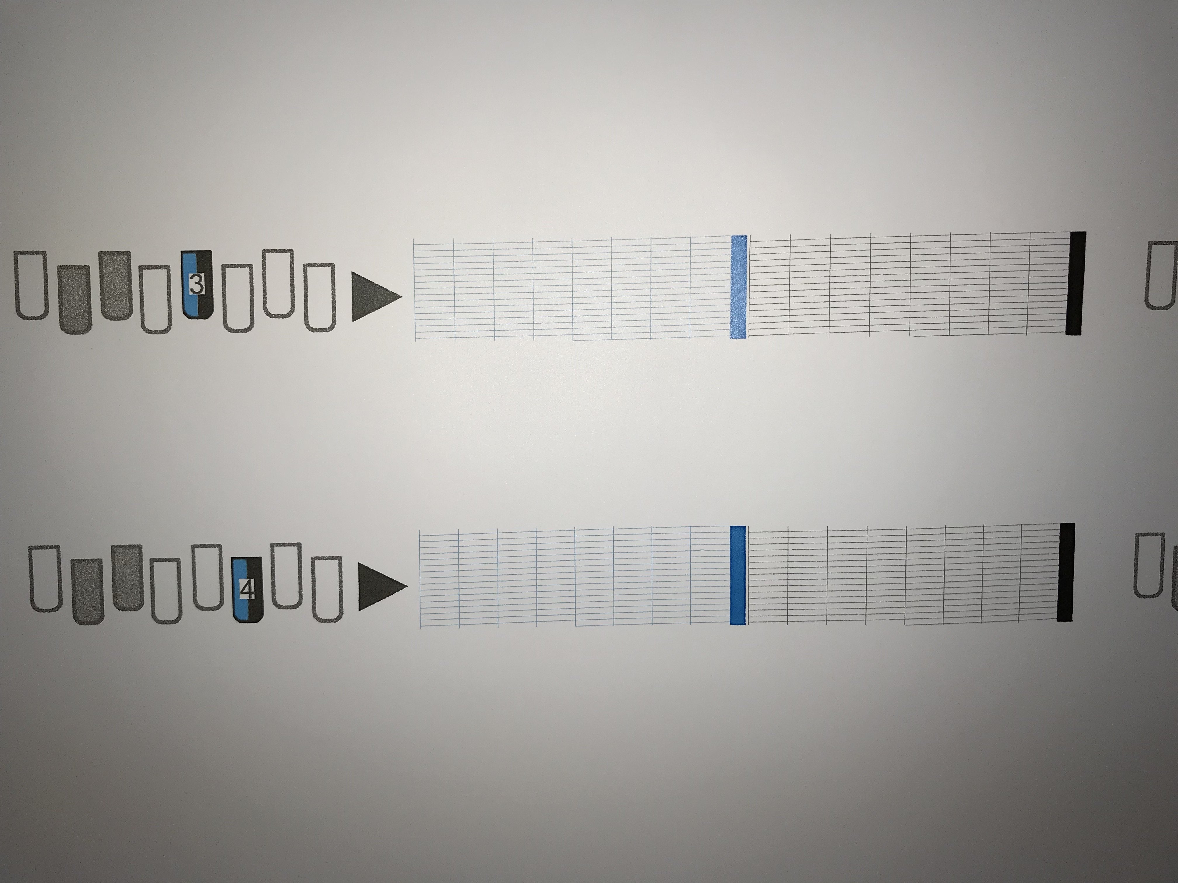

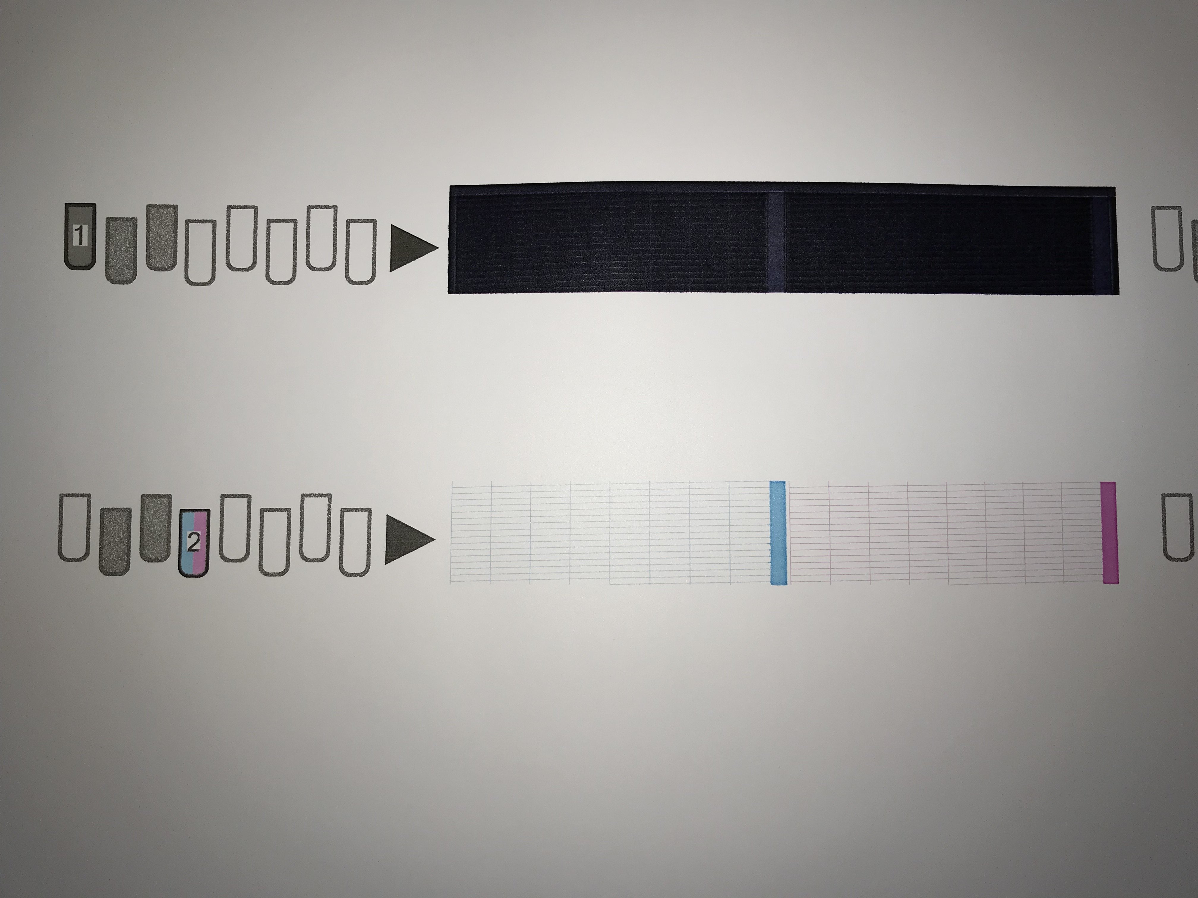

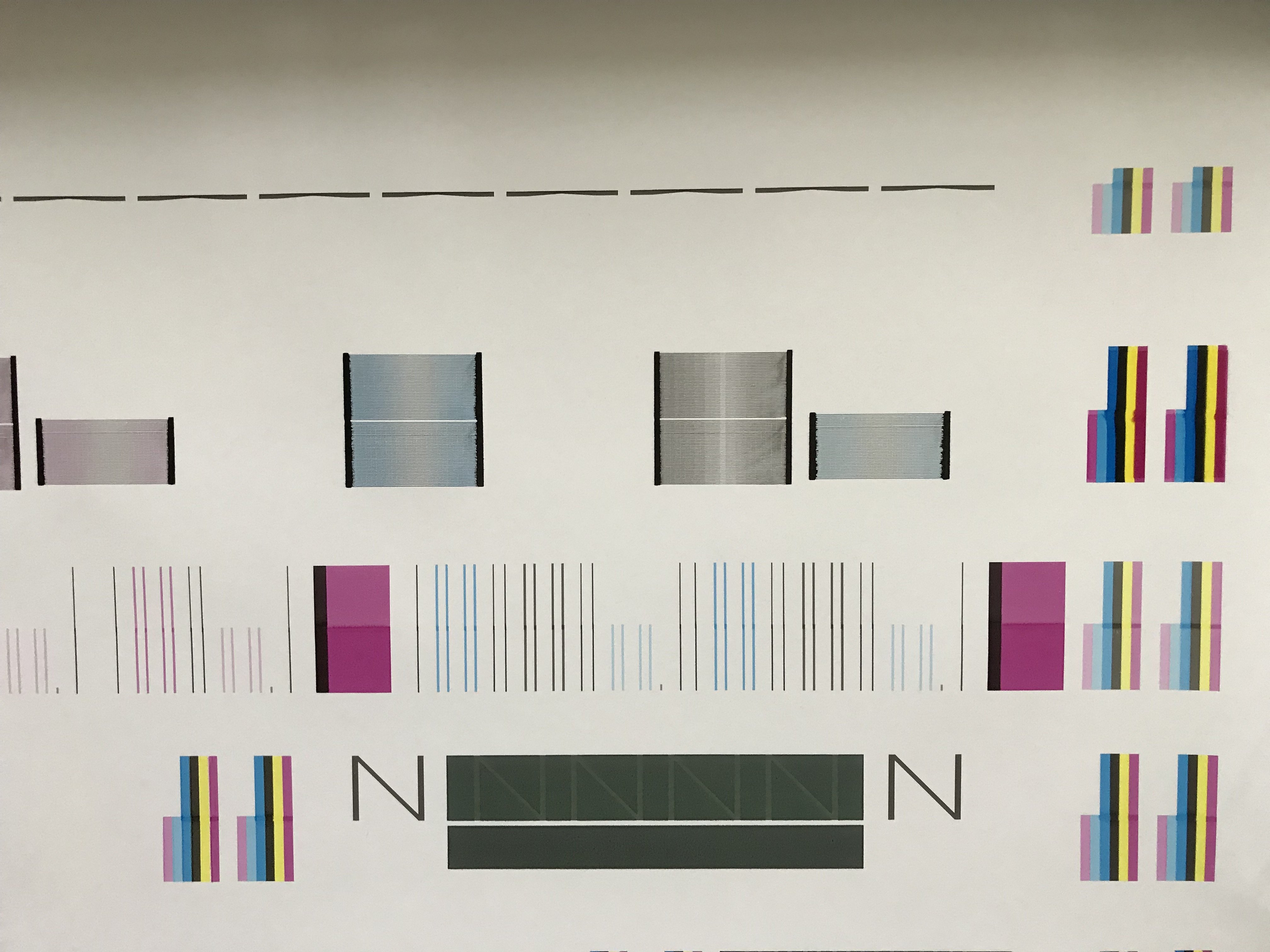

Attaching photos of printhead tests and printhead alignment prints
All input is appreciated.

What is the status of your printheads? Are they relatively new, under warranty or old? They don't look right, way too rough unless it is the media causing this. What media was used for the PH alignments?
nico
The printheads are the ones that came with the machine so should be completely new. Using cheap media though, $80 vinyl roll that the distributor sent with the machine, called Microsolv. I don't know if that's what could be causing the issue, can't find online good examples of how printheads tests should look on HP latex yet, and I am a complete newbie at this so have little idea of what to look for.

Since the printheads are under warranty I would be pushing for new printheads, through tech support, or your distributor. I would think that would be the first place to start. Possibly a red flag here "a HP Latex 110, that oddly enough has a 310 label on it but flashes the 110 firmware" maybe a rebuilt machine for some reason.

http://h10032.www1.hp.com/ctg/Manual/c04721790 Go to page 87.
Its hard to tell from the pictures... But it looks like your optomizer is too high, also looks like the heads are a bit out of alignment.
I suggest reading from page 85+ on print quality issues. I'd go through all the setup under print quality again - Remake a profile for your media, following the guide step by step. My first media our tech setup for me... I think if he didn't, I'd probably be lost / confused about setting it up. But I'd suggest running through the steps on print quality... They have images of what everything should look like, and give you very detailed step by step directions on setup.
It sucks because you're wasting a lot of ink and media in the process... But generally once it's setup, it's good to go forever. a GOOD tech would have printed a lot of samples / tests, and made sure everything was right before they left. I'm not saying your tech didn't do his job, but he shouldn't have ever left you with a printer thats not running 100% perfect out of the box.
I have no experience with microsolv... But their own manufacturer has no specs on it.
MicroSolv 4 mil Promotional Calendered Glossy Vinyl with Permanent Acrylic Adhesive 54'' x 55 yds
It sounds like one of them no name-china brands... So that could be a part of the problem. Though your prints look fine in most places. I'd try changing the optomizer levels... Too much optomizer can make it bleed/fuzzy like that.
