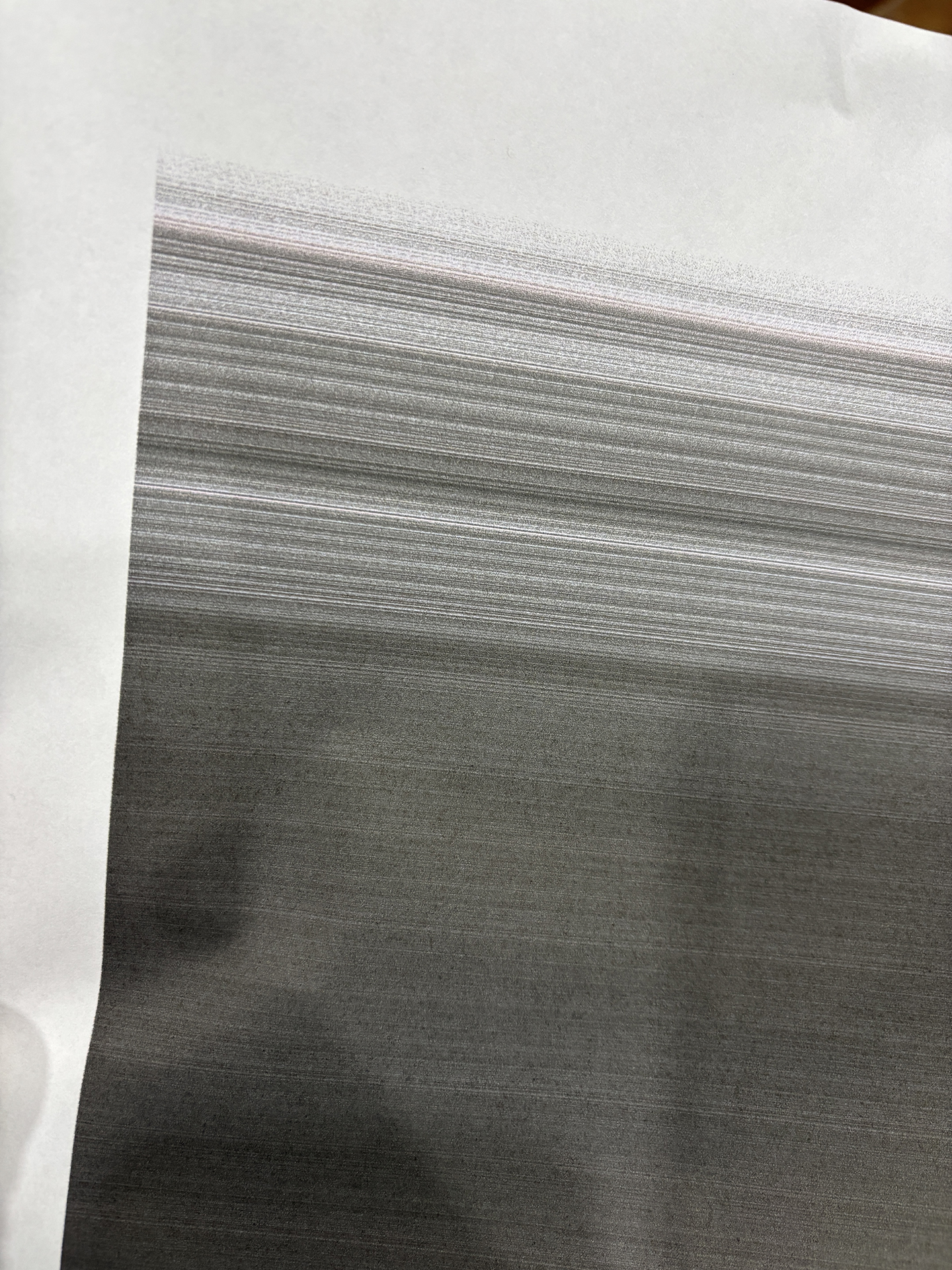

I am getting alot of horizontal banding issues. I replaced all print heads and the issue cleared up but only for one day the next morning the issue is back. I can pull the head and give a few good wipes and it clears up pretty good but not like I think it should be.
Attached is a droplet check after one week on the new printheads (K is the main issue in printing). The nozzles out seem too high for 1 week of printing. Could there be an ink feed issue possibly?

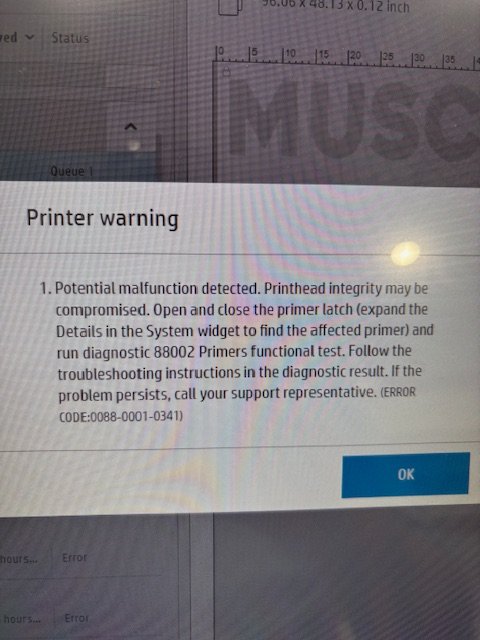

After doing the reset and immediately doing the detection there are 0 nozzles out on any of the heads and the print looks great but after the print I get this primer error. Run the diag 88002 and all pass.

I can check this but Im pretty positive you don't have to worry about that. It's complaining about the OC PH primer but new printers won't even have the primer. If you are on newest firmware you can just leave or disconnect the primer.
However check that the OC latch is completely closed.
Anyway it would mean that you have a problem with the drop detector.
Don't look at the results after resetting the database because it will show 0 for everything until the machine has done 3 succesfull detections.
That's why it's best to print out the real nozzle check from the hard cleaning menu and you will know how your printheads perform for real.

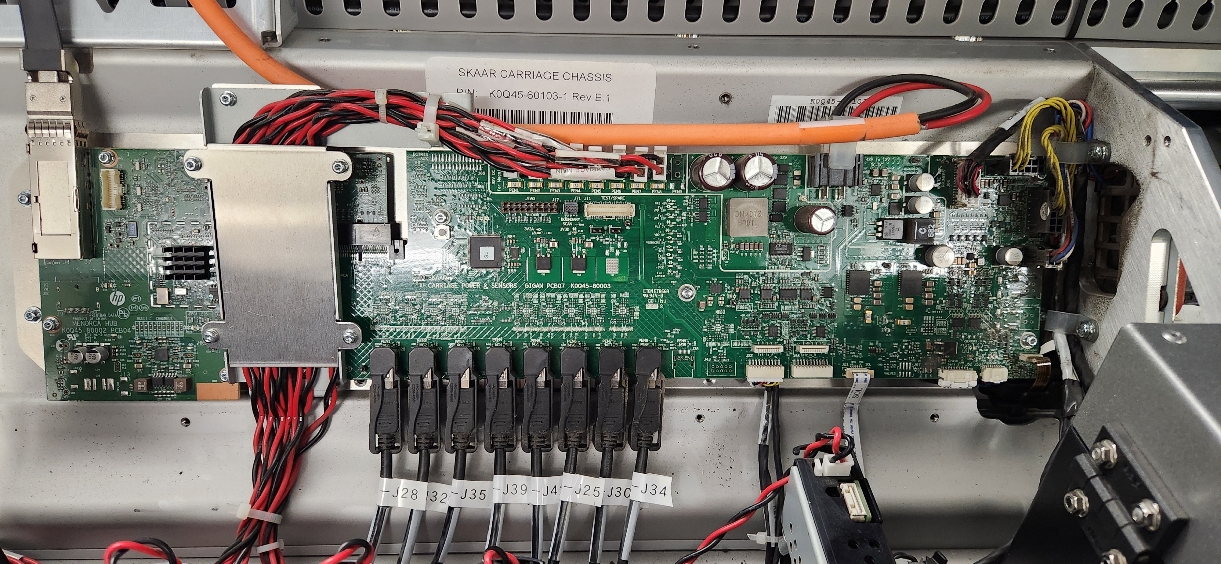

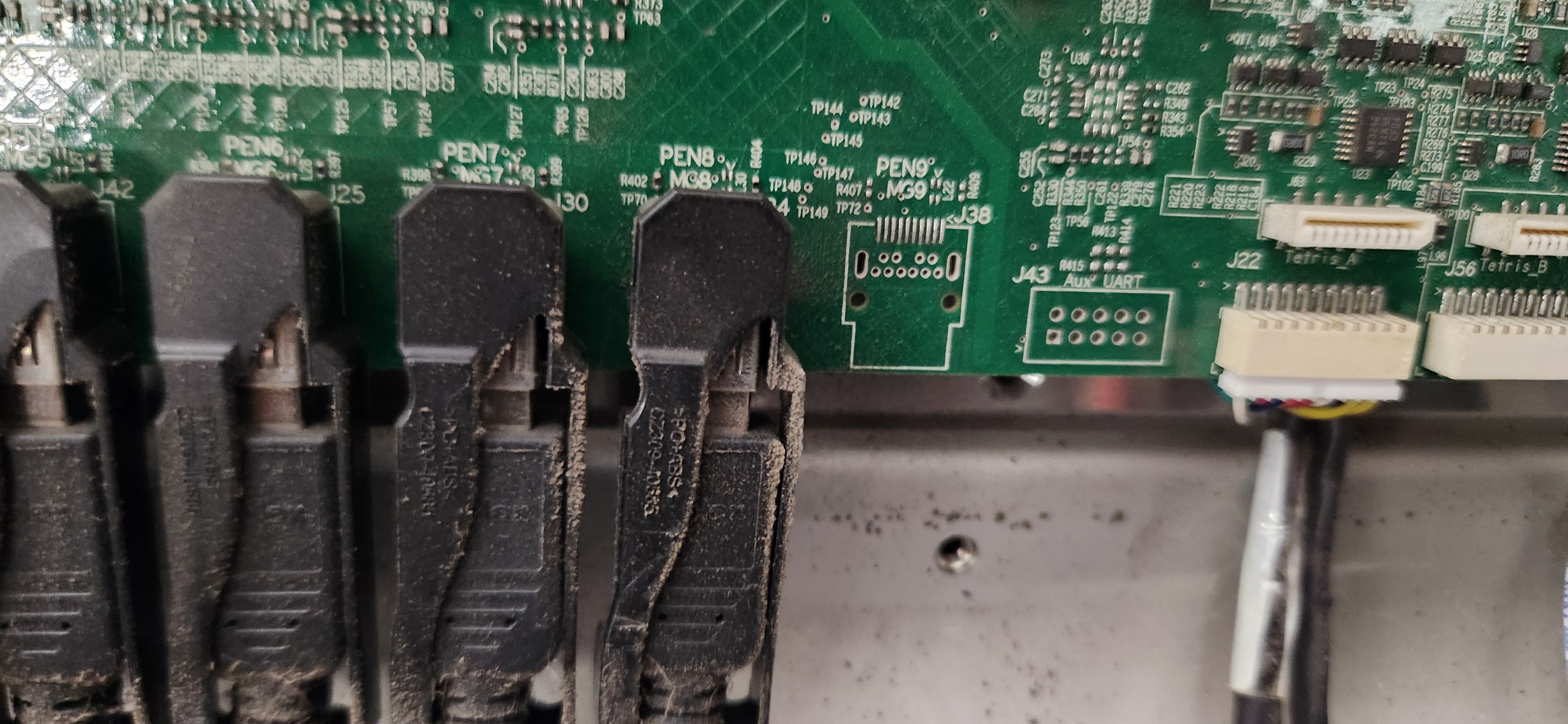

Check the cables and the female connectors at the main board. Our printer had poor connection and bad cables causing intermittent issues, we thought it was due to bad cleaning or defective printheads. new cables solved it.
