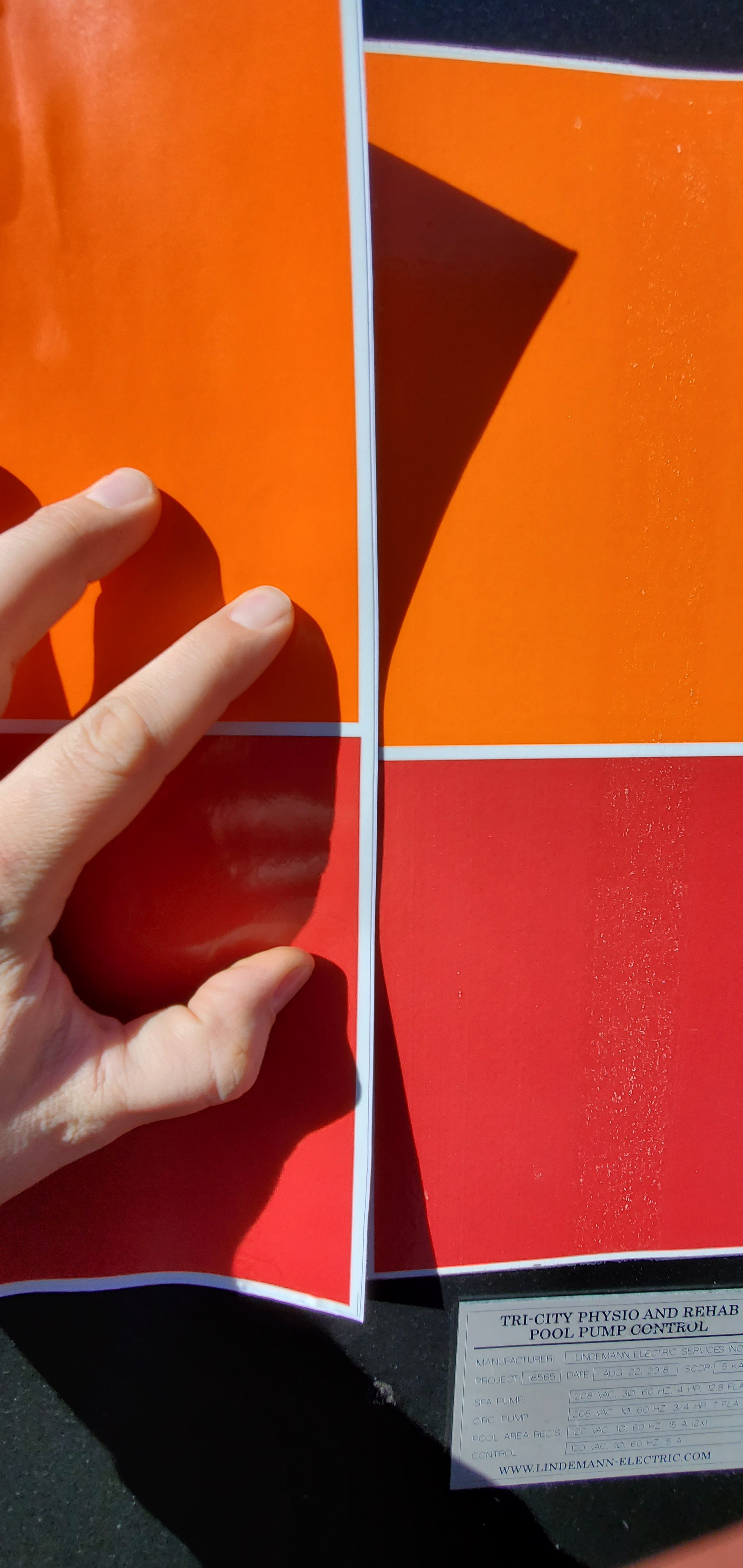

Your post reminded me, I printed out an orange and red swatch almost 3 years ago and stuck it on the back fire exit door outside to test the longevity of the orange and red ink in our S80600 because I had heard similar stories. The swatch I'm holding was printed at the same time and shoved in my desk drawer, so no UV exposure. the colours are pretty much identical. My back door faces south so it gets a ton of sun.

Looks good. We bought an s40 because of all the stories we heard about the ink in the s80 sucking.... Regretting it now! S80 would be worth it. Oh well, next upgrade well get one!
Thanks for the sample.

Really appreciate you posting this. Thank you!

Is that Laminated?
