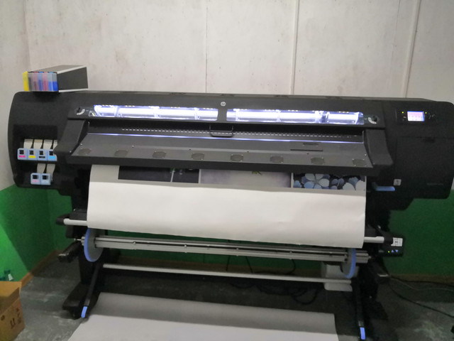

Here is another latex 315 of mine now equipped with the bulk ink system, recently refurbished and converted.
Thanks to lockdown I had enough time to "sharpen" the technology.
V. V.
Inkjet printing guru
Please post more picture. Are you pressurizing your bulk tanks?
Using originals as passthrough?
Ink brand?

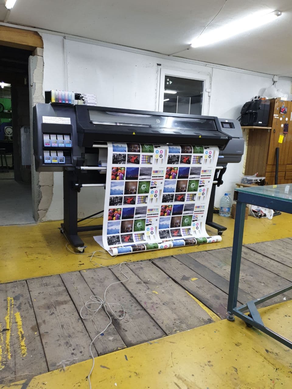

One more picture? Here you go, mine 26500 with the same system built in.

What's the point of just showing it off?
What's the ink? Where to get the system?
The point to show off is that I developed the whole solution just myself in house.
I didn't think about commercialization but theoretically you can get the system from me directly.

I'd be curious to know a bit more about your process, as well. Probably not something we'd have the time/skill/patience to rig up, but I like knowing how people solve things creatively. Are the inks pressurized? How do the chips on the cartridges play into this?

Right. He just put an old rig from solvent printer on top to take a picture
Not really :))
Yes, they are.
There are two ways. 1st you can bypass the chip system but you'll have keep an eye on the ink level in the bulk system.
Second - I did make a chip resetter so I can reset the OEM chip. So for now I think about to dismount the bulk system and just refill the genuine cartridges and reset chips once they are empty.
