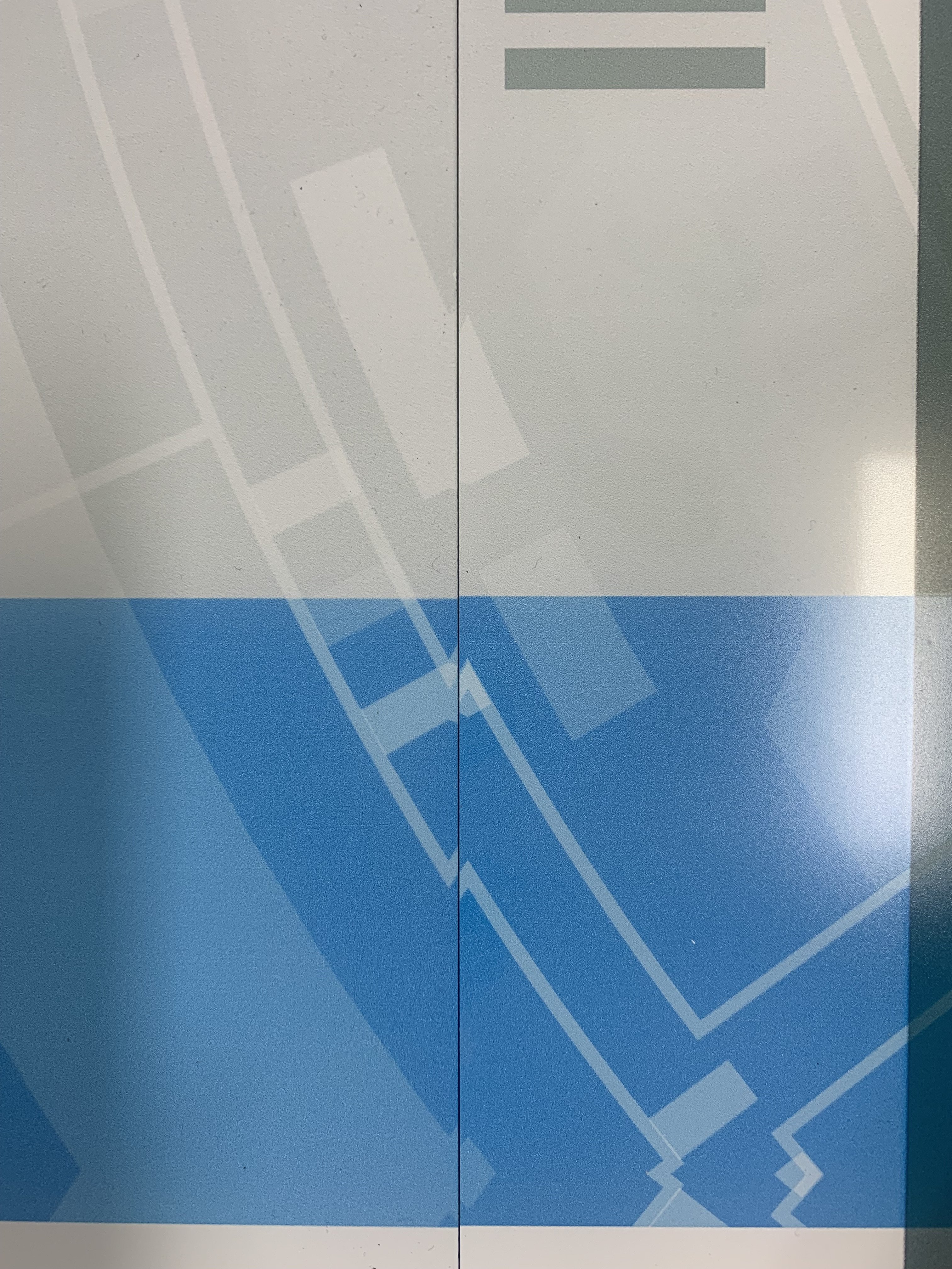

My machine is almost 3 years old and I have all the HP Tech looking at my machine and set it up but still I have more than 2 mm different on 2.4 metre long ACM panel. Please have a look at the attached file. Thank you.
So this is the long joint along the two boards of 2070x3040?
To me it looks like the positioning of the file on board is wrong. Bleed is printing on the board not outside of it.
