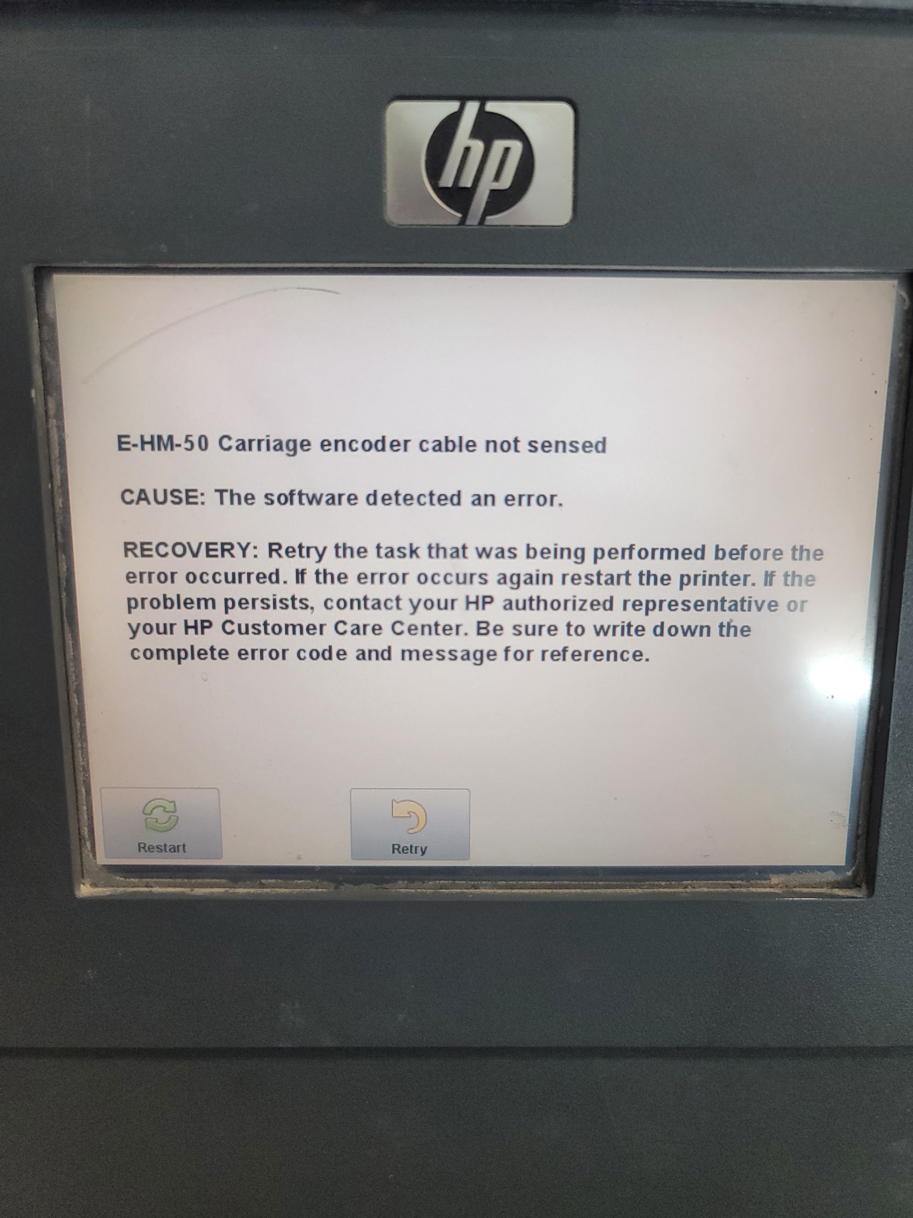

Like and error code
E-HM-50 Carriage encoder cable not sensed

Like and error code

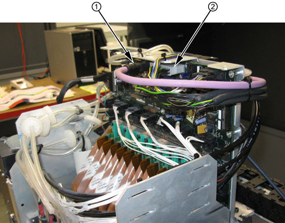

Caution: Power off the printer before reseating the data cable. Failure to turn the printer off before reseating the data cable may cause severe hardware damage and require service to repair the printer.
Check these cables

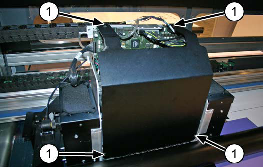

You may need to remove the carriage cover.
If so, just remove these 4 screws.
Make sure those cables are in place and secure/seated properly.

Like and error code
