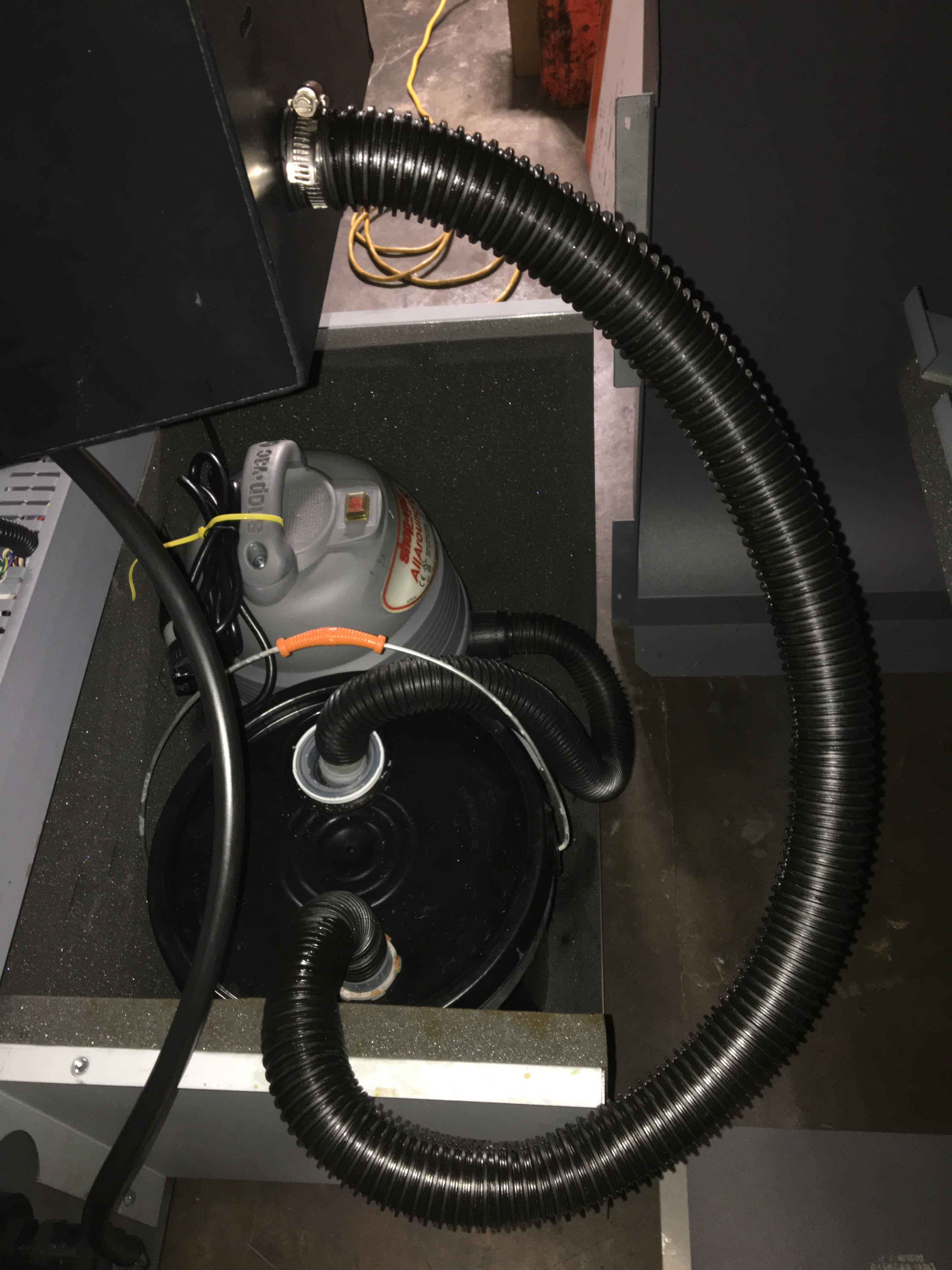

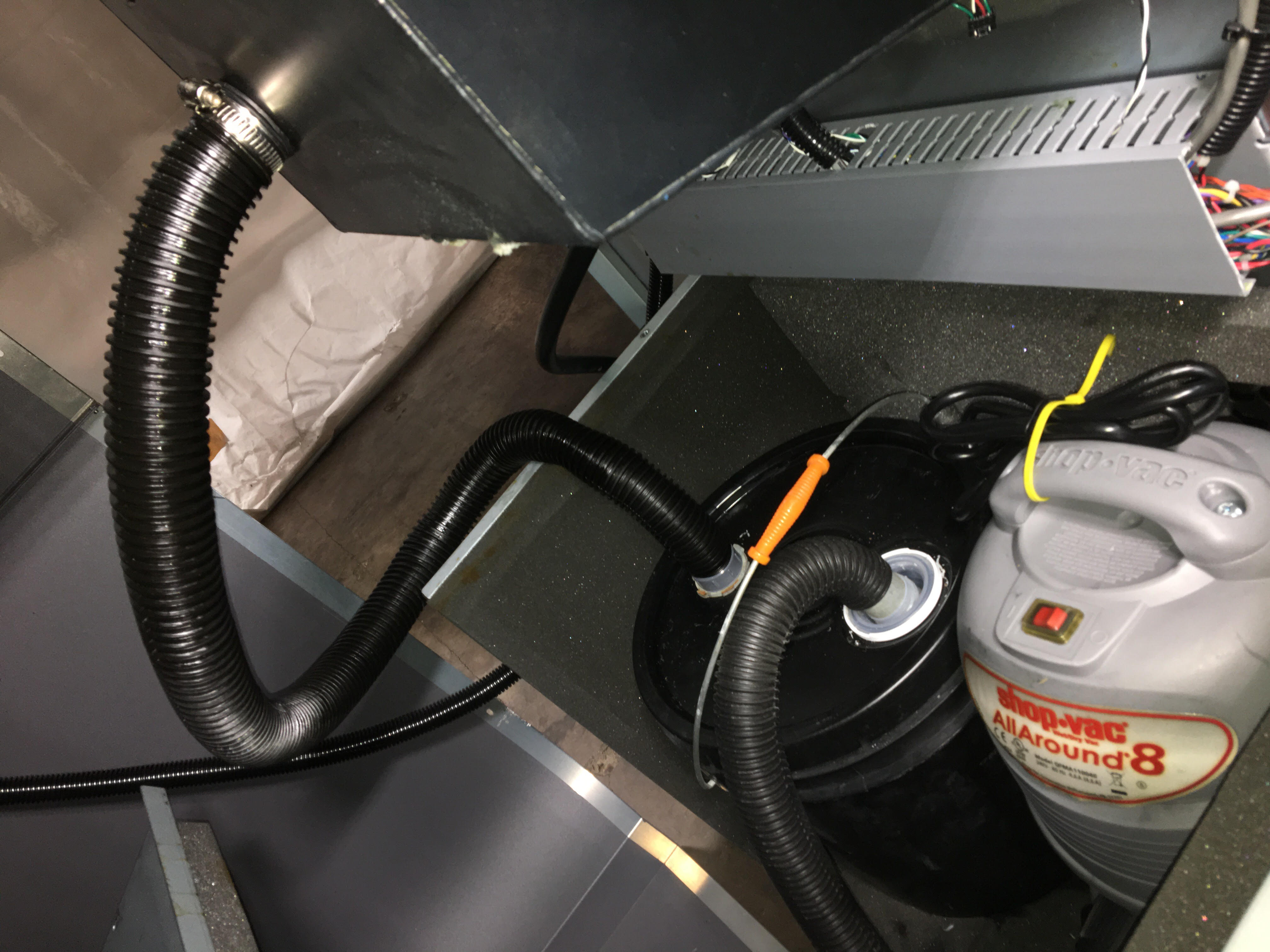

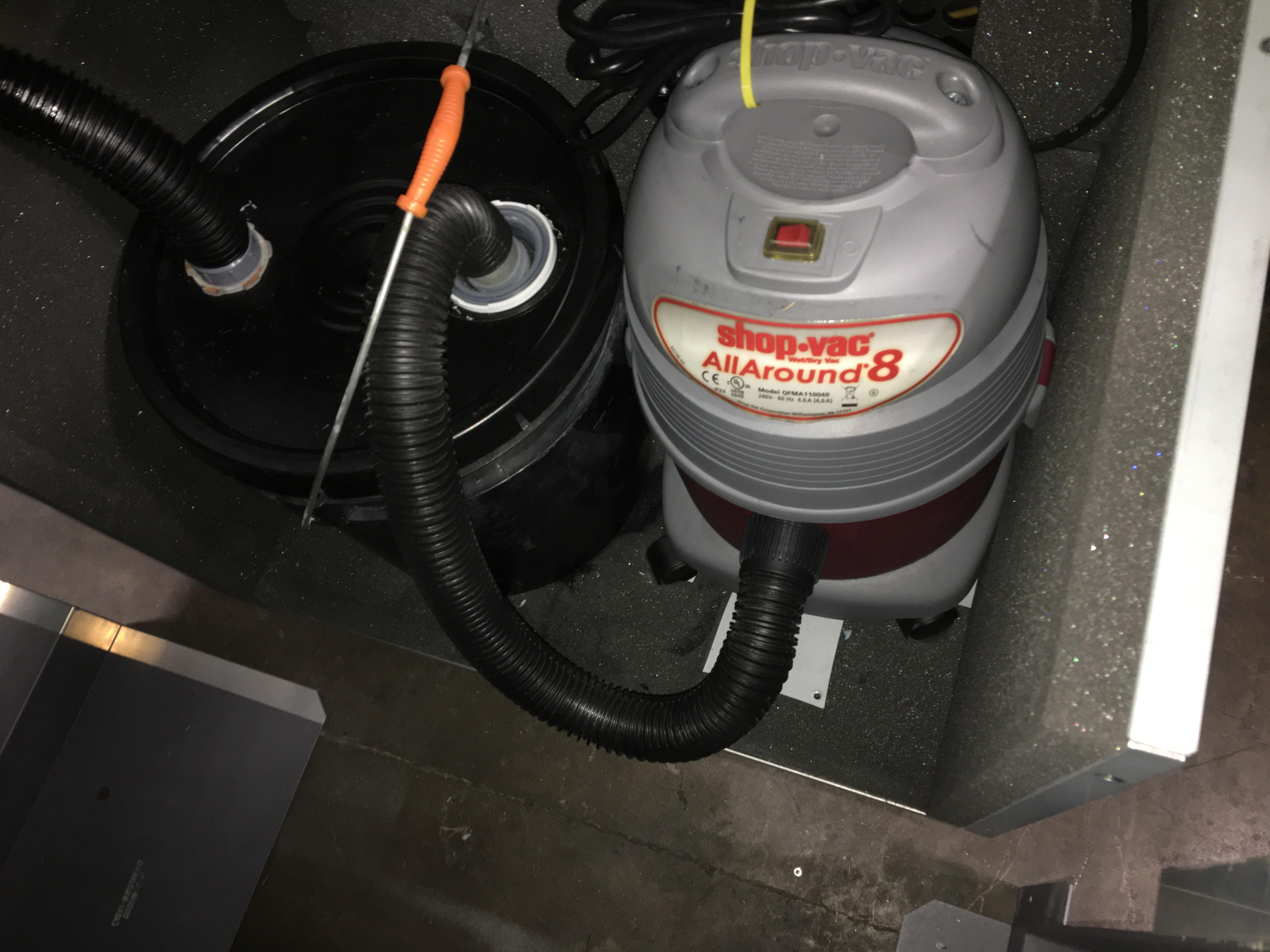

Also like to post a solution for the ink Vacuum, Since it burns when inks goes to the motor, or clean this vac every 6 months..... Here is the fix.
** just need to Add a longer tube inside the first bucket making sure inks flows down.
avoiding ink fly to the vac port to the Vac pump.
Good luck all....

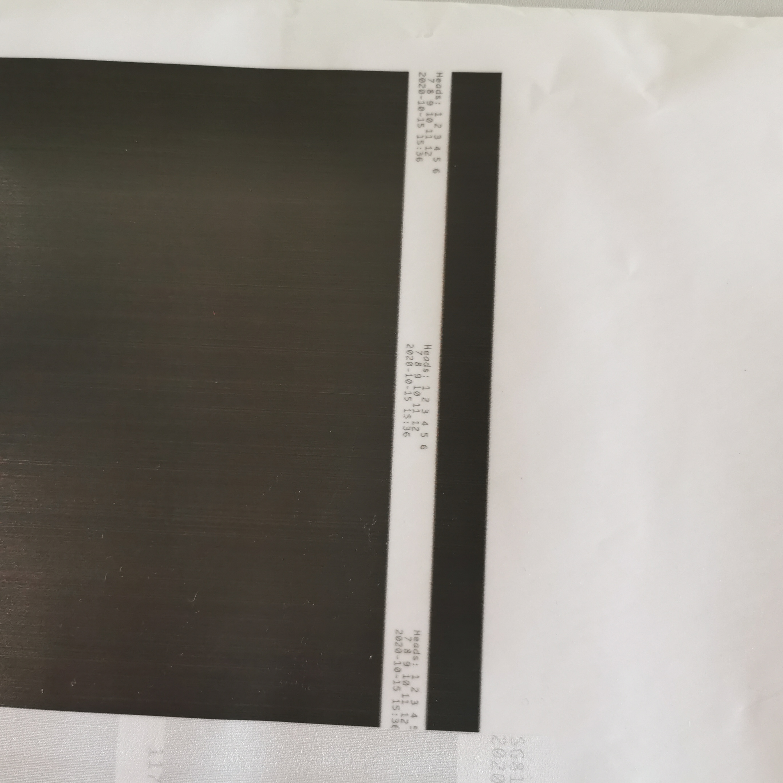

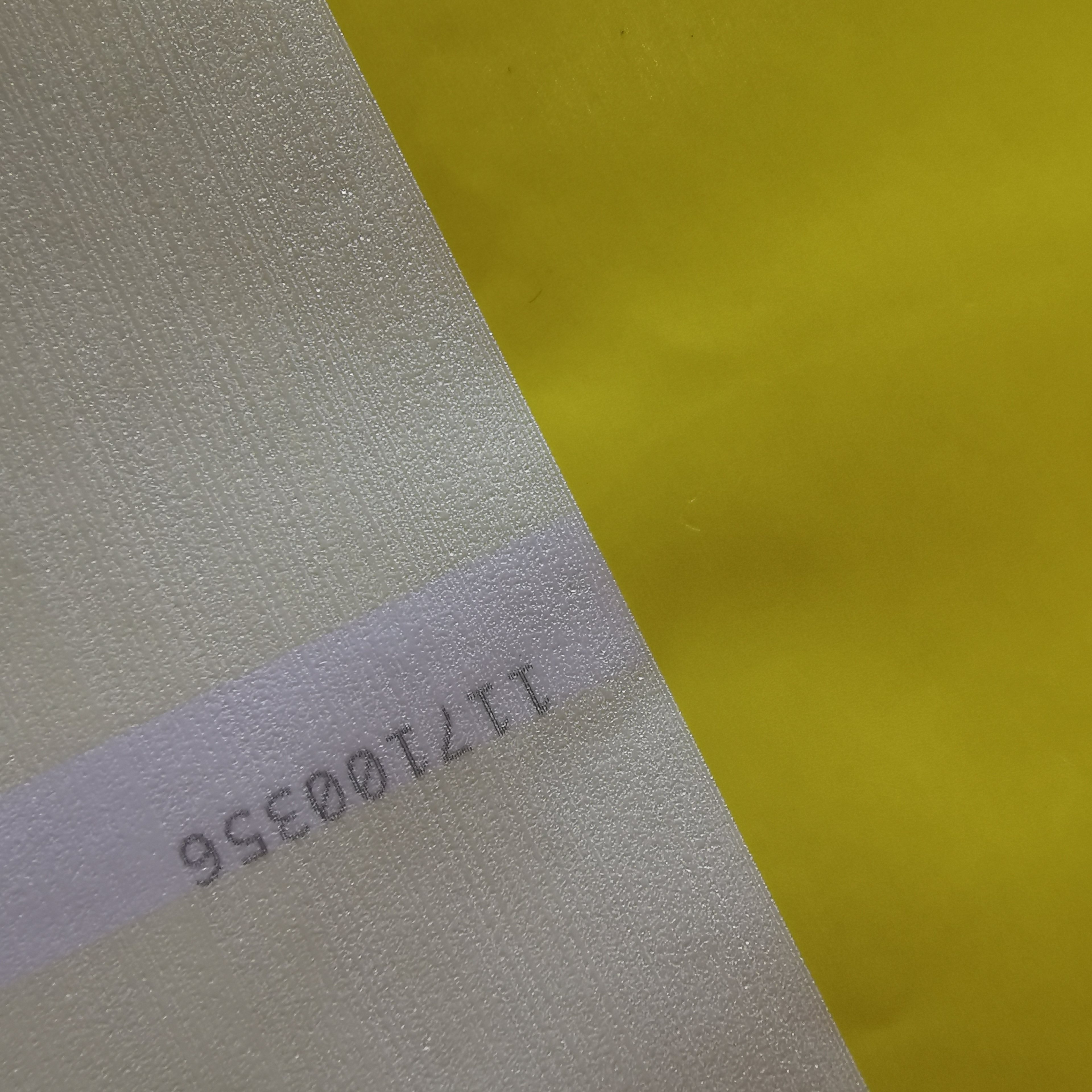

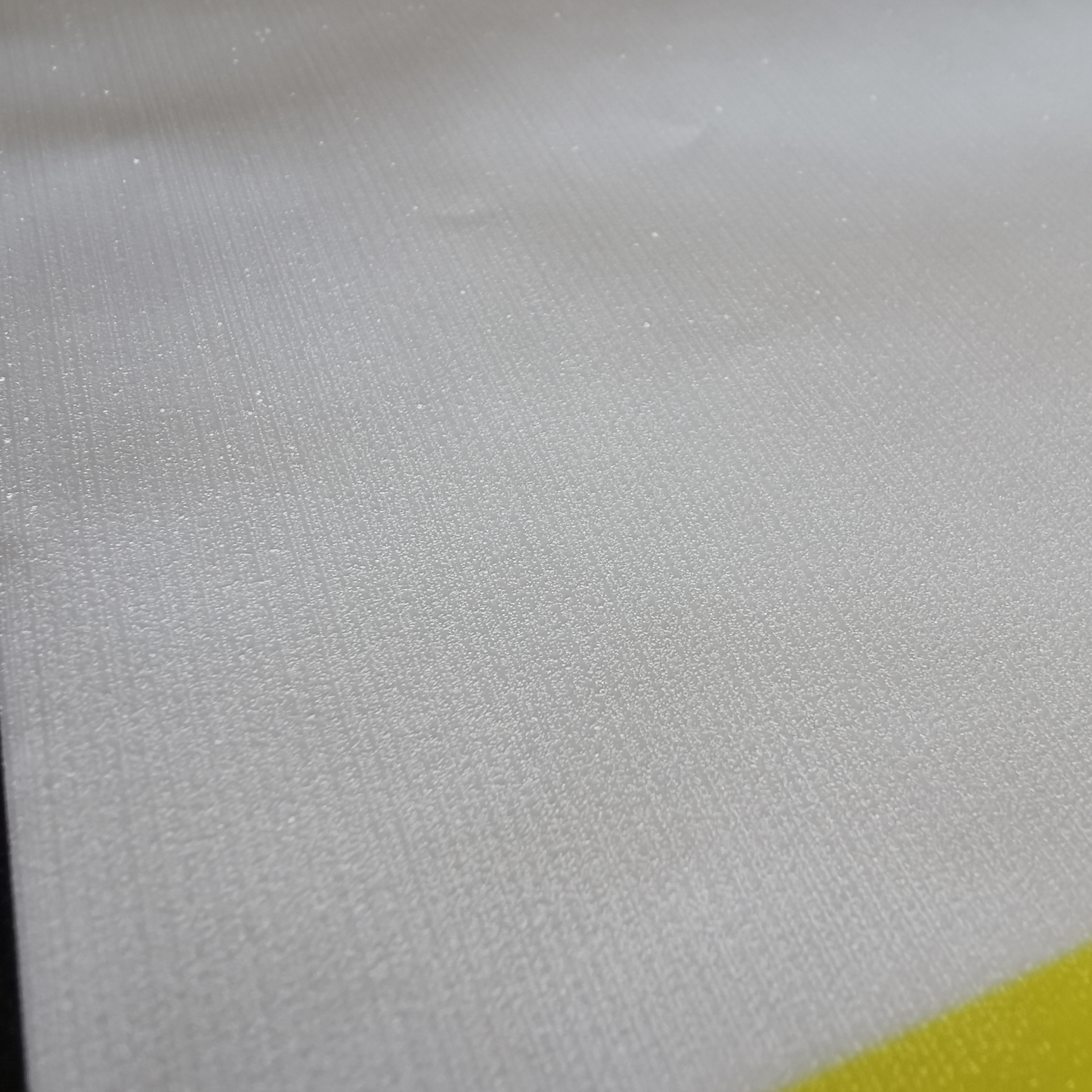

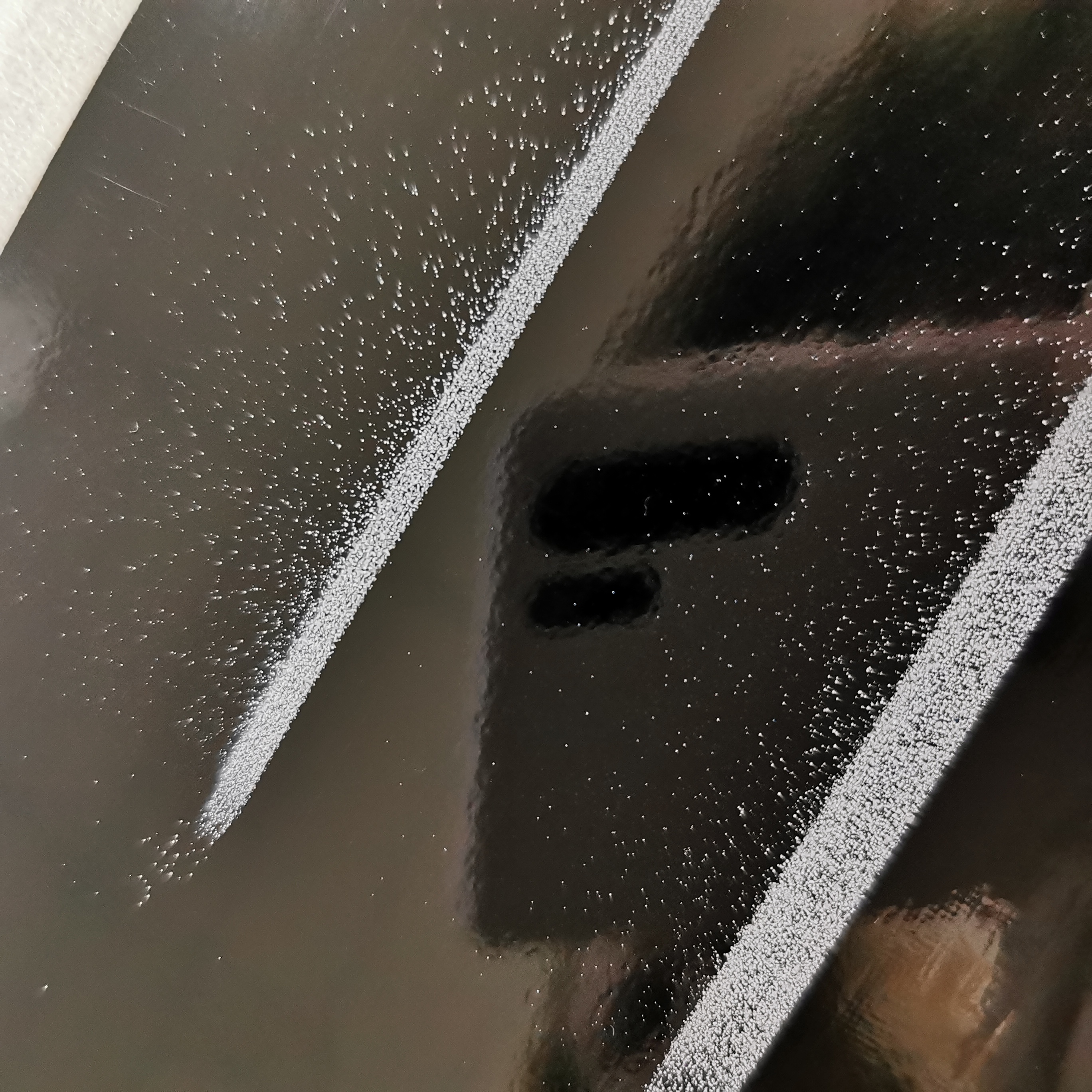

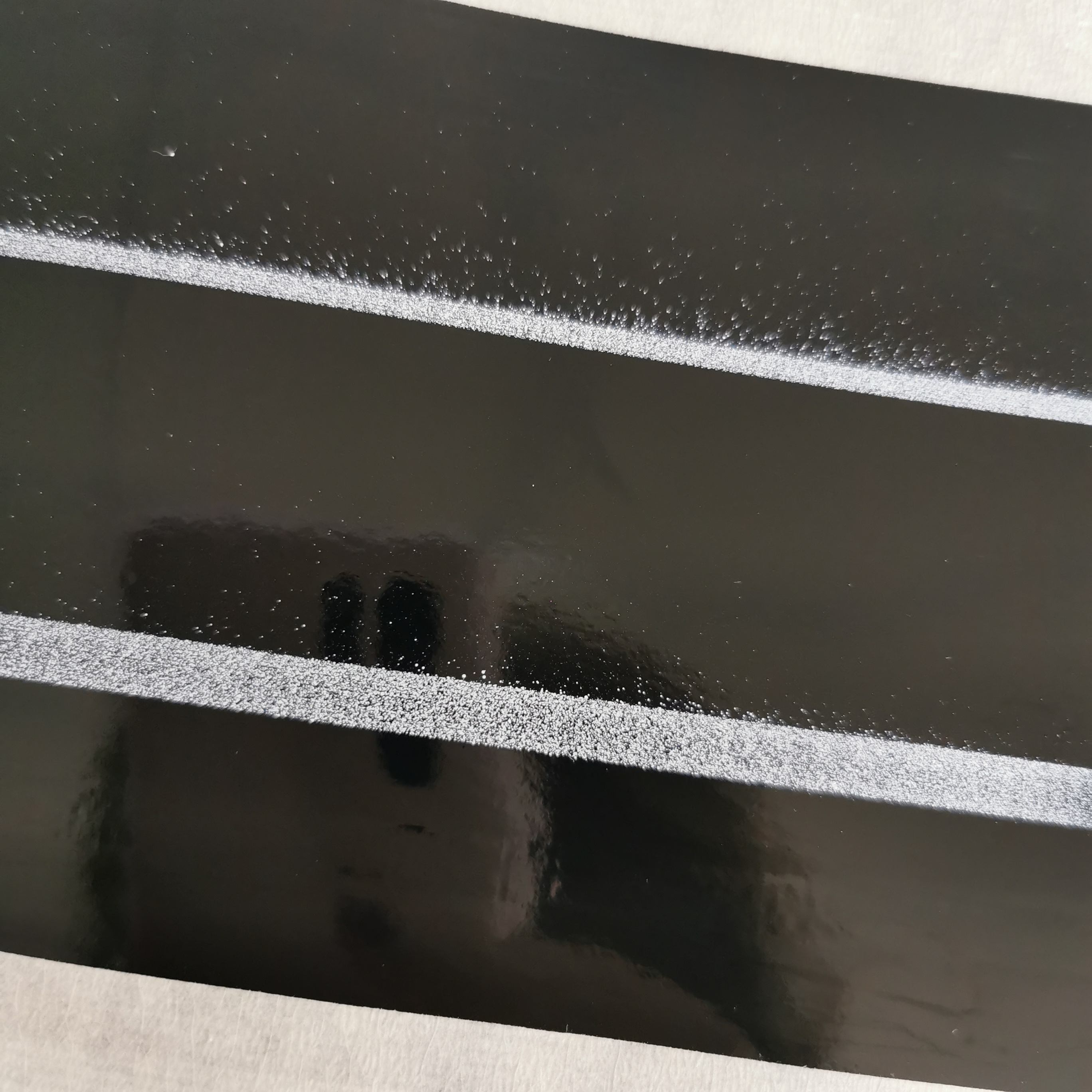

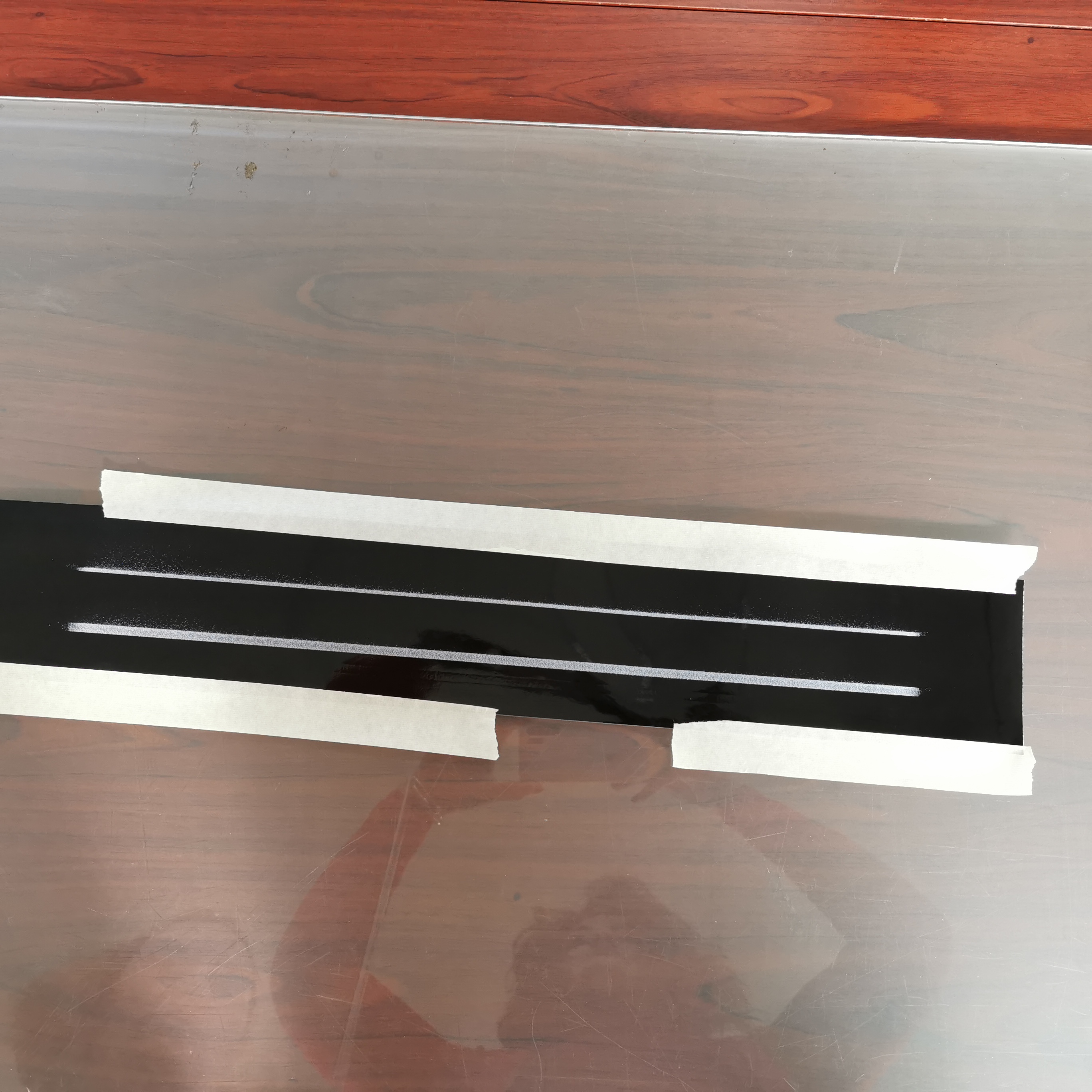

I have the same issue with white ink, when i make the injectors health recovery it gets better but after a while it clogs again. I never had this problem and this happened after changing the ink box. Anyone with the same problem? The techs say that the problem is the head because no one reported this problem before. I am now about 1 month without printing whites because of this. white ink almost gone in cleanings and losing a lot of money.

I have the same issue with white ink, when i make the injectors health recovery it gets better but after a while it clogs again. I never had this problem and this happened after changing the ink box. Anyone with the same problem? The techs say that the problem is the head because no one reported this problem before. I am now about 1 month without printing whites because of this. white ink almost gone in cleanings and losing a lot of money. View attachment 149701 View attachment 149702 View attachment 149701 View attachment 149702 View attachment 149703 View attachment 149707 View attachment 149706
I would suspect the head as well.
balstestrat
Problem Solver
Is there any way to confirm this without replacing the head?
Well if you have already almost used the new white cartridge that you replaced you should have circulated enough ink to cancel ink issues out.
I don't really see any other option than trying with another white cartridge and emptying and filling that in couple times (there hasn't been any issues with white by HP) and then ultimately replacing the printhead.
Let's see what others say but I hardly doubt there is any other viable solution if you have done everything correctly.
CORKONBAG
I'm trying to get a new ink box but from a different lot because this one i have now is from the same lot that the one that was replaced because of problems.
I'll keep posted.
Thanks
