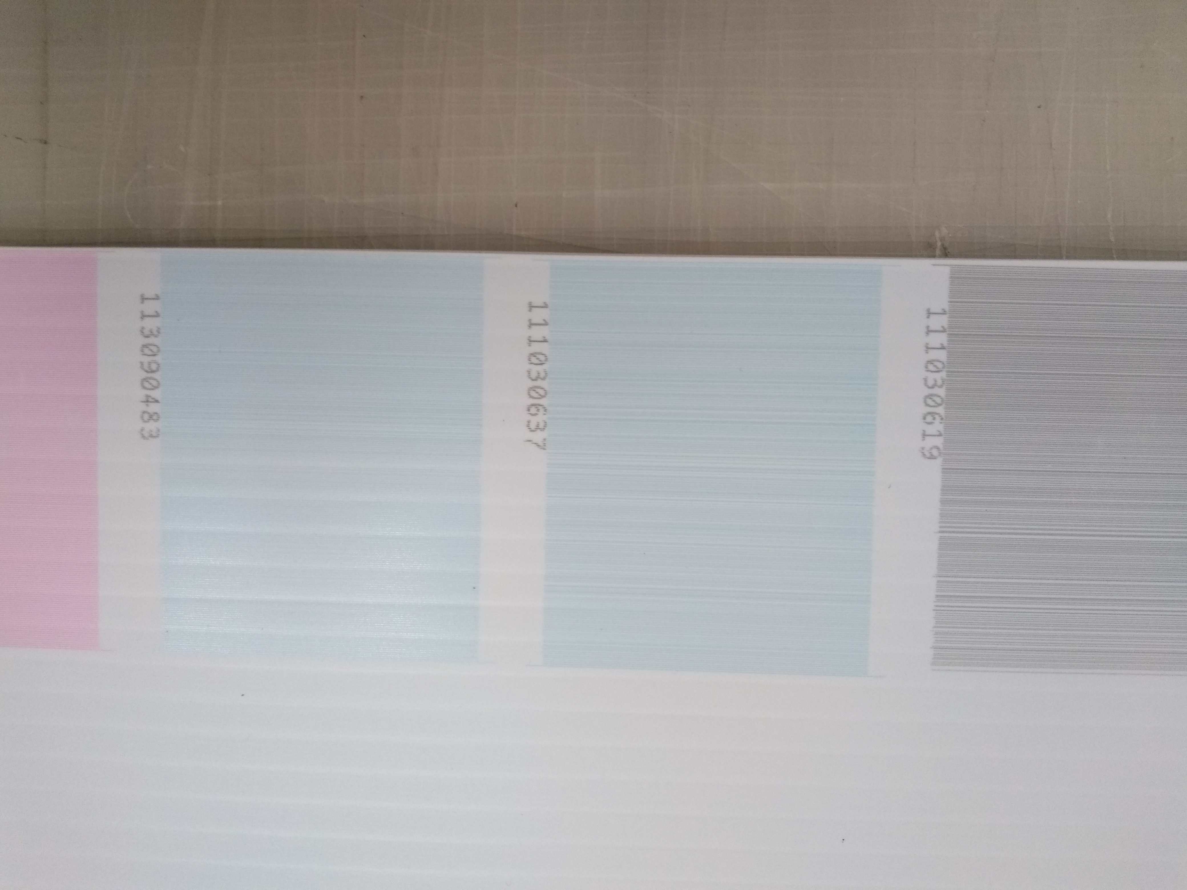

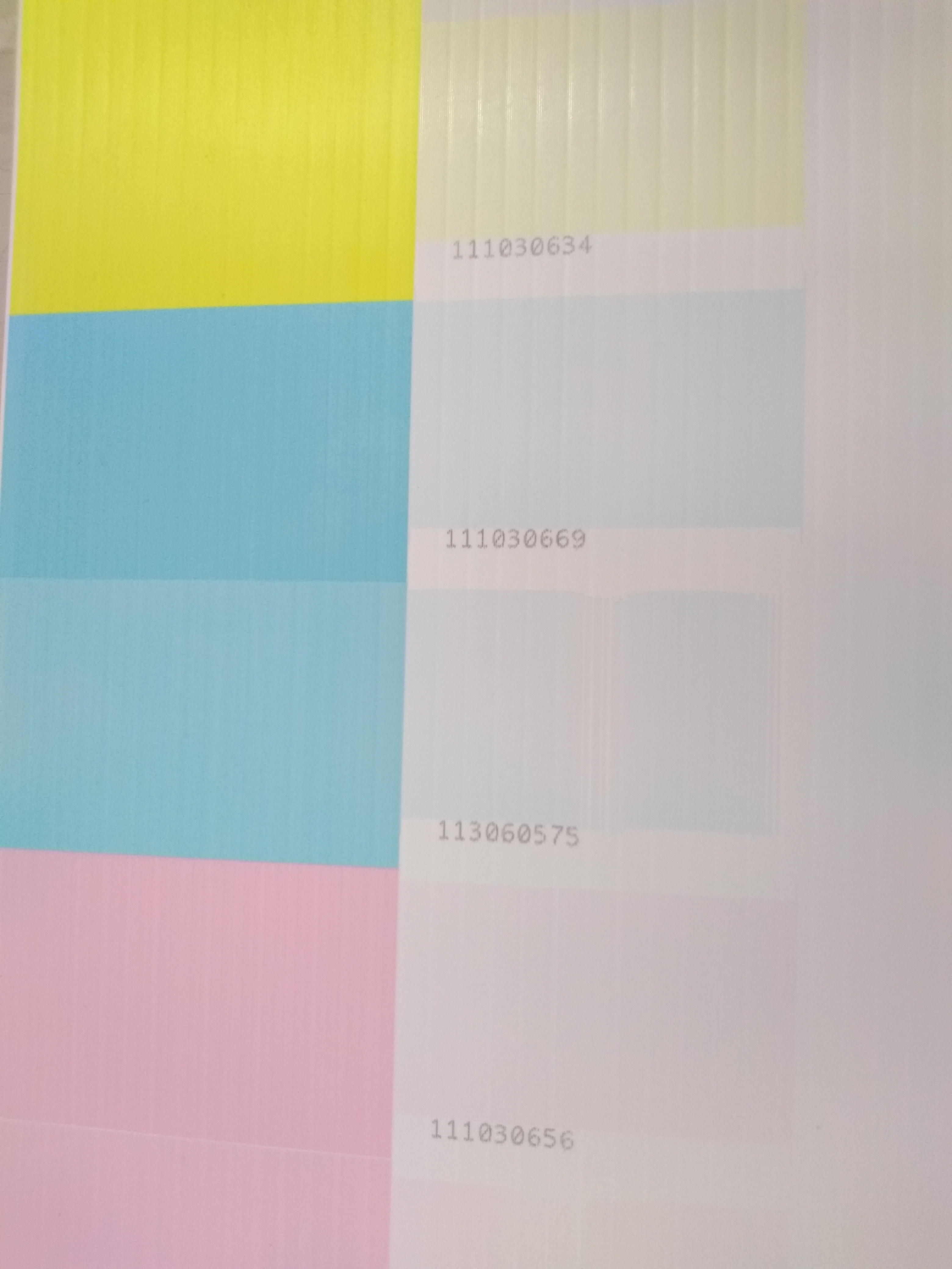

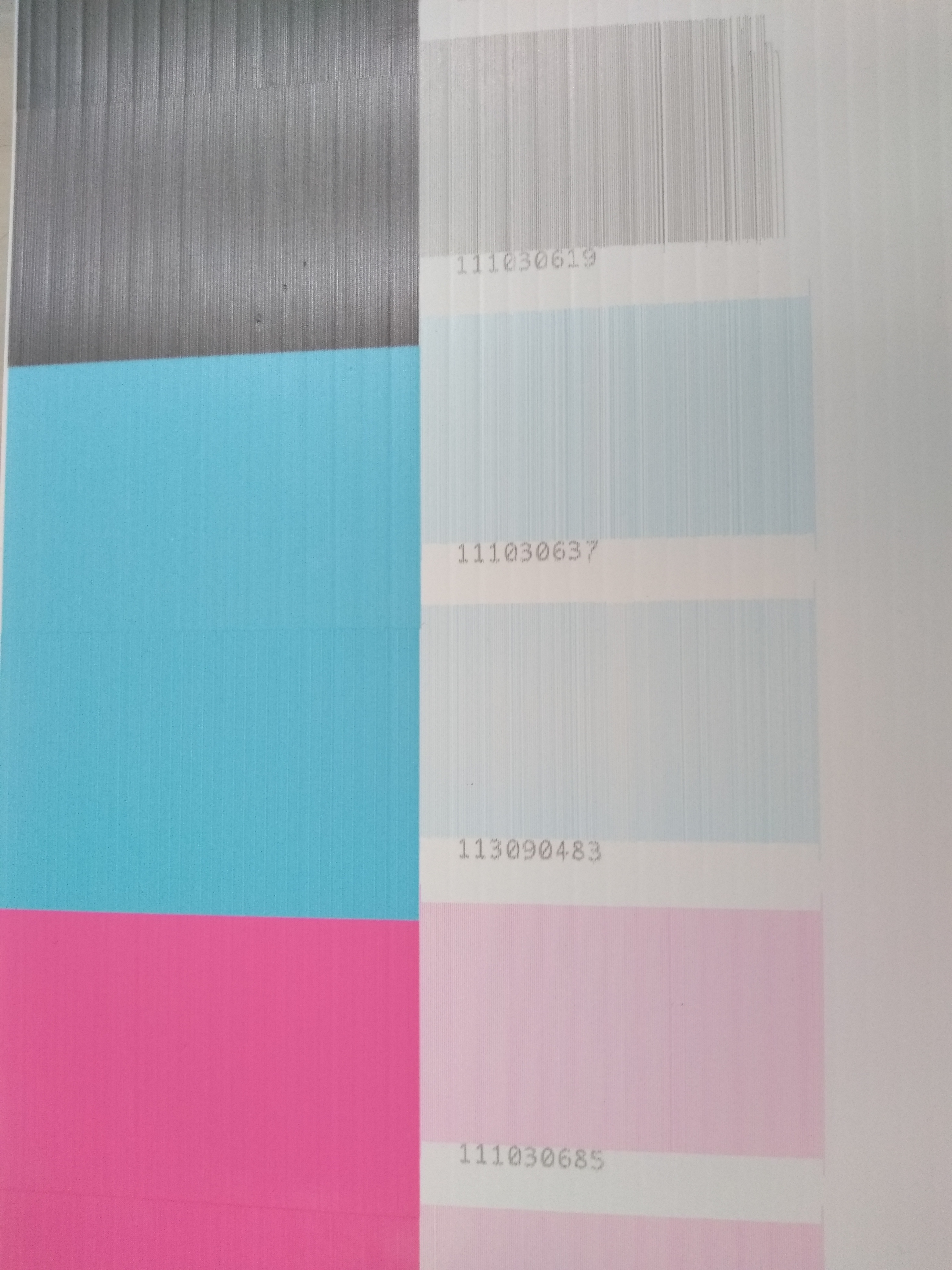

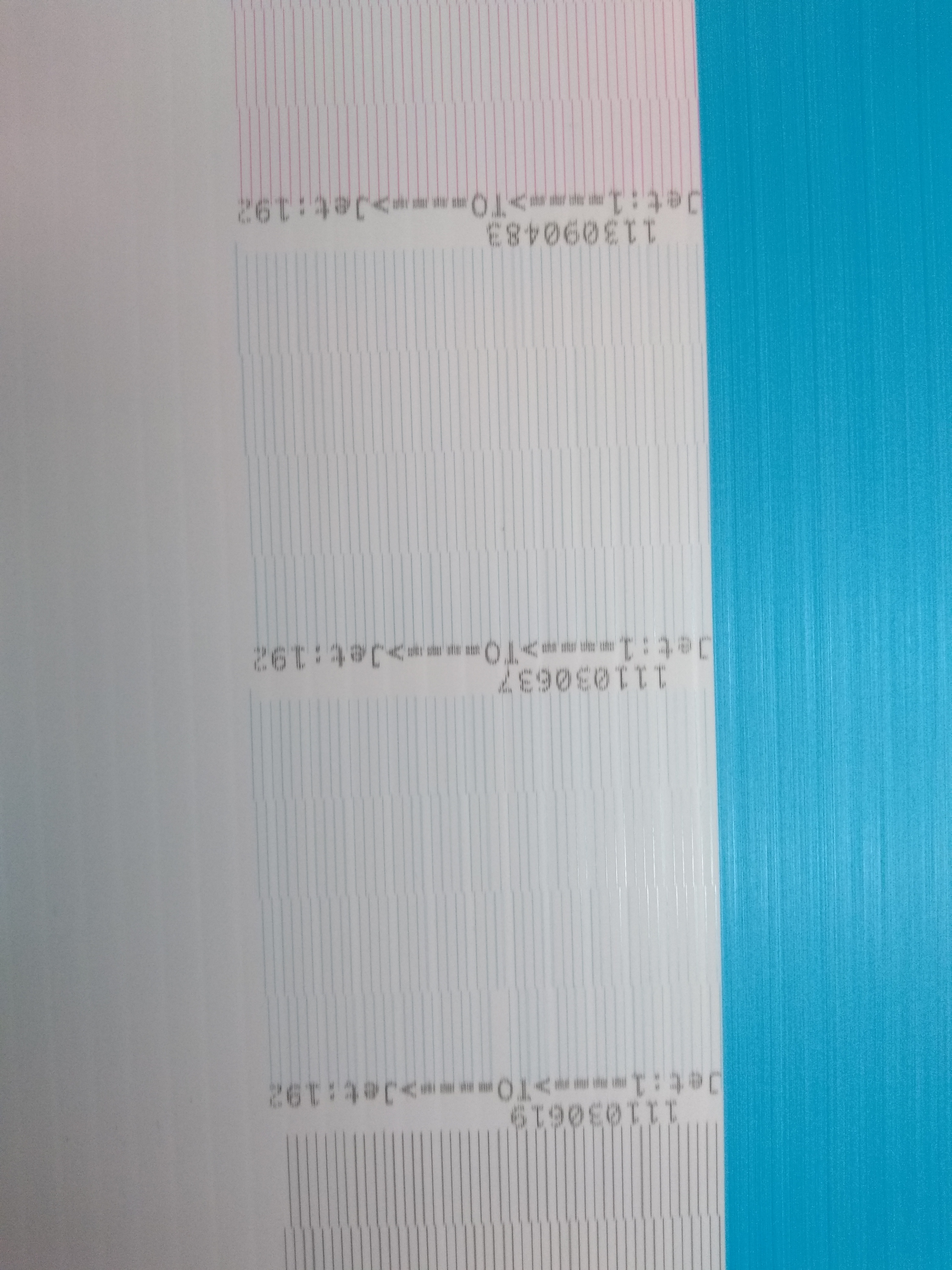

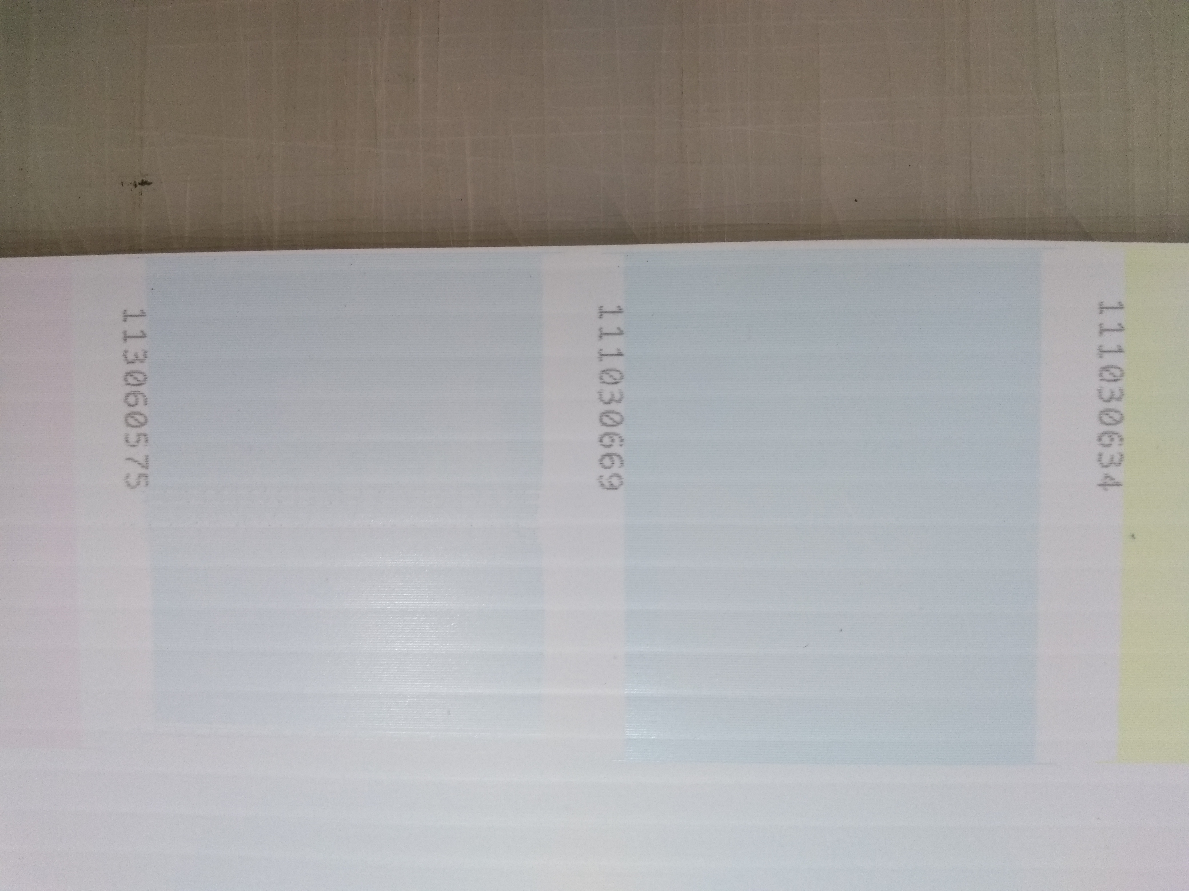

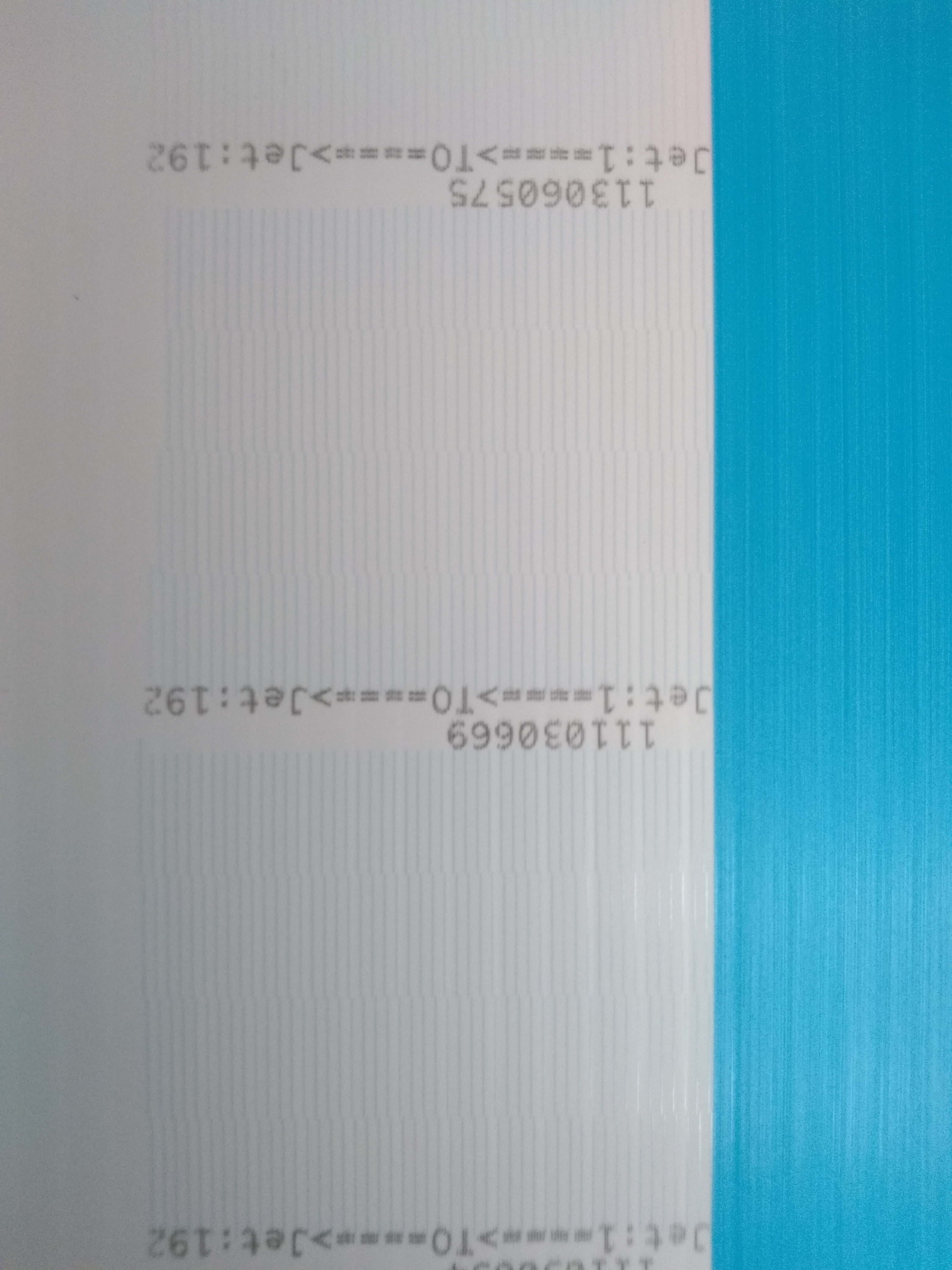

Ok, so I've run every type of test, calibrated (not the best results) however all heads are printing correctly on Photo and Photo Plus. But my cyan looks no different than my light cyan. When I try to print darker blues they look more purple. I've thoroughly manually cleaned the heads. Any ideas?

flyplainsdrifta
is it only on photo and photo plus or is it every print mode?
also damn what're you printing that needs that kind of resolution??

Chances are some kind of profile/software settings. But food for thought...I’ve had Scitex ink cartridges filled with the wrong ink. Mine had light magenta in a magenta cartridge. It’s a tough one to figure out because who would think but I’ve had it happen multiple times with scitex and once with and HP latex too. But you can eliminate the possibility with a quick call to the vendor you bought the ink from.

Do you shake your ink boxes every week? Our Cyan looked good when printing the nozzles... but ever remax sign was purple instead of blue.
Our tech told us to goto "Replace printhead" and empty the ink lines... shake the box, re-fill the lines... and after 5-6 cleanings, all the nozzles came back and everything was fine. Thats an extreme measure though, you waste a good 5-10% of each ink cart doing it.
Have you ever had good blues? What values is your rip using for the deep blues your trying to print?

The same thing has happened to two of my friends. Turned out HP had incorrectly labeled the box wrong. This messed up his head and HP replaced it at no charge.
Call your vendor and give them the lot number of the ink and they should be able to tell.

no that absolutely sounds like a bag issue. could be the filter. check the hoses!!! if there is a kink in the line that can do it!!! happened to me last year. when you open the box, if the collar for the cap is not above the cardboard where it should be the hose can kink when you go upside down to connect the bag to the nozzle.
Boxes can be mislabeled for sure but this is also all good calls from Flyplainsdrifta. There can be kinks in the lines or the filter at the end of the line attached to the cart can be plugged...press the little white “nipple” on the end of the filter and ink should drip out...if it doesn’t you can replace it with a good one from an old cart. There are also filters on the lines both inside the user end shroud and on the carriage...those should be checked as well and replaced at least yearly depending on your volume. Good thinking Flyplains!
