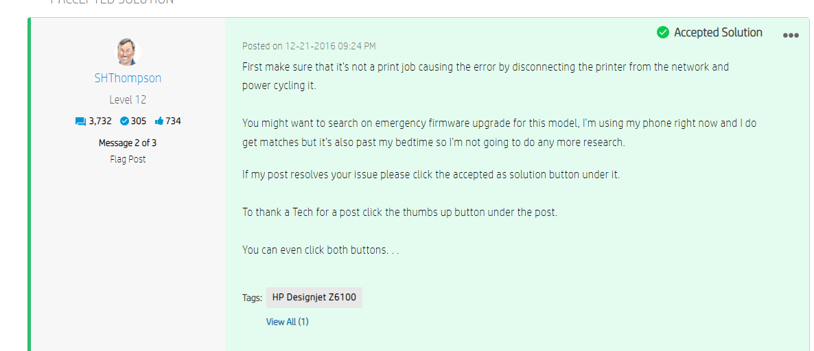

I just did a quick google search. sounds like it might be the print job in the queu.

i know you can't believe everything on the internet but when you google the code it says its a print job that got stuck in the queu

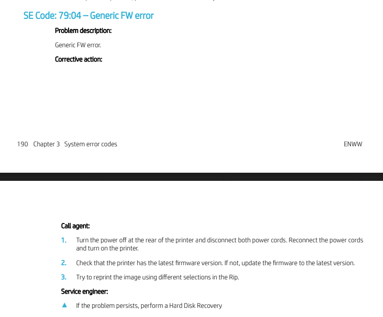

hi guys thanks for the replies and assistance.
so turns out it is not a connection issue, i have a local tech here and all connections are good, it seems to be a firmware issue with the newest firmware so we are now trying to roll back to the older firmware to see if we can get the printer to accept jobs again. p.s still nothing from HP 27hours since i have called
DRD0198
Final outcome the Printer is running just fine..... what ended up being the case was something i overlooked, i had the local computer tech come check everything out and everything looked good the problem was i do some printing for a guy that does his own design work and it appears that he had three artboards in one print and quite possibly that was just too much for the printer. i went back to my last print job and started to print it and it went through just fine. i may not know alot about these computers and there programs but i sure am learning quickly. as far as this case goes its closed i appreciate everyone that took the time to try and help out.

Yeah, 79:04 mostly shows up when the printer detects that something went wrong but doesnt know what excactly. So the solution can be tricky to find.
