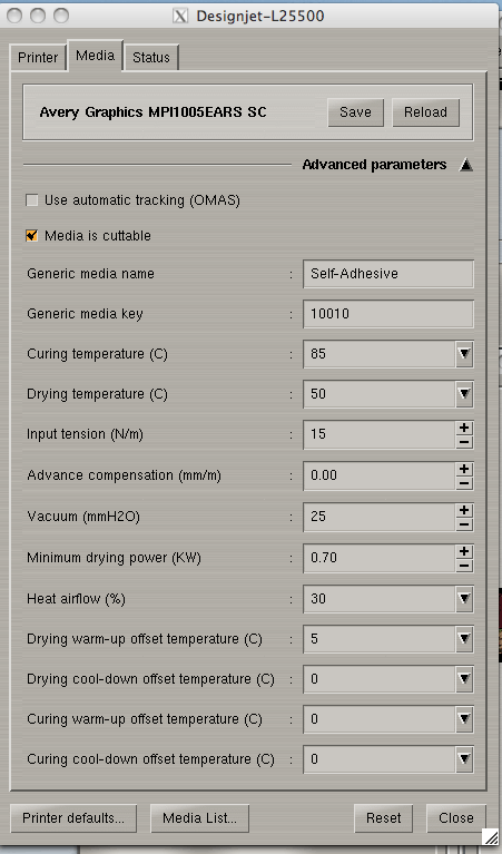

what are your current cure / dry settings?
Westlandent
I have a feeling these settings are way incorrect
Hope I attached this correctly...
drive
110c
55c
per canned profiles in Wasatch, but the printer is the same.... and I've only seen HIGH black black black ink coverage come off oily using these settings.
I haven't messed with static cling on it yet. I've been a bit reluctant too. You may go somewhere between my and your heat settings to start and feed a good amount of material out to help keep it flat on the platen.
Keep us posted....
