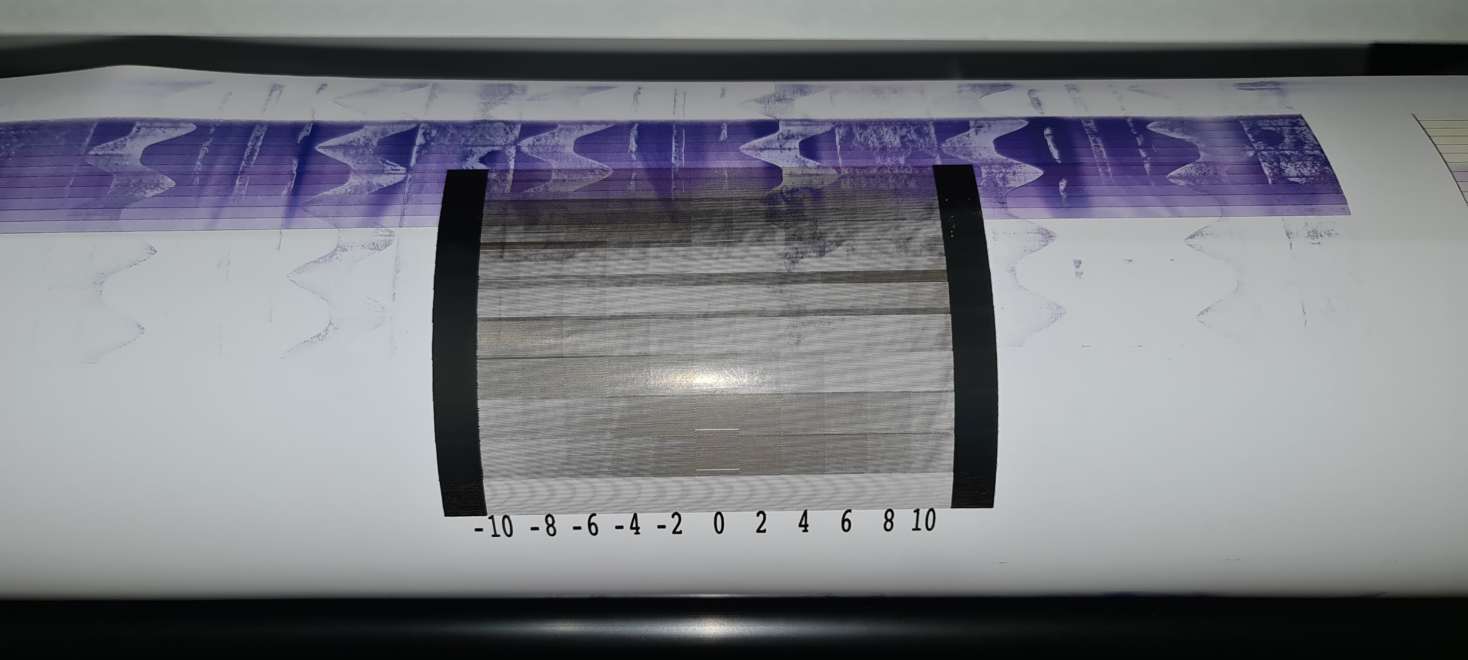

I'm having a very strange problem that just started, where the paper is not advancing out the printer. It started as a vertical blur throughout prints. I cancelled the job the first time I saw the blur, then as it starts to advance out the printer to cure the rest of the print, it just stops advancing. I didn't notice at first, but after a minute I grabbed the paper and manually helped it. It started advancing when I helped it, then it reversed back into the printer like it should, but as it did not fully complete its curing wet ink got all over the pinch rollers. After repeating this 2 more times. I went into the advance calibration option and the calibration it prints, is all over the place totally wrong. This printer is less than a year old, I'm using Flexi 19.

A picture of the calibration that is totally wrong? Have you cleaned the OMAS window? Running newest firmware?

Yes done all that, no didn't cancel the curing process. I think it may have something to do with the adjustments option that let you adjust printing parameters on the fly. Also something to do with printing presets? I changed some of the printing options like heat and vacuum then did another print, it was actually printing fine, but I went into the printing parameters as the printer was printing and noticed all my changes were back to default. It was the same substrate preset I chose, but everything was defaulted. Then as I started to change the heat and vacuum it started doing the same thing were it just stops advancing, but keeps printing. So I think I'm starting to narrow it down to something. I've uploaded the advance calibration
