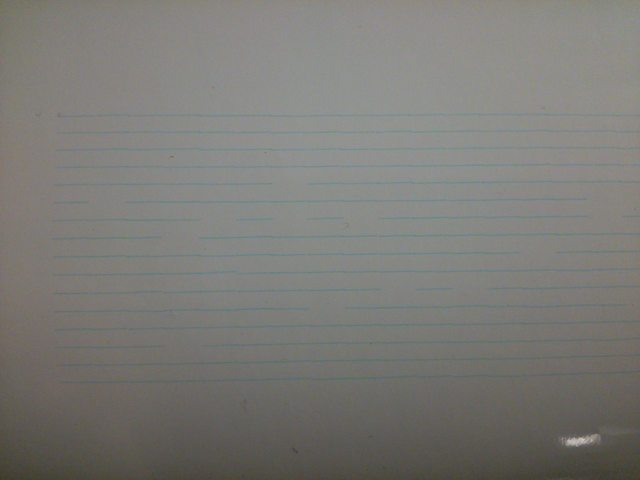

Hi guys, We have a HP9000 for just over a year and it was printing fine up until Monday when it had a minor head crash. Got all the colours back printing except the light cyan. If i do an IQ test the light cyan will only hold for 3 or 4 passes then bands badly. We have done multiple strong cleans, normal cleans, wiped under the heads and wash print heads and there is no change in the light cyan. Any ideas on how to get it back printing right.

How long did you wash the print heads? I would try to let them soak for 12 hours do a strong recovery and try again. There is a possibility that the crash could have damaged the head. The other attempt would be to apply the print head cleaning sheet overnight to the print head carriage.

I had a similar machine with the same heads that was still under service contract and experienced the same issues as you. I did the head soak for over 12 hours and still had drop outs. I utilized the service contract and the only thing the tech did was stand by the machine and run head cleanings for about 6 hours straight before the head started working properly again.

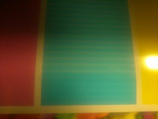

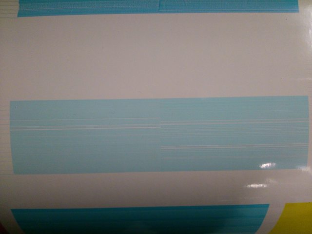

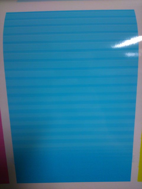

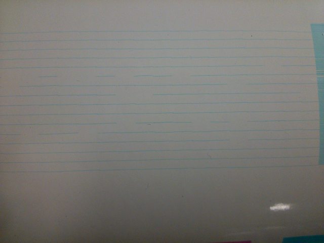

So after 16hours of the heads sitting in wipe solution this is wht a nozzel check and IQ test look like
again sorry for the bad phone pics

if the head is damaged, it's tough titty said the kitty. Those cleaning sheets work pretty good for getting old ink off bottom of head. You can turn off the printer
overnite and the heads will fill with ink and some times dislodge crap in the head. New head in us is $2025.00 plus install.

i dont know how much heads are here in ireland but i know the are crazy expensive. Thankfully the light cyan came back this afternoon and all is good,
