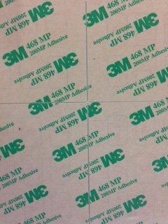

I have a HS15 Plus plotter. When I cut repeats, it's leaving a gap between them without having a gap. It was working properly until someone used it. I've tried everything I could think off but it leaves a gap by 1 mm which is not a lot but when doing a big job, it gets complicated. Can someone please help me??? I really need this to work.
Here is a picture of the gap that it's leaving between my cuts. Like I mentioned before, on my original file, it doesn't have gaps.
Thank you,
Laura

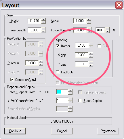

In GSPPlot, enter F5 to view or change the weed border and gaps.

I don't have a gap or anything in my layout panel. Everything is at ZERO but I still have the issue. I tried adding a gap to see if that will fix it but no luck. I also, took off the weed border. Sometimes it doesn't leave a gap but sometimes it does leave the border. At this point I don't know what else to do. Is there anything else you can think of that might help?

Possibly the weed border setting. Enter F4 to toggle the setting. It has three settings:
  • Weed border on.
  • Weed border off but keep space for the weed border.
  • Weed border off and remove space for the weed border.

That doesn't sound like a solution to me. The only other thing I can suggest would be to locate and delete the .PRM file with the name that matches the file you are working with. The PRM stores your GSPPlot settings for future repeats. Then the next time you send the job to GSPPlot, a new PRM file will be saved.
