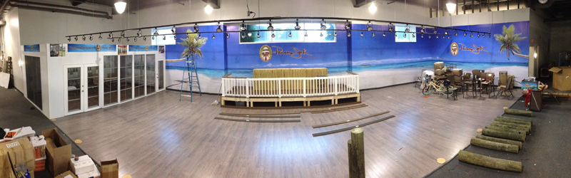

I will stretch the image and make it 3 pieces just like the attachment you see below. Now what is the best way to set this up?
