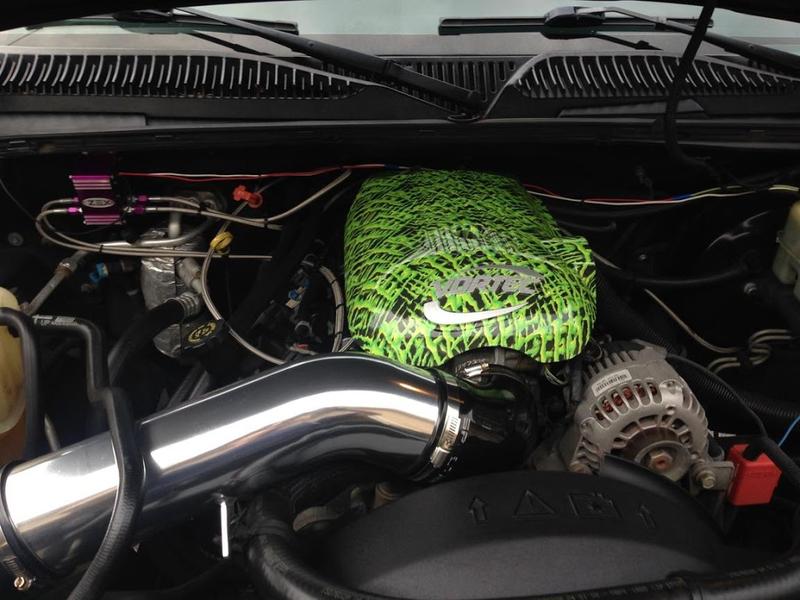

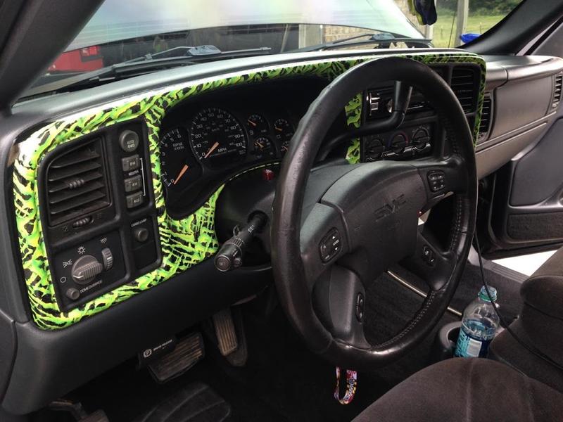

Wow, this discussion between Coppers Lot and artbot is spot on. They both have an excellent grasp of the workings of the system... I commend you both for your acuity and zeal. It's good to hear discussions about this rare and sometimes forgotten (in the signmaking world) topic.
Sometimes it's just easier to dip a part in hydrographic film than to wrap it.... Especially when you can print the film to match the wrap.

Dipping an interior and engine bay to match a wrap sounds a good idea making the importance of finding the formula for "A" more important.
It would appear I'm the only one searching at this current time.
