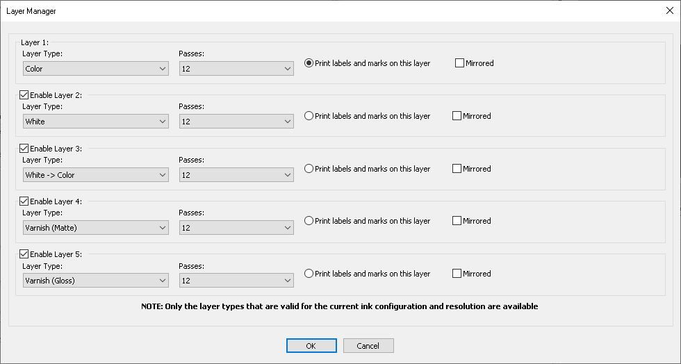

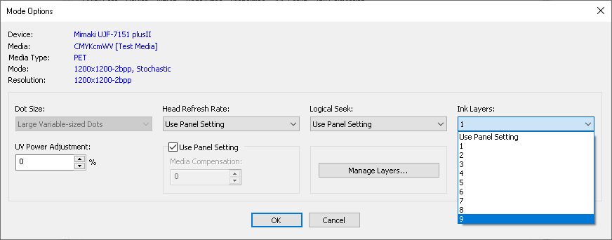

V. V.
Inkjet printing guru
lot of layered images
ONYX, for instance....
