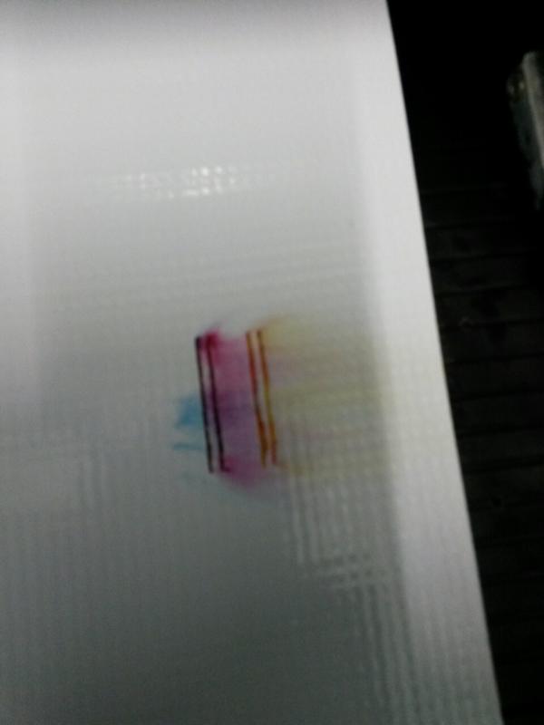

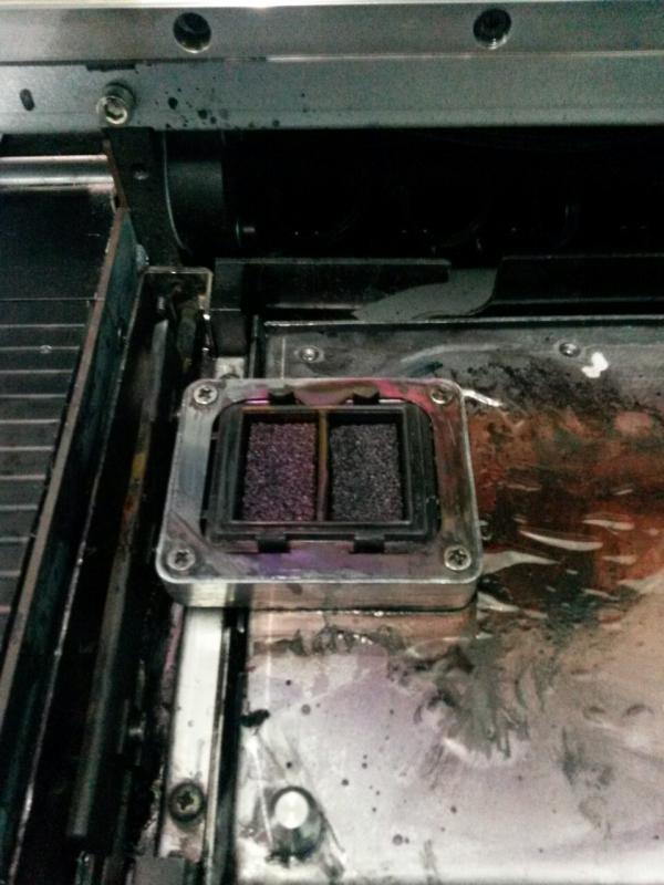

Hope all doing ok. I am stuck with my A-starjet Printer. I changed the damper and the captop. But 2 of my colors are not printing at all.
Cyan & Black. The ink comes fine from damper to head. But the on the captop left side the ink is not sucked by the pump. While Yellow and Magenta are fine.
The mashine uses 2 epson dx7 head but i am using single only. As when it was two heads anything happens it was stopping the entire machine.
I did the following things to make sure if everything is fine.
1. Cleaned an changed the new the waste ink tube which goes from Captop to waste bottle.
2. Opened the pump tube and cleaned it to make sure if it is not clogged. But still no difference.
3. I tried to suck ink from the tube which comes out from the captop and the ink comes fine but when i command machine to clean then only magenta and yellow pulls fine.
3 days ago everything was working fine.. i don't know all of sudden what happened after changing the new captop, dampers also with new print head.
I have put the sample kindly assist. Also if anyone with service manual will be great.

Capping station seal or pump?
john
Hello Mr. John. Capping station has got the seal but then the pipe goes to pump where it connects with Tee.
