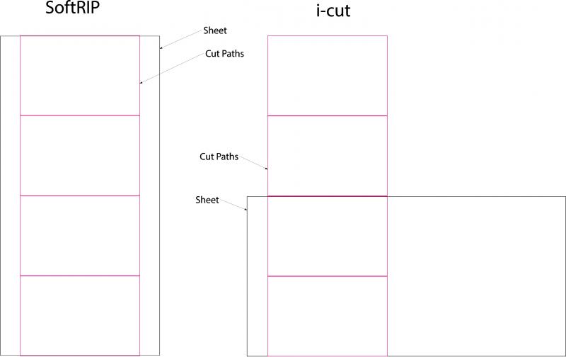

We just got a (new for us) used Kongsberg iXL24 table, and I am trying to get it to work with Wasatch SoftRIP. SoftRIP generates cut files just fine, but they are not rotated properly. When I open a cut file in i-cut, the cut paths are rotated 90° from where they should be in reference to the sheet – the top of the sheet in the cut file generated by SoftRIP is at the side of the sheet in i-cut. (See the attachment if you are confused) I am using the i-cut driver provided with SoftRIP 7.1, and i-cut 6.3.2. Is there a setting I can change somewhere to correct this problem? Esko says that I should change it in the RIP, and I am inclined to agree with them. Wasatch didn't respond to my email yet.:frustrated:
