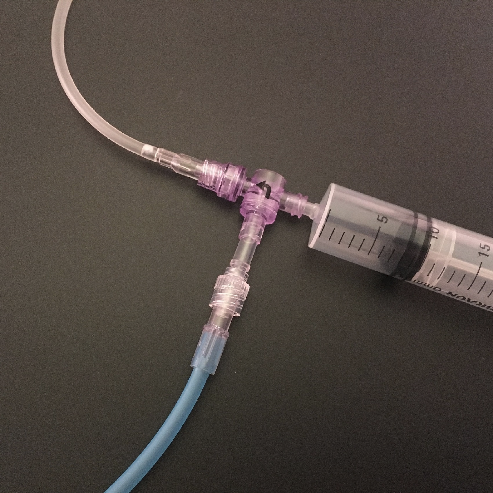

HP always has some really good ones with the spare parts. Blunt tip needles that won't puncture anything. Even a T-valve on a tube that you can change the direction of flow so you can basically pump ink between two cartridges.

No idea where you would purchase them but that's how I would do it if kept as simple as possible. Maybe your local pharmacy?
Then if there were A lot of stuff to transfer, I would probably add that T-valve or check valve.

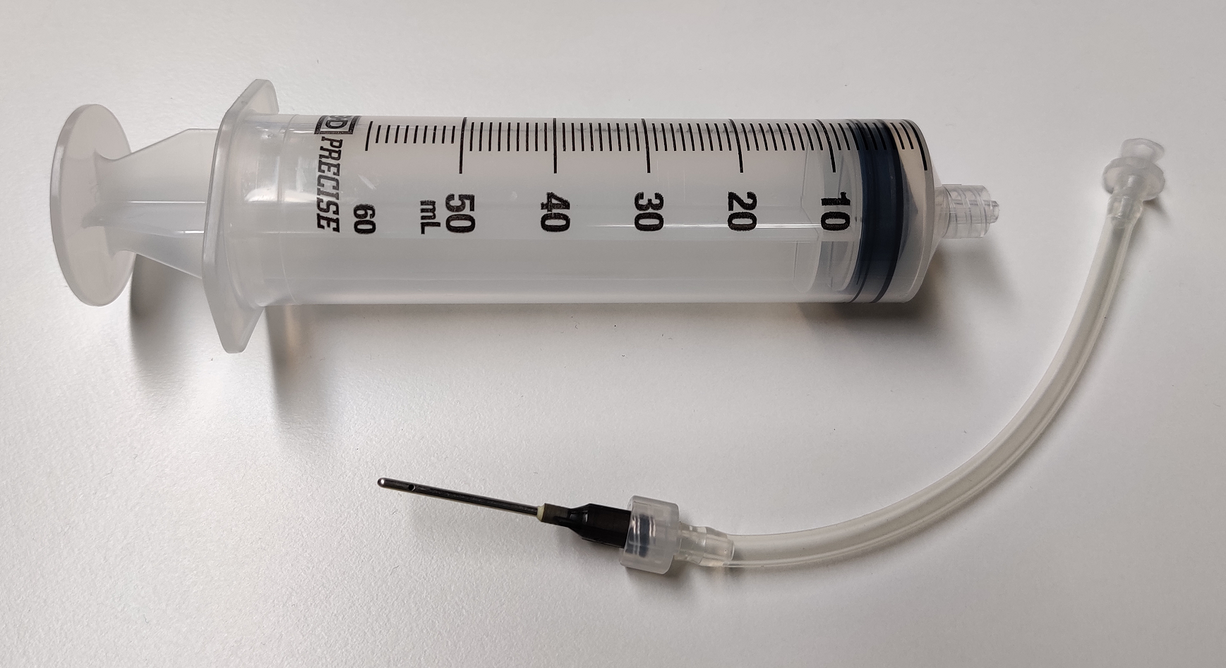

What i did is open up the nearly empty cartridge, roll up the pouch like a toothpaste tube, insert the needle holding the pouch upside down - the rubber plug facing downwards, get the ink out and hold the new cartridge upside down again when inserting the needle and make sure you don't insert it too deep. You can inject 150-200ml easily as the pouches are not filled up too much even when brand new.
Your syringe needs to be 200ml (200cc) as the leftower is usually between 100-150ml
If you happen to puncture the bag hot glue will seal it (don't ask me how do I know), don't use vinyl as ink will dissolve it over time.

I think the opposite. You are making it sound way more difficult than it is. Just keep the air in the syringe and start transferring. You are probably done in 15 minutes.
