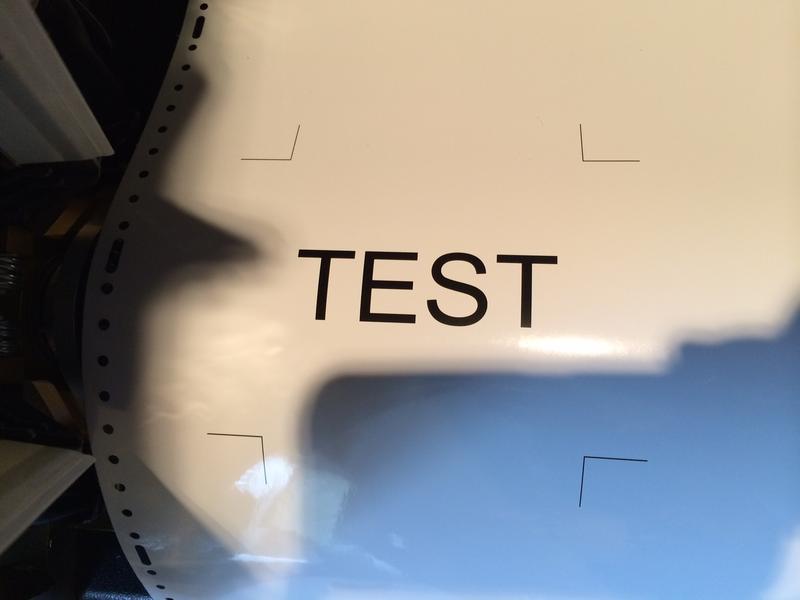

I am getting very close: For a sanity check I did the following:
Brand new blank File- Typed TEST- Assigned contour Cut. Assigned Black GCS 12 as Color. Checked All for Color of crop marks. - IN Production Mgr., I Reversed Print order for CMYK to- Black, Cyan, Magenta - Yellow Order. Checked only the Black Box.
Sent to Print-: Edge asked for Process Black GCP-812 ( I left in Black GCS-12). - Printed Crop marks perfect- no shadow of word test. Edge then asked for GCS-12- ( again, left in GCS-12). Printed TEST perfect.
Total graphic is perfect.... No double print of TEST...Check out the picture.
SOOOOOOO.....this tells me that Black for CMYK must be hiding in source design? I thought I assigned GCS-12 to my whole graphic- but other colors must be present-- now to figure out how to find and remove them...Thank you.

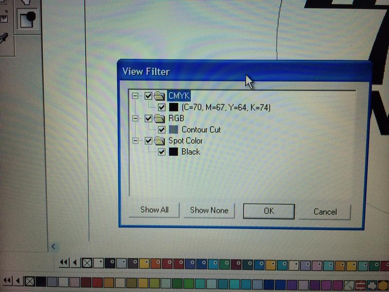

It could be possible you are changing all the fills in flexi. and not changing any of the strokes. Maybe the CMYK is in the stroke.
this makes sense, since you say it prints a faint outline of the artwork along with the cropmarks

Jburns
J Hill and Big Easy- I think you guys are spot on. I did View- Filter: See picture. There looks like some CMYK color in the graphic?
I see my Spot color and Contour cut listed under RGB...

Jburns
I can select similar color- but the whole object moves...I will have to adjust the graphic, and remove the CMYK color components.-
