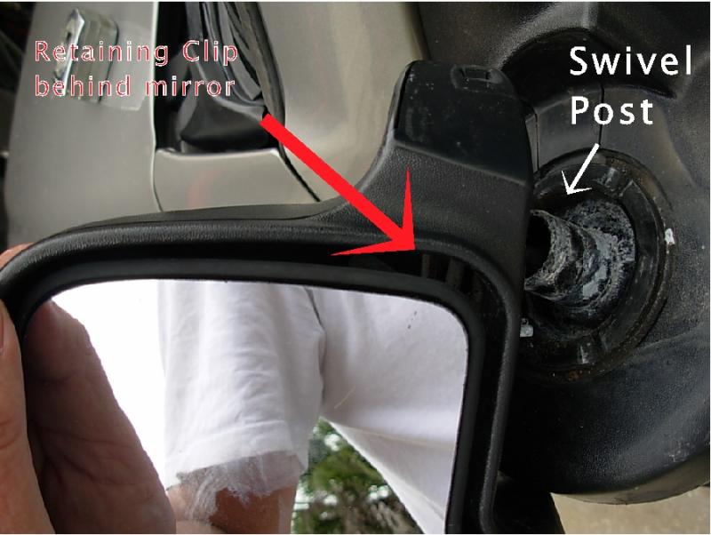

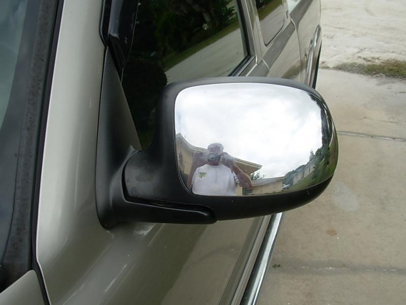

Moved the swing back mirror on a '99 Chevy P/U and POP, (literally) and the darn thing POPPED OFF.
I can see between the mirror and shroud that there is a spring loaded retaining clip that holds the Assembly onto the pivot shaft that has come off.
?? How do I remove the mirror, (glass) so I can re secure the retaining clip on th swivel? Or is there another way in?

I have bodyshop background. Many, but not all of those glass assemblies are seated in a plastic ball joint-type socket. and usually (but not always of course) you can GENTLY get behind the mirror frame with a little pry tool and pop that piece out to give you access to the inside stuff.
-Usually....
PS...there are USUALLY 2 or 3 of those ball sockets in a mirror, right where the little motors are to pivot it in and out, up and down.
