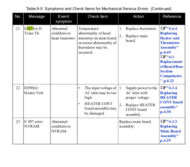

Main board. That error specifically means one or more of the transistors that amplify the head signal is overheating. If you can find someone who does component level repairs they might be able to fix it. otherwise a new main board is due. It's about $1000.

Attila Nagy
This is what the SM says about it.

Since we have a Signwarehouse machine can the mainboard be replaced with a regular Mutoh mainboard or is there something special in the firmware or something special with the board? Ours says it's a 1204GA.
