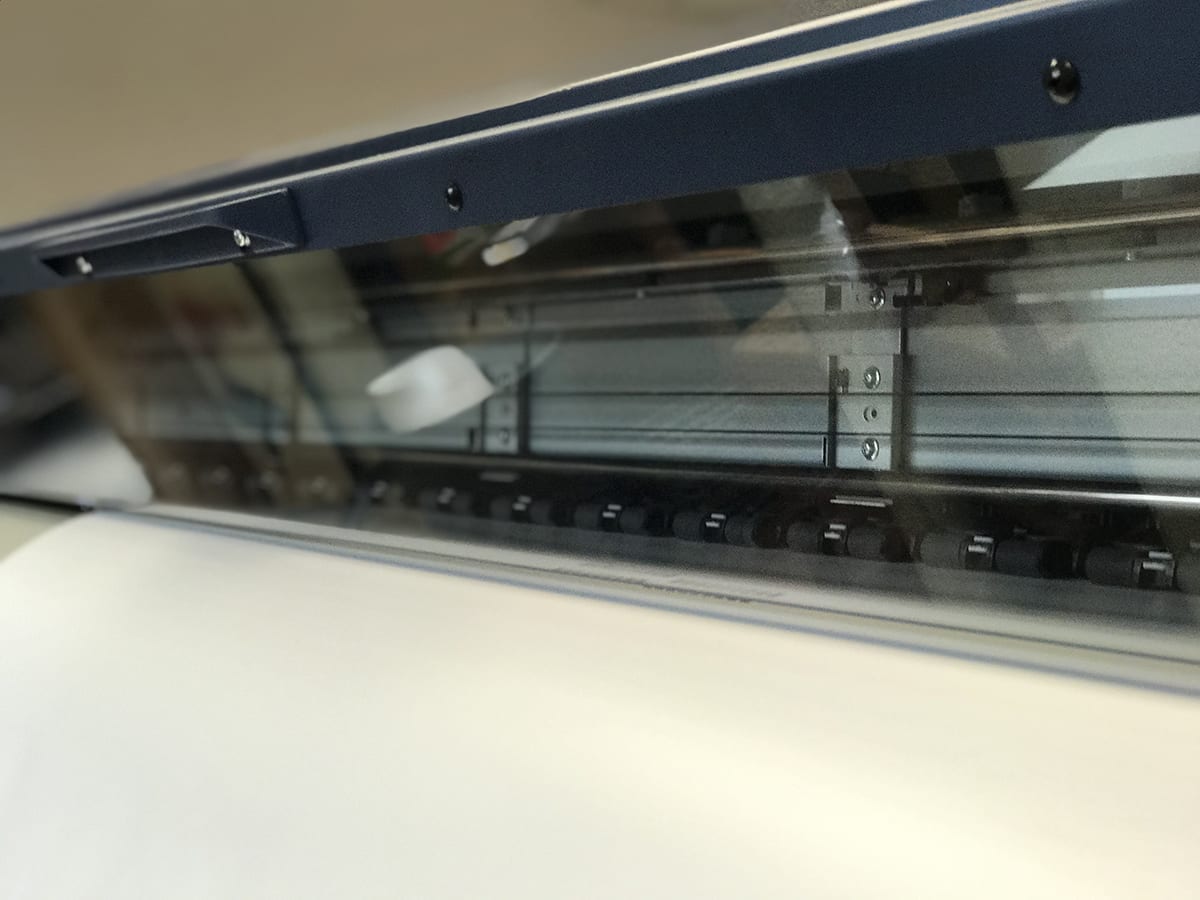

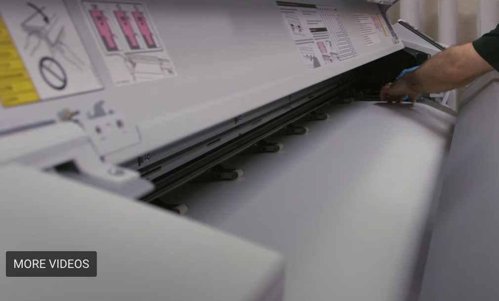

here are a screenshot and a photo showing the different pincher rollers (I had to use a screen shot from a youtube video as we don't have the S70s anymore), is this the same pinch wheel system you have (similar to a plotter pinch wheel/feeder system)? If so that was the issue we had with headstrikes and going to the continuous pinch wheel bar system on the S80s fixed all those issues.

Thanks so much for the info. Yes, that is the same pinch-roller system that mine has. After reading your comment, I'm really looking forward to upgrading.
