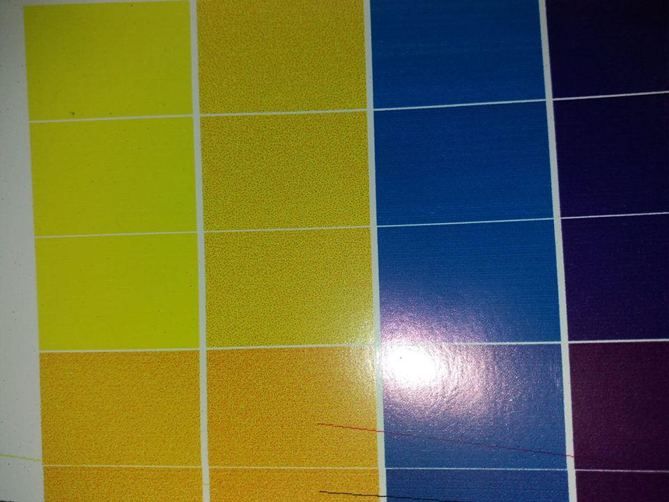

hi im new in digital printing and sorry for my english!!! i have an old mutoh rockhopper 38 falcon jr!!i remake this to new!!! when I print dark colors on the vinyl they look like dots!!! my nozzle check is ok i have onyx 10 and i change media and profiles but not fix please help me!!

Looks somewhat normal. Those older printers don't really stand up to close scrutiny.
There is a chance that the material could be causing the issue if its cheaper stuff.

try changing the "dither settings". It gives a different dot pattern and should be able to blend the colors better.
adreas
hi thanks for your help but i dont know where is the dither settings please help i search on manual but not find
