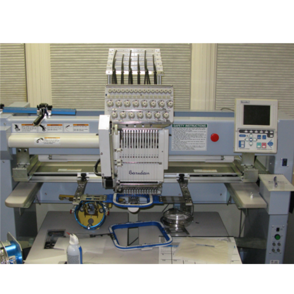

Barudan bar none is the absolute best brand out there for stitch quality, as well as, support after purchase. Also, if you use their native .U?? (no, that is not a typo) files, you can do so much more within the file itself provided you are using a digitizing software (Wilcom, also the best) that allows for this. DSTs are the most common generic file used with commercial machines, but those files do not support all of the functions that a Barudan machine can do. A particular function that I use regularly on our machines is the slow/fast function. Meaning, you can speed up or slow down the machine given the needs of a particular area of the design (small lettering/detail etc) within the U?? file itself. No babysitting the machine to slow it down and/or speed it back up. Those codes are put at specific stitch points. Once the machine reads it, it does it. You can do it on the machine itself, but it's not as efficient as being able to do it within the file itself. To my knowledge that is a functionality only available on Barudan machines.
If you are wanting the same capabilities with your single head and your multi-head, you are going to want a bridge style single head. Barudan bridge style machines, with regard to caps, allow you to stitch a max of 14" wide, the height is determined by the height of the item itself as long as it doesn't go beyond the biggest size for flats. Which unless you are doing a Dr. Seuss top hat, you shouldn't hit. To give an example, on your smallest hat size (low profile, typically unstructured), I can fit a 2.5 design on there without issue. That's on the single head or the multi-head. Singles, particularly your desktop variety are closer or at 2" in height (regardless if it's low, mid, or high profile). That extra half inch allows for a lot, designs that wouldn't normally be able to translate as well, that helps them a great deal.
Now, digitizing is a whole other can of worms. Rather you plan on doing it yourself or outsourcing that part of it, I would suggest you get Wilcom software. Again, not one of the cheapest, but it is the best. Unlike the immortal Ai v Corel and/or PC v MAC debates, there are significant differences in these software packages, even if you digitize correctly and that is what is called the stitch engine (the algorithm that generates the stitches after you digitize objects). That and the sheer functionality of Wilcom (especially if you use the full version) just blows the others away.
Attached is the type of single head that I would suggest. That is our specialty embroidery machine (it does regular embroidery, as well as, sequin embroidery), so don't need to worry about that part of it, just the fact that it is a bridge style. It has all the functionality of your multi-heads, just compressed into a single head.
Now, one word of caution with your multi-heads, especially 3 heads on up. Stay away from the step motor driven machines. There is a particular quirk with those machines with 3 or more heads. The further away from the motor you are, the sloppier the pantograph can get, typically on hats due to their special digitizing needs. Your first two heads, no problem. Third head maybe/maybe not. That fourth head on, more than likely heading for the trash bin. Go servo driven. For your single head, it doesn't matter, but your multi-heads past two heads, it does. You can mitigate that with even more special digitizing, if the digitizer is aware of the issue, more frequent servicing of the machine etc. Just be aware of the quirk with your step motor machines.
This is it in a nut shell, if you have any other questions, concerns, comments just let me know here on in the email in my signature. Hope this was helpful.

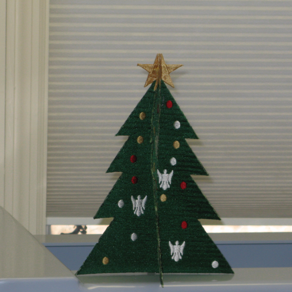

We started with a 6 needle single head Brother and then cam across a deal on a 4 head SWF. Both very capable machines. Eventually you will need a few different backings, thread racks, some wall space or a fairly large shelf to keep all the different hoops, etc, etc. Our 15 needle 4 head - you cannot just buy 1 cone of a thread color, for everything you run on the 4 head you have to buy 4 of every color.... The machines themselves, particularly a larger multi-head, you will greatly benefit from some professional training on dealing with it.
Brothers are very good. A lot more so then most people give them credit for. I think what hurt's them the most is how Brother goes about marketing them. SWFs are very good. You do have quite a few no name (or rather new to the game) machines that haven't really quite proven themselves out there yet. Those I would stay away for a few yrs still. Let someone else be a guinea pig. To add to the list of smaller items above, I would also keep around lighter weight thread and a couple of specialty needles (one that is smaller in size and one for metallics (larger eyelet)). Other then that I use a 75/11 for everything else. Not that bad of a pain for your single head, but for your multi-heads you are going to have a lot of fun swapping them out, but it's something that not everyone does and it helps with quality.
Also extra empty bobbins to spool your own. Being able to match upper/lower thread colors on certain projects (Christmas tree example), that adds a nice touch. Plus, if you run out of the pre-wound stuff, you can still wind your own in an emergency.
Choose you machines carefully - some brands and models are problematic. Anything decent with a full color screen that will make it easier to use is not going to be cheap...
Can't emphasis that enough. A screen on the machine is very, very helpful.
Evan (Wildwest) knows his stuff on these.
Start out with outsourcing the digitizing to Wildwest.
I appreciate the kind words. Thank you.

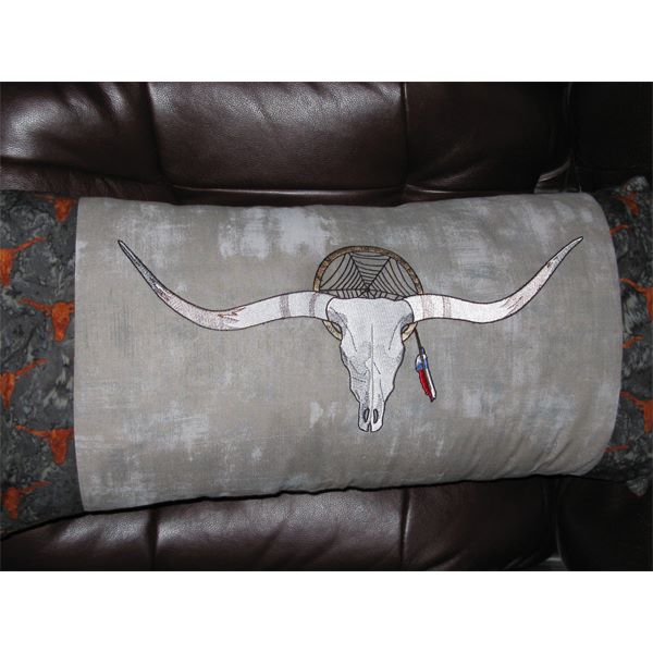

What machine is going to allow me to embroider a pretty big design on the fronts of caps?
The best way to get the largest embroidery area on a cap is to embroider it before it is assembled....I love seeing new caps around town....I often approach the potential client and ask them if I can do a spec sample of the caps I sell....Because I "off-shore" my caps I can do things the local embroiderers can not....On top of visor, below visor, on velcro straps, larger fronts, etc....
Now in-house embroidery has it's place, but IMO it is not for "some" order of caps....If your client wants minimal embroidery or quick turns, it works....But it there is a large number of stitches, multiple locations, odd locations, lots of time, etc. an "off-shore" source will make you more money....And free up your time and equipment for more profitable work.....
WildWestDesigns
We actually do embroidery on the flat and build around it. Not for the hats mind you, although we can, low runs too cost prohibitive and for the large runs, you can't actually beat the price of offshore, but we can do it. Just not worth it.
Attached is a custom pillow case that we did. We did the embroidery work and built the pillow case around it. Wouldn't be able to do that with a pre built pillow case except in a few instances, but it would depend on your machine and the type of pillowcase. This style (envelope style) wouldn't be possible unless you either tile the embroidery (the Brother PR 1000 lineup is suited for that type of work since it has to tile for the larger sizes that it can do) or you tear down the pillow and sew it back up.
You are right though, embroidery on bills, velcro straps expecially. Larger fronts, that will depend on if you are going over the top or not with the design. That will depend on the design.
Odd position places will actually depend. If it fits within a hoop and you aren't going to hit the hoop itself, you can put it anywhere, it doesn't have to be in the center of the hoop. I've done some funky locations on hats. Even on the mesh of trucker style hats using a technique called fringe applique. So it really depends on what you mean by odd locations.
