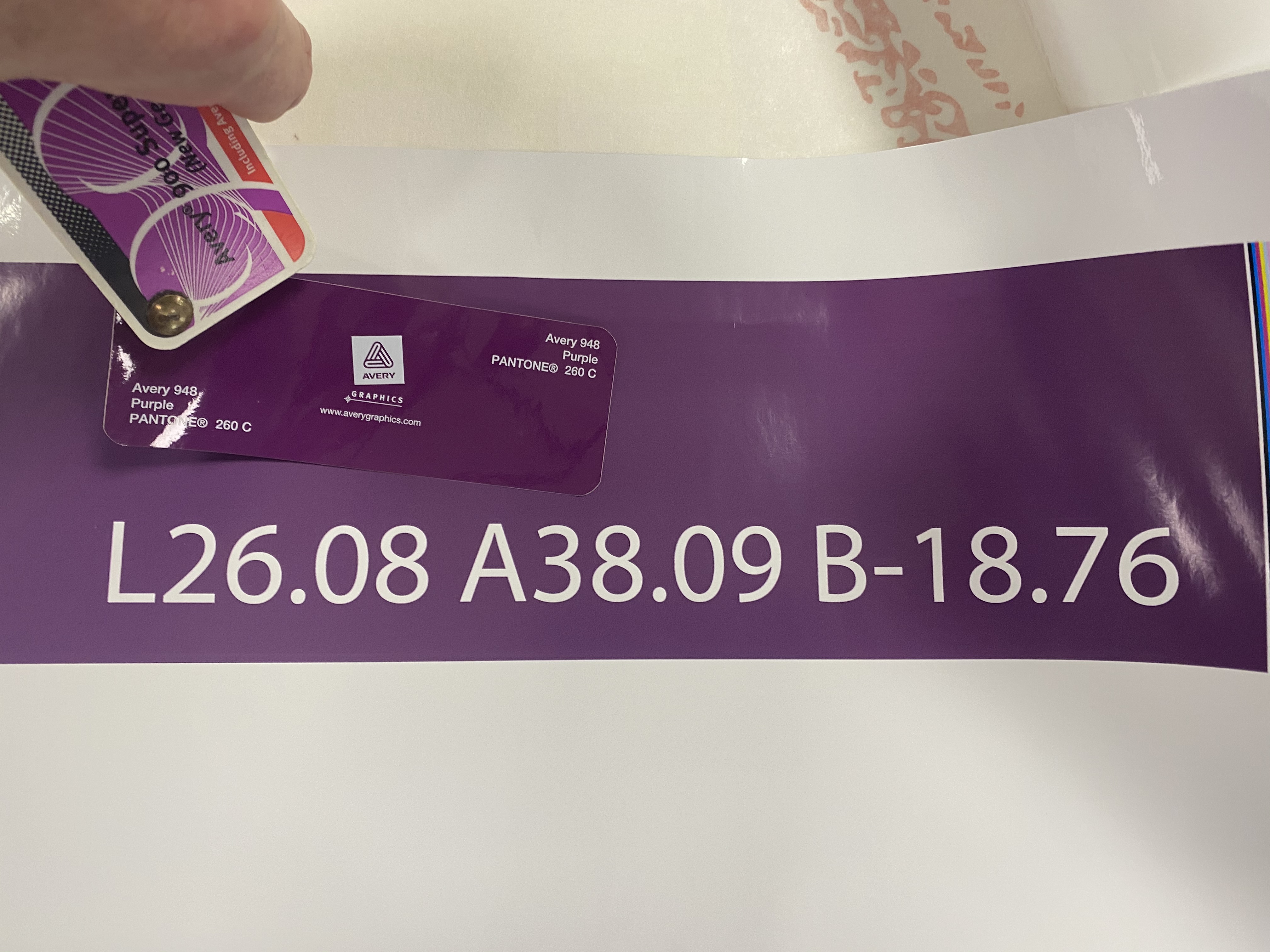

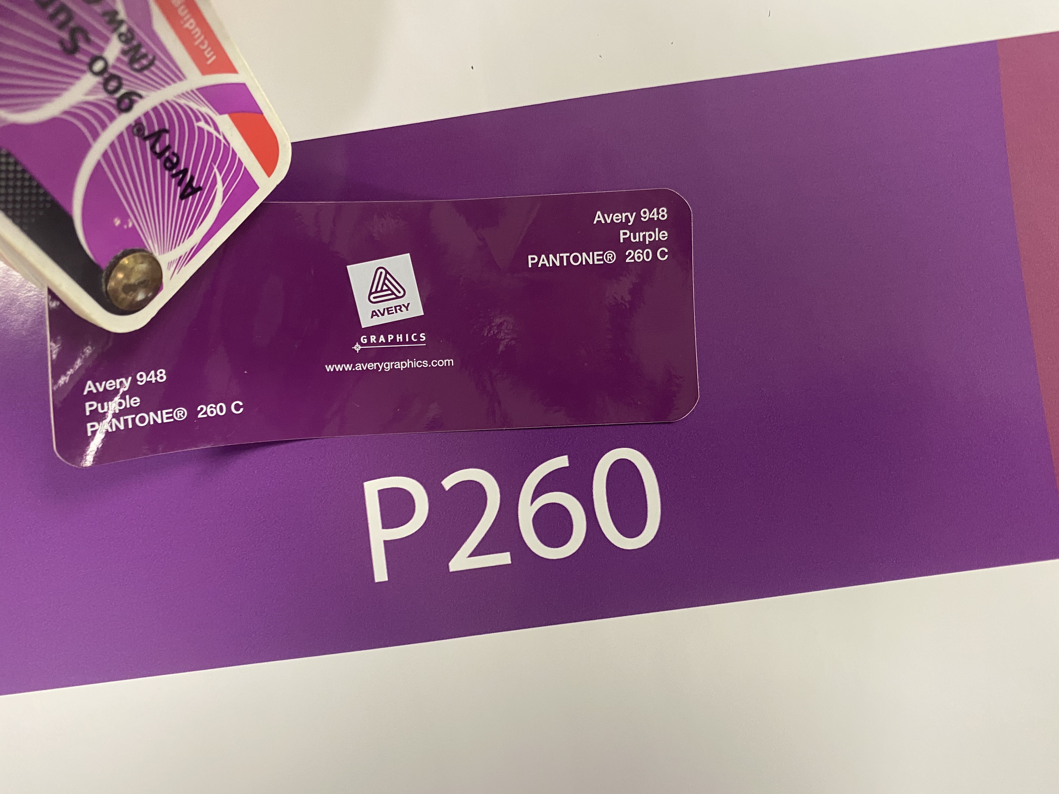

I've tried switching it off, I still find the colours way out OR am I just too picky? see attached, 1 is with Pantone 260 selected, and the other is the LAB values that the i1 pro gave me, but with colour management is switched off.
Thanks

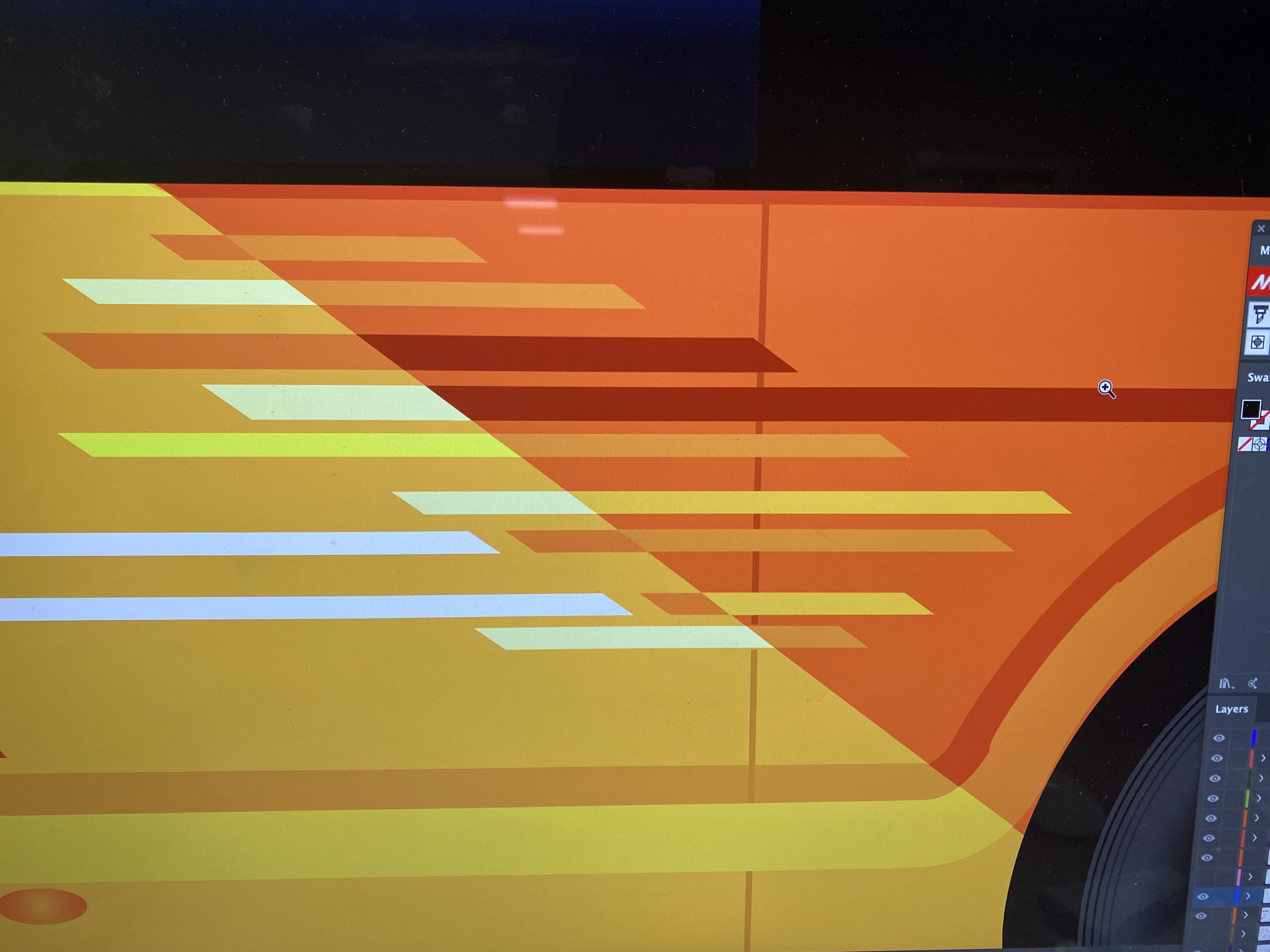

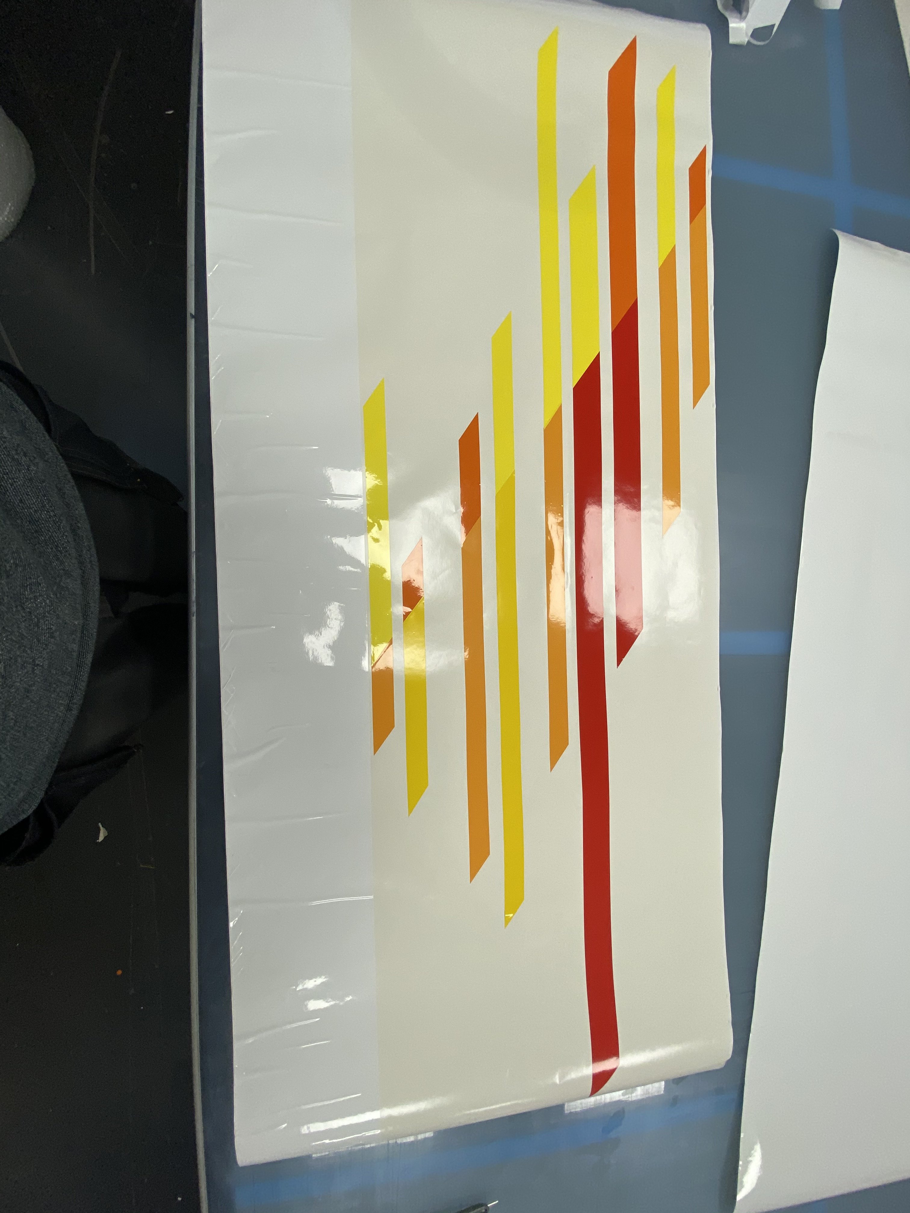

DrunknMonk
Pictures attached of what I'm trying to achieve, but just by printing instead of cut CADCAM vinyl, we do it in vinyl now, but I want to print them to speed up the work as its taking forever to sort vehicle repairs.

The best way to hit Named Pantone colors like that is to look at the output CMYK values in Onyx color replace and use that as a starting point for printing a chart of variations of that color and then determine what values looks the best and then add that to or create a new Spot Color Library. In my experience output profiles can not achieve the gamut necessary to hit those kind of color with the latex inks. Using the spot color library (or just replace color) CMYK output values method will get you the maximum gamut that the latex inks are capable of which still may not be enough to match some colors.
