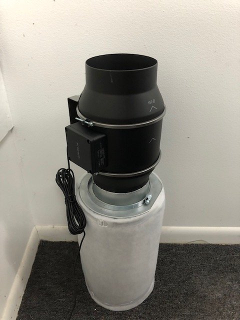

Here's an idea if anyone is looking for a good air filter for their print area. It takes the VOCs and smells out of the air pretty good and is not expensive. You may need more than 1 if you have a large room but there are plenty of online calculators to determine the cfms and recommended air exchange rate.
I just vent ours back in the room, its about the same as having a large P95/OV mask sitting in the corner. From what I read, the filter should last 1-2 years.
Filter: https://www.amazon.com/gp/product/B01N5OBM37/ref=ppx_yo_dt_b_asin_title_o08_s00?ie=UTF8&psc=1
Blower: https://www.amazon.com/gp/product/B07FPFVZTZ/ref=ppx_yo_dt_b_asin_title_o08_s01?ie=UTF8&psc=1

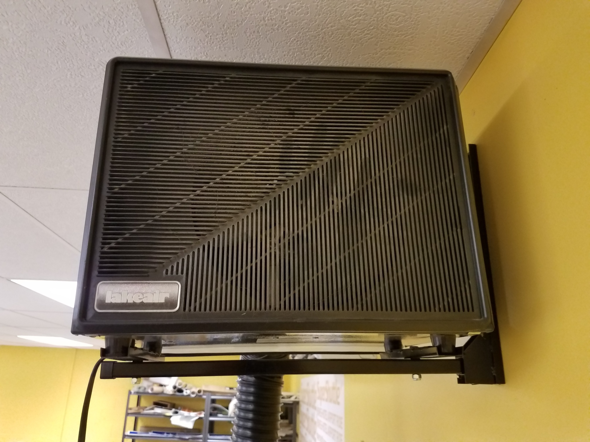

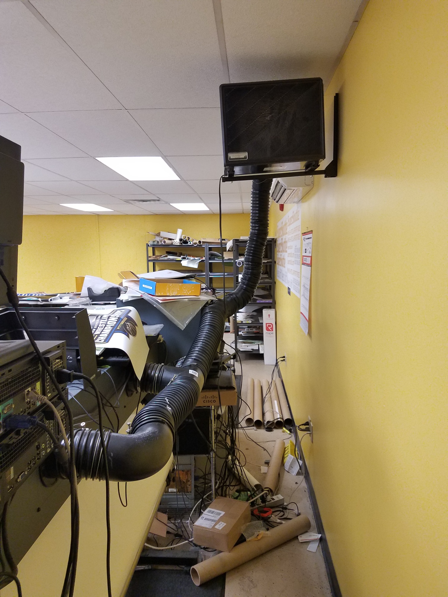

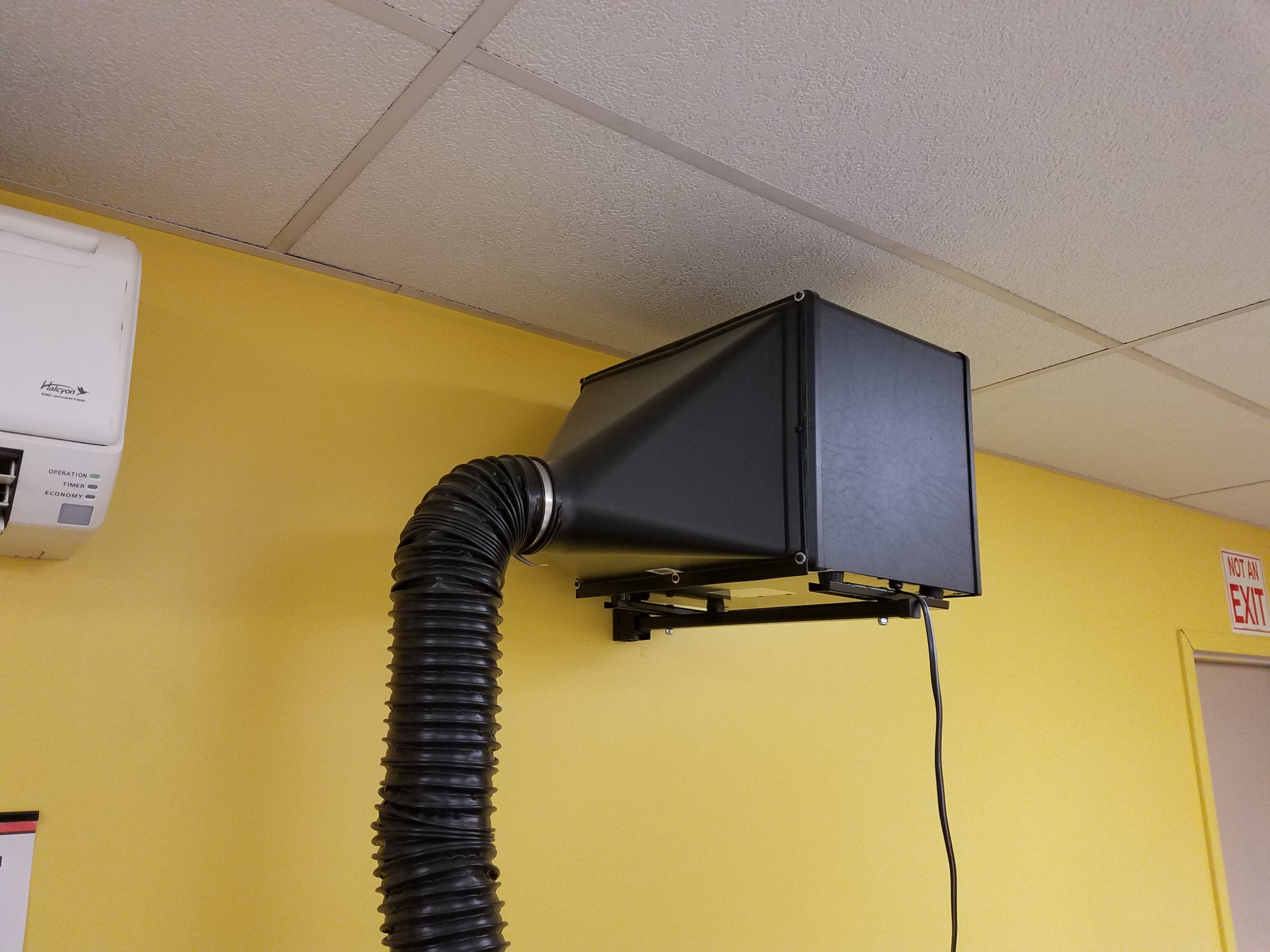

Here is my solution. Its a Lakeair air filter hooked up to my printer using hoses and fittings for a saw dust collection system. I put 2 thick charcoal filters in it and it really kills the smell from my Mimaki solvent printer.
I also put it on a timer so it only runs for the 8 hours i'm in the shop.
