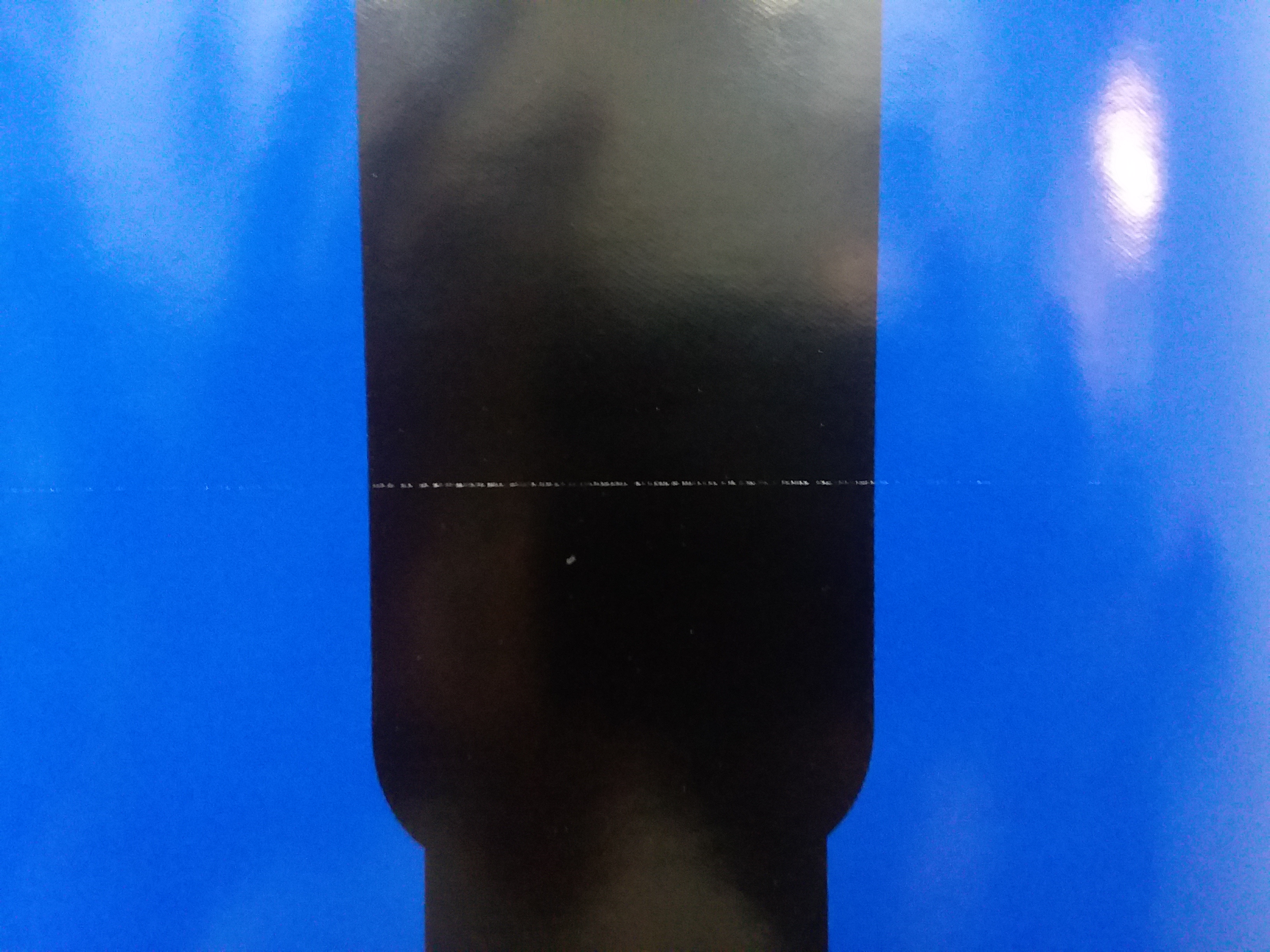

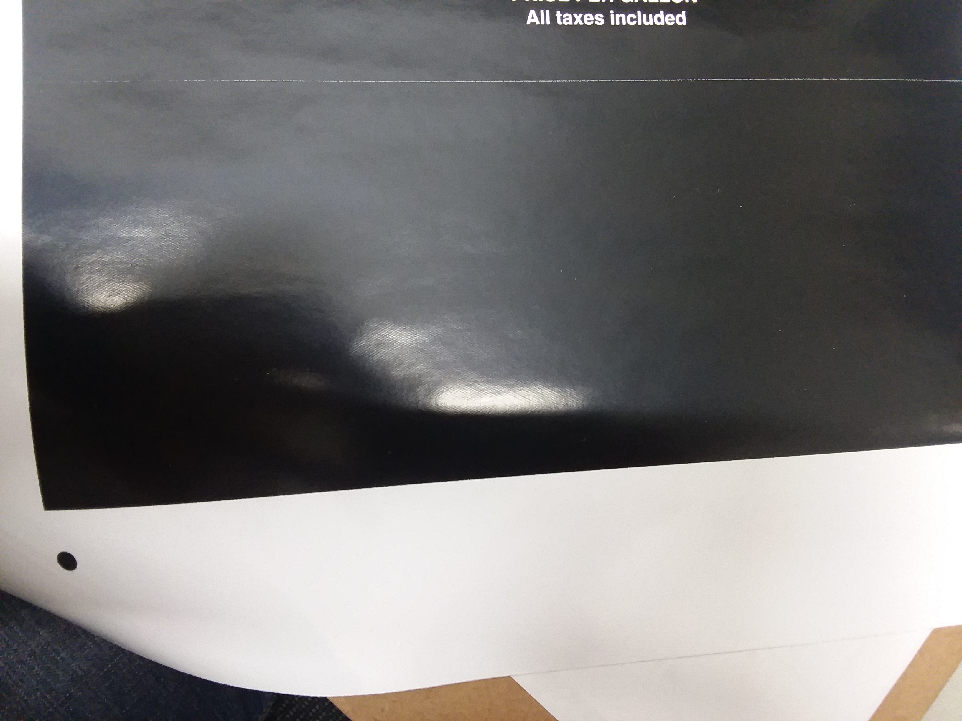

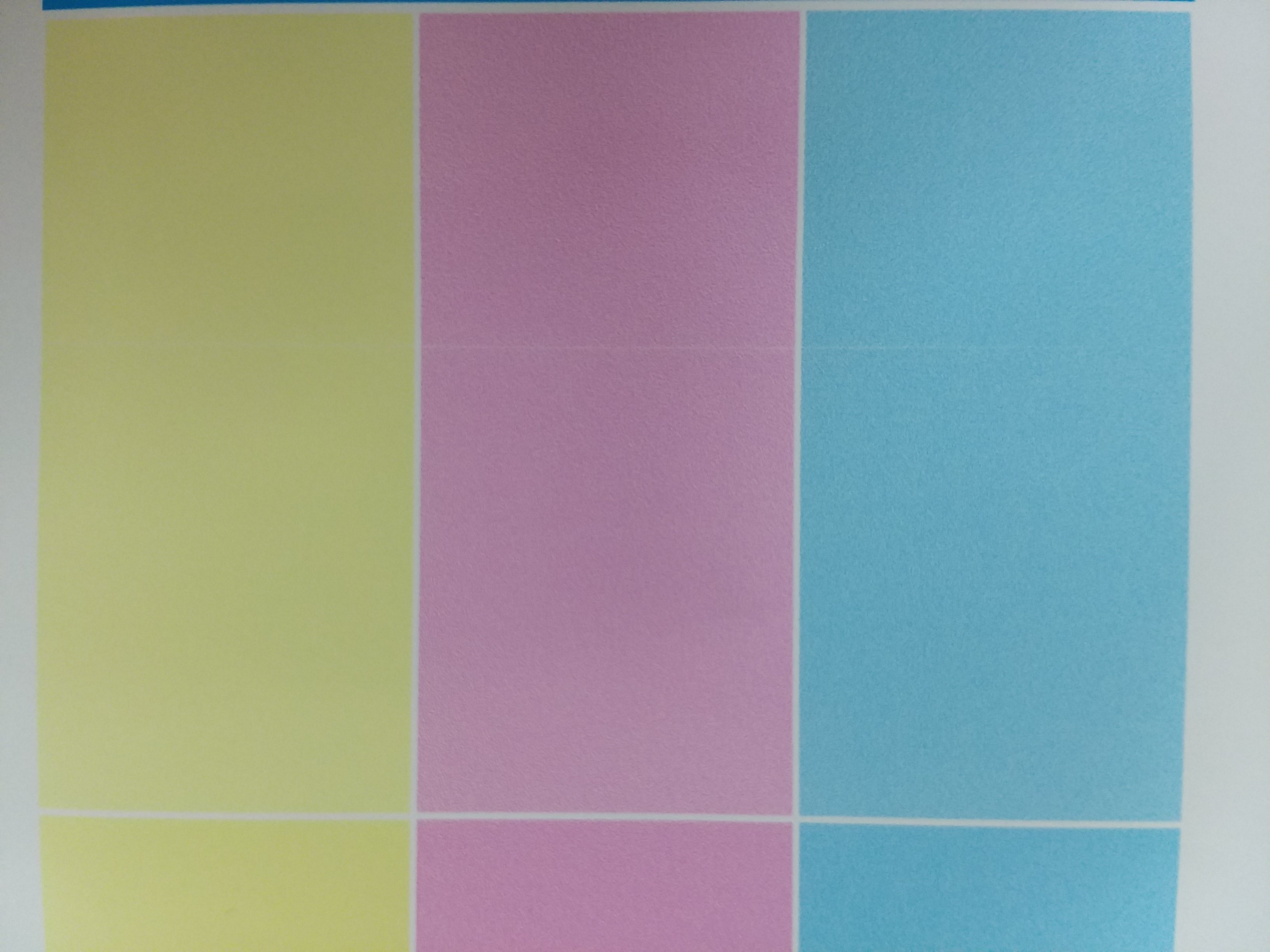

Had a roll of IJ35C-10 (3M materials) last week that had issues with lines showing up on the sides of prints. Came out towards the end of the roll so I didn't have the box anymore with the Lot number.
This is a new roll of IJ35C-10 and now I'm having the same issues. Hard lines showing up in the media where its printing.
Only shows up every so often, maybe every 10ft on the far right.
The latest showed up on the left side in multiple locations.
Anyone with the lot number: G17300 notice the same issues?
Only asking because this is the second roll (in a row) that its been happening. I've ran many different vinyls in between running the IJ35c-10, on my HP360 latex; none with this same issue.
CaliforniaVibe
Production and Digital Print Operator
Just opened another box of IJ35C-10...Still having the same issues.
This is the 3rd box, the second that is for sure from the same lot number (G17300) as the other faulty roll.

Yeah, I cleaned the rollers, the carriage rails, printheads, did a printhead diagnostic, color calibration, and the area under the heating unit. You can see the line appear the moment ink is being layed down.
Infact, I was using some of the first roll for some white overlam decals (since it didn't require printing), which is laminated with thick polycarb laminate...Sure enough, a clean line of air bubbles form where the line would be if I printed on it.

You would think that if it was a fine scratch in the material created by some debris falling in the material and being caught in the rollers as its being extruded that your ink would just fill it in as you print. If its in a whole batch, others had to have encountered the problem by now.
