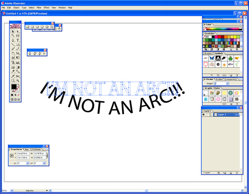

I'm trying to cut an arc of letters through Illustrator and can't get the letter outline to actually be in the arc. I'm trying to use Effects/Warp/Arc and then Creating Outlines for the letters. I'm still getting the paths not where the letters are. See picture. How do i move the paths to where the letters are so that i can cut the arced letters?

With it selected, click on Object Menu > Expand. This makes your modification permanent instead of being editable.
