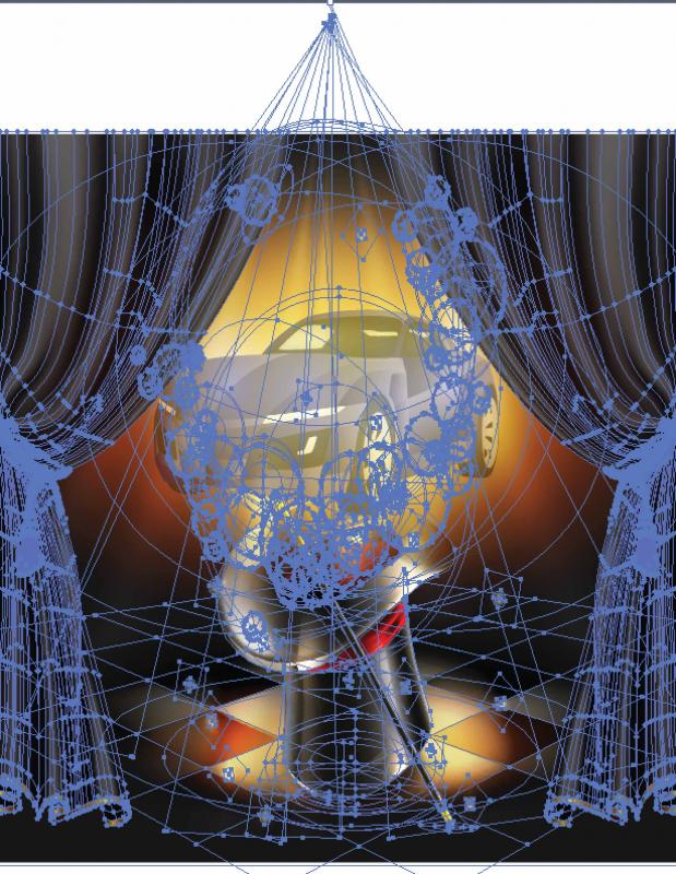

Can anyone tell me how to get the image within a complex design that has a perspective grid outside the image to resize? This is a purchased image that a client wanted and my Signlab 9 just won't pull it in and print with quality so I need to print directly from AI.
When I resized the artboard to necessary size that put the image inside it smaller as it takes into account the perspective grid.

Not sure how to expand the appearance. I have attached a screenshot that should help clarify. I will try the photoshop idea too never thought of that!

Hmmm, how big is your art and how big is the artboard?
Oftentimes if anything is past the edges of the artboard it won't let you do any kind of scaling.
You may need to build your art @ 50% size and then print or output your final PDF @ 200%.
Another option would be to have your artboard bigger than you need it at first, then scale your art to final size, and then resize your artboard to whatver you need.
