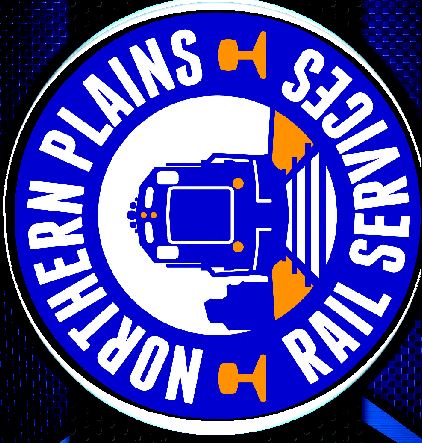

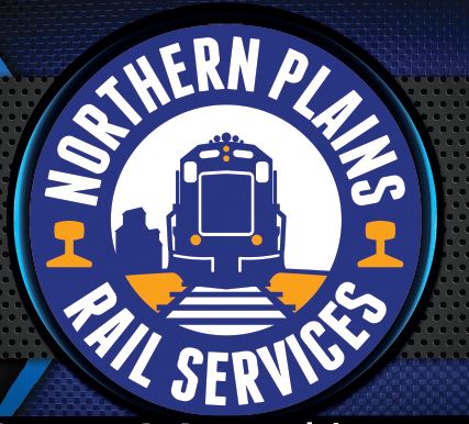

It is not. I snipped a few clips to show the missing piece so it would be a little easier to understand what I'm missing. Please note that 2nd image is the print image from versaworks so quality is really terrible, but the circle is completely white rather than the black shadowing.

if you're using VersaWorks, transparencies were always a constant struggle for me.

EPS doesn't support true transparency, among some other commonly used features in Illustrator. Gotta use PDF to keep those effects intact. The best thing is having the original Illustrator AI files. The next best thing is PDF files saved with Illustrator editing capability left intact.

If you're using illustrator just export it as a PNG and print the PNG. Some rips don't like transparencies / shadows - some pdfs are saved in an older format that also does not like transparencies or shadows. You can try to diagnose the file for hours and figure it out... But the best bet is to export it as PNG and move on!

Yeah, I kept trying the saved PDF but the transparencies didn't cross over for some reason. I tried saving as a new PDF from the original AI, but it still wouldn't stick for some reason :frustrated:

This did it! Thank you!
