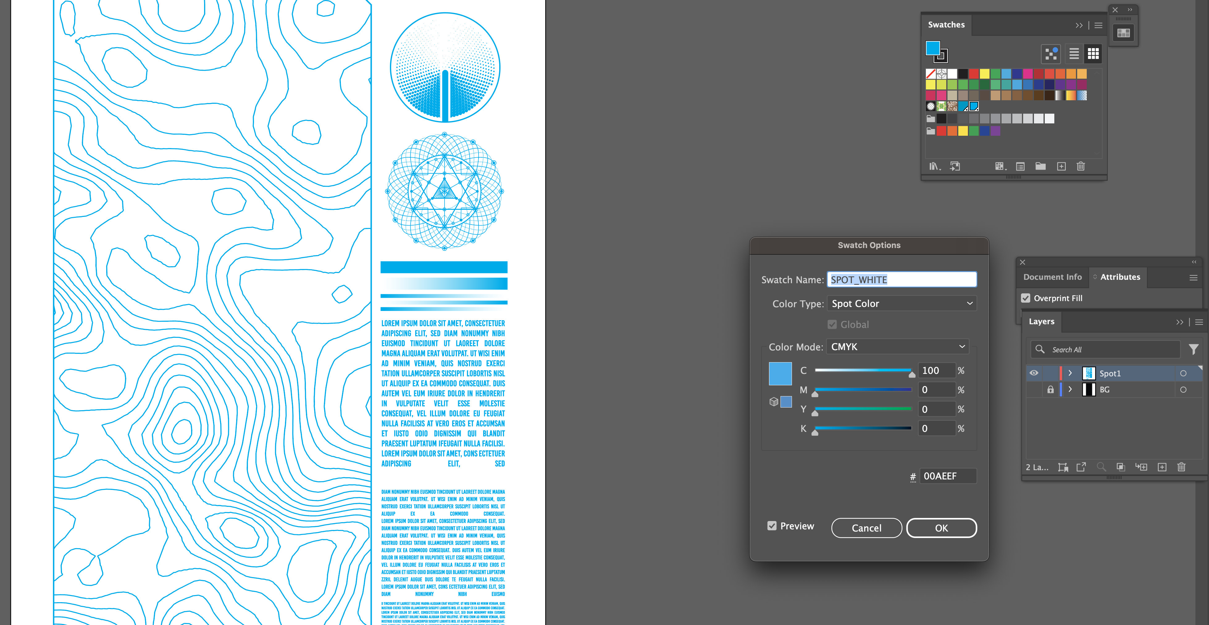

Issue #1: Registration color being printed instead of RIP only seeing SPOT1 for white layer.
......so per the HP guide I had to set the spot layer to an overprint channel and make sure that the white layer was a spot color. I have done this. Now where I think I went wrong is that the spot color itself is 100% CYAN vs any other color. SO when the printer printed the white, it also dropped the blue into the print as well. Whats more curious is that the blue which did contain gradient information printed the gradient correctly, however was not reflected in the white. Now the final result was pretty cool, and looks great. But I only wanted white..What color should the white be set to? Does it matter? And should I avoid all CMKY 100% mixes assuming ONYX is going to read them as registration colors. So far there is nothing telling me NOT to do this, so I figured it would be sufficient, but it doesn't seem to be.

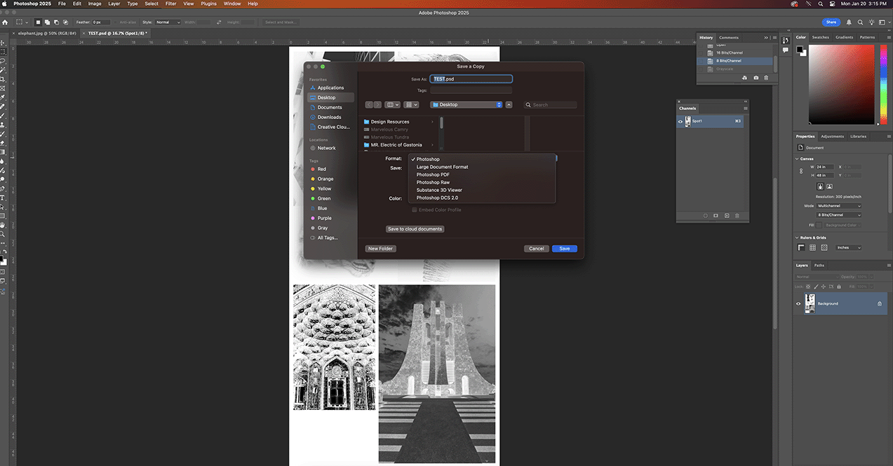

Issue #2 : Phothoshop is not letting me save a TIFF with a SPOT channel denoted in a grayscale image.
ONYX requires that you have an inverted spot channel in order to read the white information correctly and put it down on your media. So when I go to save, the actual save option for TIFF is non existent. I just sat on adobe help with remote access to my computer, and they were not able to resolve this issue. They assured me this is not a bug. IF this isnt a bug, then what am I doing wrong to get this to save correctly?

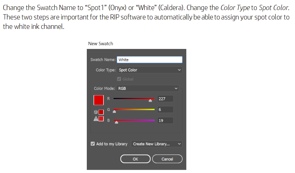

Here is a link to a series of video tutorials for various RIPs (including Onyx) and design apps (including Adobe) for handling white ink. Your questions are all answered in these video segments:
Cool I'll check it out. Thanks. I have seen one of these videos which was my initial start to this process, but it seems hes got some extra info on these so I'll definitely go over it. Thanks again.

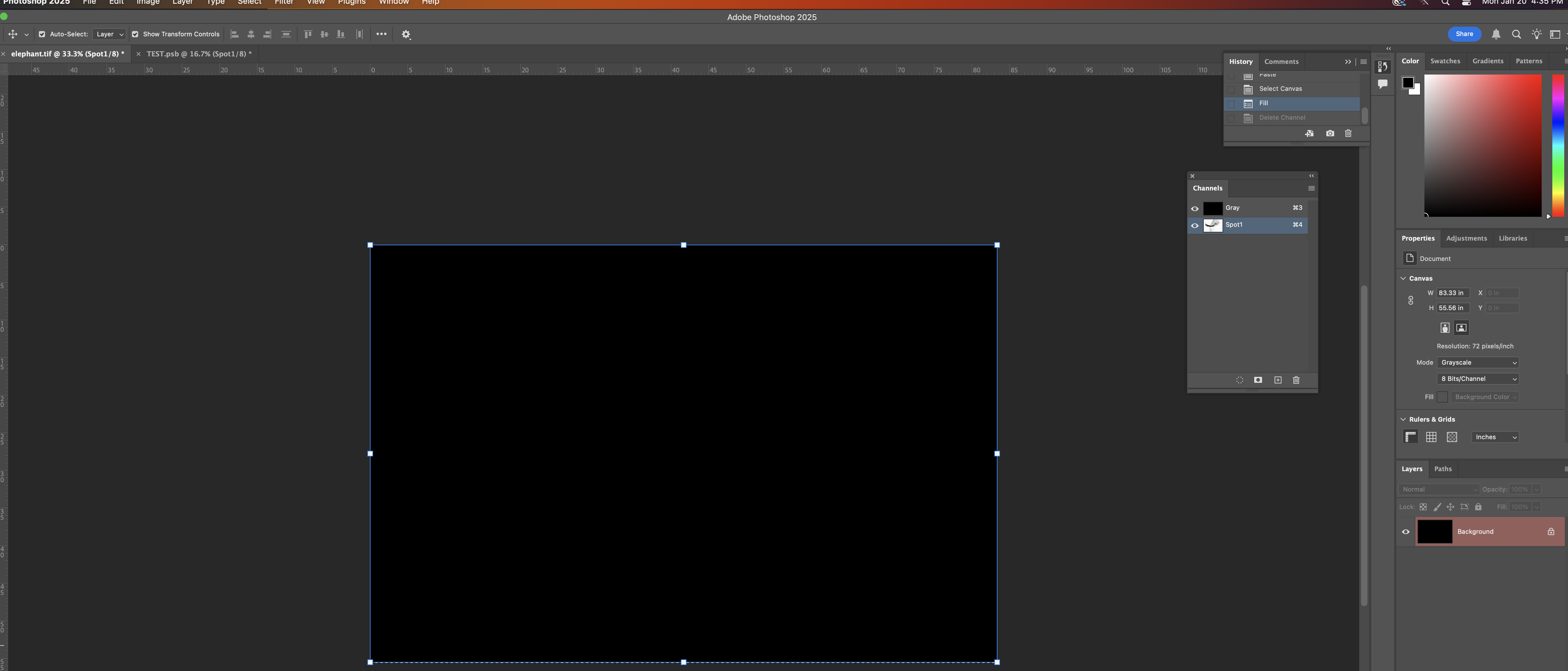

SO I wanted to reply to you guys on the second half of my issue here. I did figure this out.
So in order for the TIFF to populate in the save options, the file must remain with its source channel inside the channel stack with its contents deleted. Only then will the file type remain as a grayscale and allow you to save the spot color information. IF you delete that channel, rather than delete its contents, it turns into a multichannel mode, and does not allow a TIFF save option.

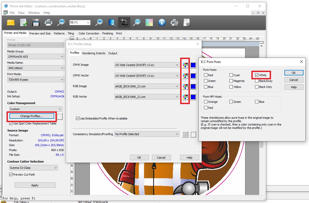

Sometimes a different than transparent (eg white) background does strange effects for several reasons, for example printing a few dots of a different color into white areas. For example when printing in absolut colorimetric rendering intent, what means it tries to simulate a special paper white.
In this case you should switch your setting to relative colorimetric, or you could set a pure hue for white (see attached picture). Would be more professional to search for the reason, but this could be a quick solution. Of course another issue could be a technical problem with your printer.

I figured the easiest solution to this would be to just set the actual color for the spot color to be white, then it cant do anything but that. My question then is though, does the rip only see gradients in the TIFF format from photoshop? Or can it do gradients inside a PDF from illustrator and not read it as solid blocks?

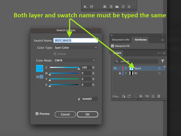

See if this works, i tried to tread through the comments and I could be repeating it. As far as I know using Illustrator > ONYX 22
Both layer name and swatch name must be spelled and typed the same

Here is the screenshot of how this is setup. View attachment 175675
As mentioned... change "SPOT_White" To "Spot1" Onyx uses the swatch name... not the layer name to generate white. It's good practice to have it as Spot1 in a layer, but not necessarily needed. When you change it to Spot1 and import it into onyx with a white quickset, it should show up as green in your rip
Ill try this... But HP's guide for onyx specifically says to name it SPOT_WHITE... But im gonna try this anyway.

No this is what it tells you to do. Layer name doesn't make any difference. It doesn't even have to be on its own layer.
Then maybe my manual is incorrect. However despite that, I have changed this. Specifically in order to get ONYX to read the gradient inside the spot I exported separations in a PDF VIA Export for screens, and my last sample print came out exactly the way I intended.
