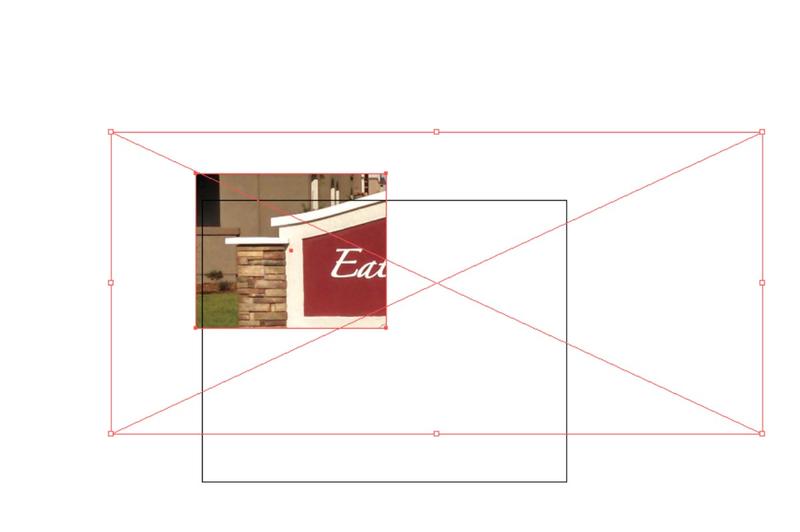

see attached - the bounding box is still the size of the entire image, not just the clipped portion - so resizing just the clip is a pain
I select masked objects in the layers panel and it always selects them as the object serving as the mask. Now if I double click the mask group, you have entered that group and the art is selectable.
Edit: as a mask now, the ONLY clickable area is the bounding box(outline) of that mask shape. Since it is now seen as a "window" in Illustrator, you would click through the object always selecting the layer underneath.
J Hill Designs
