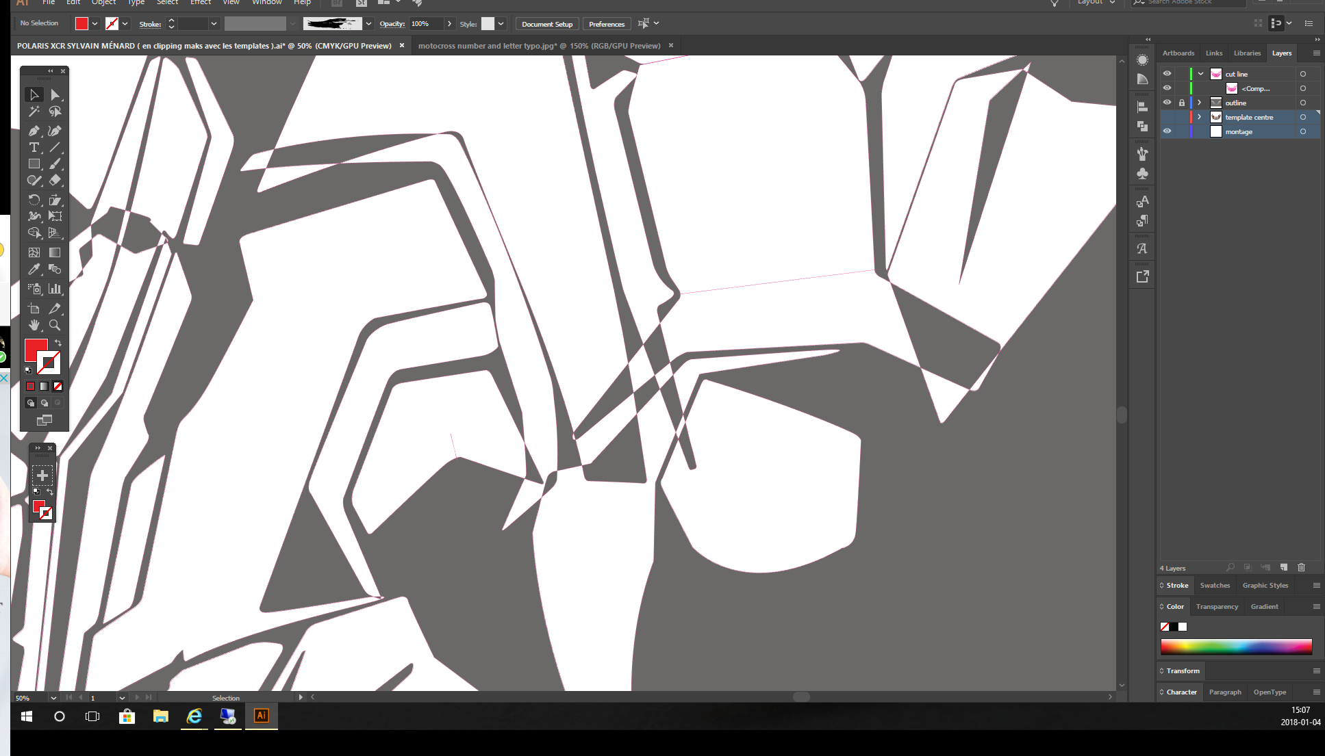

If somebody here know how to work with snowmobile , motocross template. I'm stock just before printing ...
The template is designed to fit once install on shaped plastic , so it is overlapping at some place for the design purpose to be sure the design will align once install , but I have to separate all the piece before printing to get my full template path,
if somebody is willing to give me a lesson on teamviewer , i'm interested
Thanks to all!

yes , I want to print , laminate and cut it ... I've done the cut line ,
here is my layer
1 is the cut line ( outline only )
1 is the outline ( the aera around the template , to see the result even before doina clipping mask
1 is the template
1 is my design
I want to separate the template after the design done and have my design following it , then I guess I will have to work on some empty area when I will separate )
but I dont know how to separate after clipping mask is done having the design locked with the template path

So not exact sure what your asking.
Some of this depends on what rip you have.
You have your template, I would have it with no fill and maybe a stroke of a contrasting color so you can see it. Lock that layer
Create another layer under it and do your design.
Once you design is done use the Pathfinder tools in Illustrator to separate it using your template layer ( you might have to give it a fill)
Now that all the pieces are separated you can move them around to fit your printer.
From there you can apply your contour cut, print, laminate, cut, weed and done.

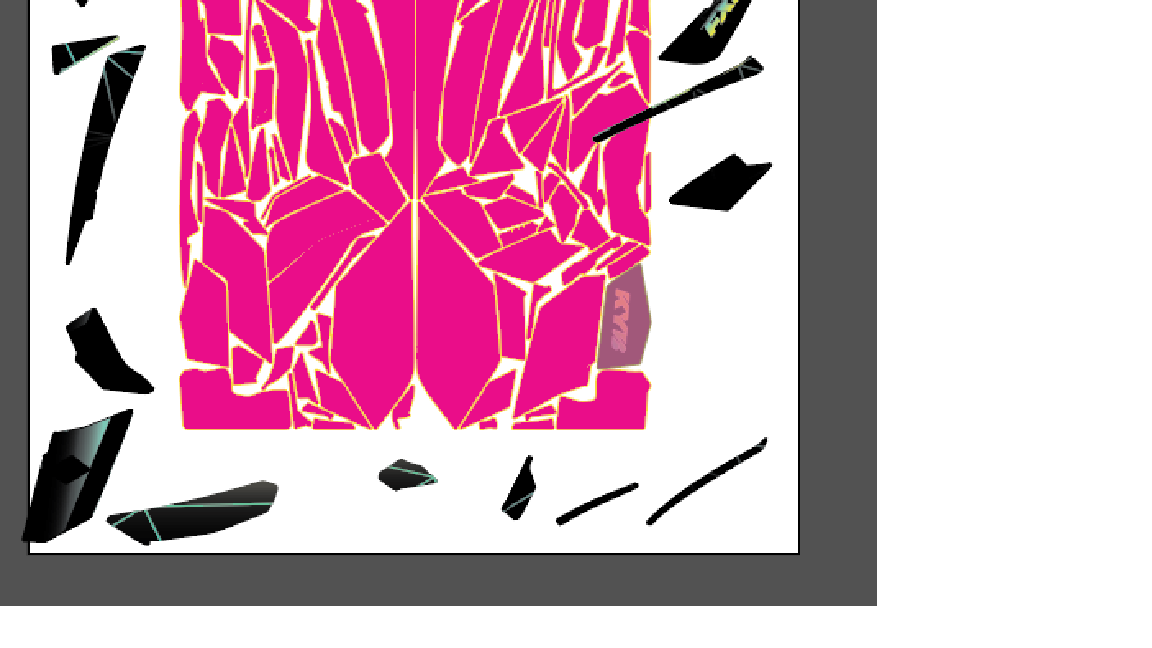

sorry it is kinda hard for me to explain well cause i speak mainly french ...
i have to do nesting ( take my files , do clipping mask with each layer of the compound path , then move it into my nest file ) but i wonder if there is a better way to realign ( including the rotation alignement )
Dex Savage
DEXSACO
i start from a template , here is my nest file for 48'' print , i have all my clipping mask around , and need to snap it piece by piece to have my cut line ... there might be another way... thanks
There are some plugins for Illy, but they won’t work correctly with clipping mask. You will have to crop everything outside the clipping mask. And that’s a PITA.
I use this one eCut Adobe Illustrator plugins: nesting, plotting, cnc - Main
