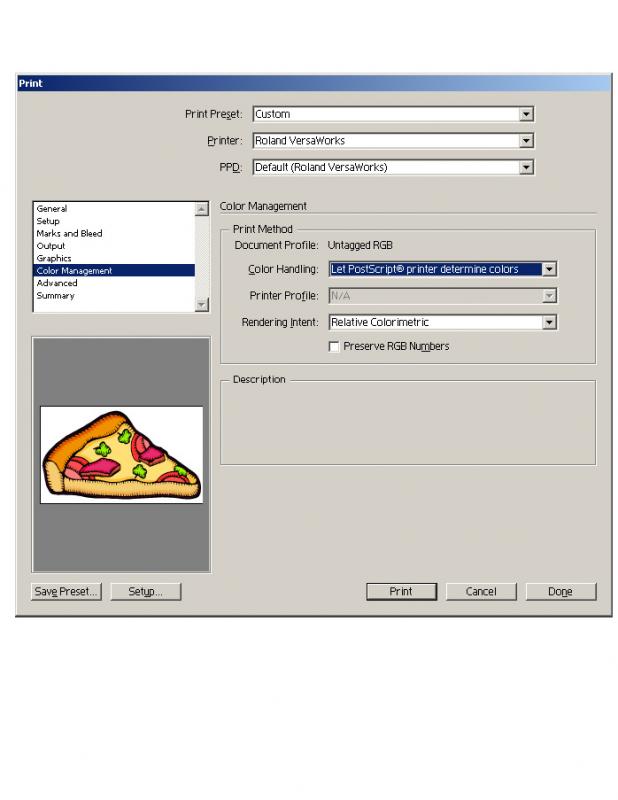

guillermo
when I print from Illustrator I use these settings........ and the color are fine, if not I will get the image in gray scale...:doh:
try the highlighted settings in this image
