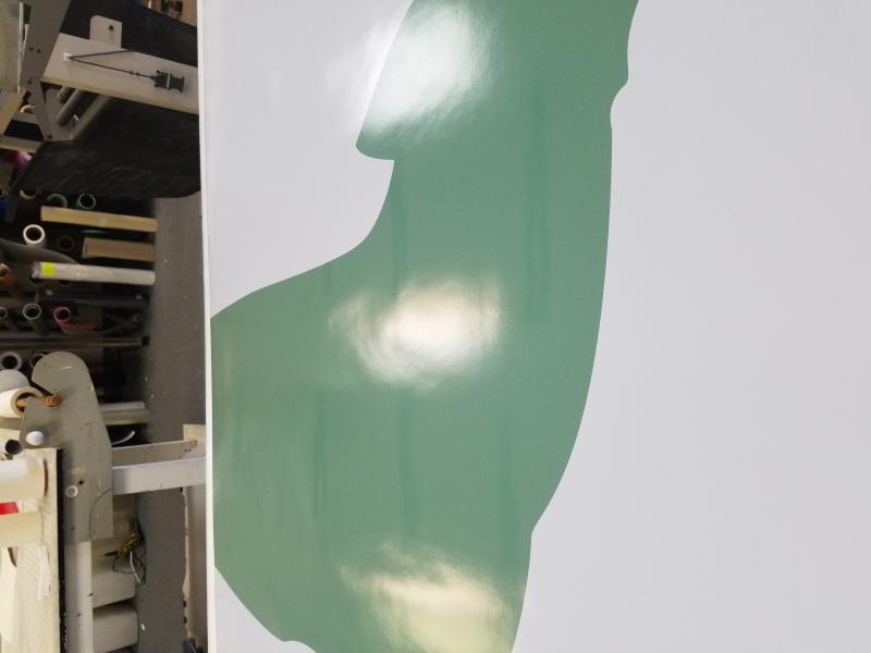

Any idea what could be causing this?
s30670
Are those streaks in the direction of travel of the vinyl?
That happens to me, when the media is buckling slightly in between the pinch rollers. Fought with this, just this weekend on some perf that printed fine a couple weeks ago... Lowering heat in the platen area might help. Looking forward to other replies.
subarutex
Correct. The streaks are in the direction the vinyl is traveling.
Lowering heat sometimes helps, but it is hit or miss. I can print the same job 3 times in a row. Have the 1st one be fine, the 2nd one with streaks, and the 3rd one be perfect again.
I have also investigated if it is caused by static.
One of those random errors that just drives you crazy.
a77
If you look through the viewing window you can sometimes see the vinyl puckering up where those streaks are. I believe re-aligning both your takeup reel and feed reels using will help with that. If the vinyl is trying to go left or right due to misalignment, it wants to bunch up a bit, and you see these ridges appear usually between pinch roller sets.
