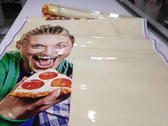

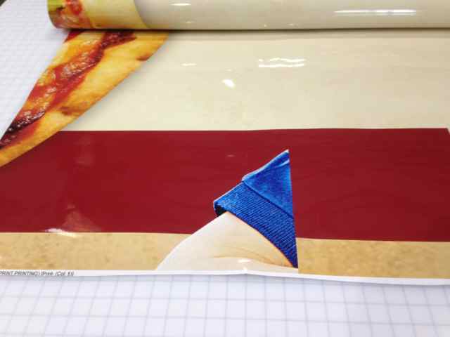

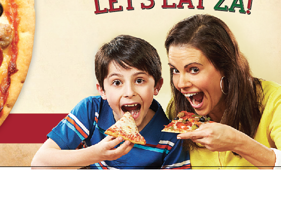

I ripped and printed a trailer last night. The art is a combo of vector & raster art. The print cut off part of the raster image on both sides of the trailer (2 different files). It shows up fine in the RIP preview, but it almost seems like it stopped processing part of the raster image or something. This happened on both sides of the trailer with two totally different files.
See the image and let me know your thoughts.

DesireeM
Yeah - will need to see the image and maybe a screen cap of the settings in the rip software.
Shot in the dark but I've had issues with digital information "disappearing" in the past because my Rip software's print queue was too full. I have a bad habit of not deleting jobs from the queue after they are done and eventually I get this issue and have to go and delete everything.

shoresigns
Those are some great stock photos. Damned shame of a missed opportunity if they didn't call the restaurant EAT ZA PIZZA!!!

Just wanted to update everyone. I ended up printing the first 4 panels of the wrap (which were correct). Then I flipped the file upside down and ripped it again. So again, I was able to use the first couple tiles as they ripped correctly.
Not sure what happened, but the RIP seemed to just stop processing correctly after about 300". I haven't had the issue since.
