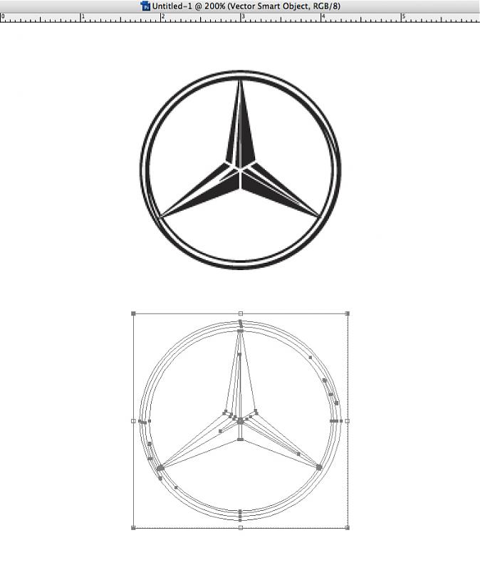

The first one was a vector piece pasted from Illustrator as a Smart Object then rasterized. The second one was pasted as a path.
