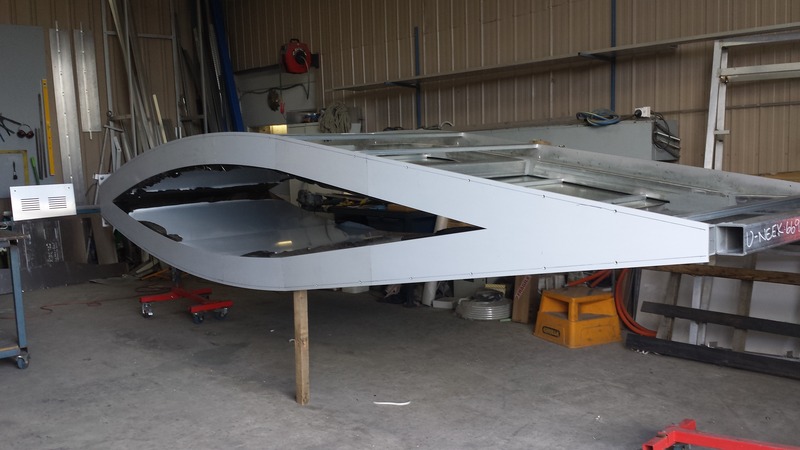

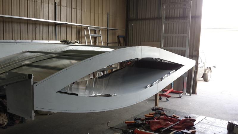

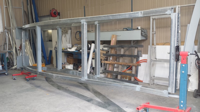

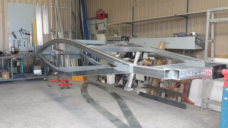

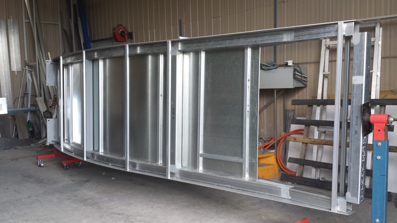

Currently building a hospital main ID pylon 5.5M x 1.5M.
I don't always mount pylon frames on gimbals (read modified engine stands) but the amount of times this sign needs to be flipped certainly warrants it.
The inner and side faces are clad in mirror finish stainless. just waiting on the cut through face panels from the powder coaters.
