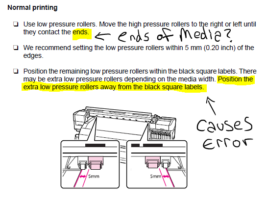

After reading the PDF manual, I'm seeing some differences in how I was told to load the media than how Epson says to do it, or their wording is slightly confusing.
How I have been told to load media:
#1 - Printing Opaque media - High pressure rollers moved off to the far edges not contacting the media, low pressure rollers aligned to the black squares.
#2 - Transparent media / multiple imprint - High pressure rollers aligned to edges of media, low pressure rollers moved away from black squares.
How I understand Epson says it should be done:
#1 - Printing Opaque media - High pressure rollers aligned to edges of media, low pressure rollers aligned to the black squares. *
* This causes an error stating that the pinch rollers are not aligned correctly. It seems that the machine does not want both high pressure and low pressure rollers in play at the same time, or possibly doesn't like that there are not enough black marks to align all low pressure rollers under. It is entirely possible that I am reading the instruction incorrectly in the PDF.

You only use the metal high pressure rollers when doing multilayered prints because it has to roll the media back through the printer, and the regular rollers would smear you ink and get themselves contaminated. You never use both types of rollers at once. Whichever roller you use, it always has to be in one of the black blocks to work.
FactorDesign
Thanks Unclebun,
The diagram in the PDF makes it look like they use both. Now that I know the loading is done correctly, I can try to dial in any other issues!
Their manual reads:
<<Normal printing
Use low pressure rollers. Move the high pressure rollers right or left until they contact the ends.>>
They mean the ends of the track (lack of better word). IOW, to the extreme left and right and off of the media.
