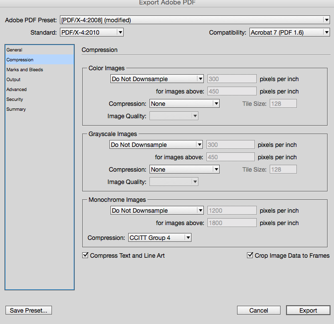

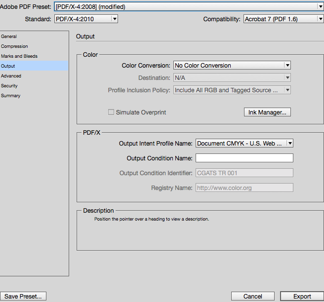

I have an InDesign file that has 2 linked .psd files in it. I need to save a high-res file from InDesign so I can print.
The InDesign file is 1/10 scale. When I try saving PDF I change settings to not downsample images but it comes out like crap.
Here is a shot of one of the settings.
Thanks Team!

Hi, just select a High Quality Print preset on the top and see if that works.
Let it downsample, there is no necessity not to especially when you scale it to 1/10

I think you are doing it correctly. You don't want any downsampling. What is the rez of the linked PSD files (go to Window-Links)? Since you are at 10% size, it should be at least 500-700dpi (since it is being blown up 10x), otherwise it will look bad when output.
