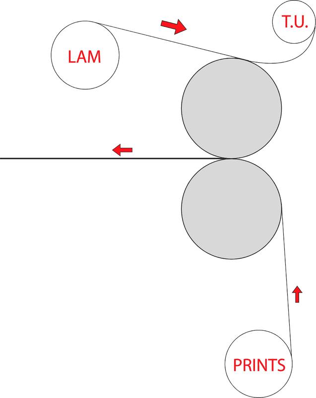

I usually only lose about 12" length on ours to get it loaded....I just get the liner taped up on the take up (I slip an old material core on the take up so I can just pull that whole thing off and toss it). Then pull out enough laminate to stick to the back platform, pull the print up under the roller, drop it down and let it rip.

I see... I only have to go from the take-up reel to the roller, not from the roll to the roller. What about the print to the take-up reel? Do you use some scrap to bridge the gap or do you quickly tape it to the reel when it gets there?

Not understanding your question..print to the take-up reel?

Oh...I don't have a print take up on ours....600-S. This is our usual setup.

We don't use a take up reel either (though I wish we could). We just have an 8' table behind the laminator that we lay the prints out on, and we cut panels about every 8' as they laminate.

We have exactly that model, with the take up, but still use a table instead of the take up. Just find it easier. In fact we have a table in front and behind and place the roll of prints on a device on the front table and let the rollers pull them through. We find there's just more chance to react to problems before they occur if we do it like this.
The only wastage we get when we load the machine is the distance from the rollers to the grey metal bar thing on the backside of the laminator (less than a foot).
