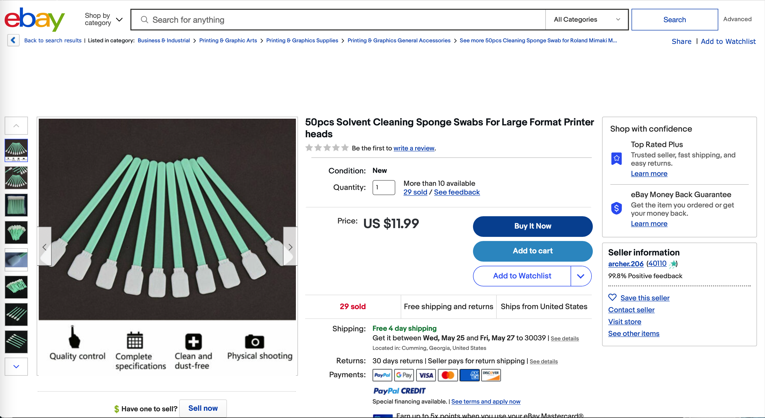

Use Foam Tip cleaning Swabs. 1/2" or 12mm there abouts. eBay See Photo
Buy 2 bags, You will need
On my HP 9000s I would use HemoStats (6") to create an extension.
The amount of sheit built up on them Caps; is built up on the face yo print heads.
I have bought from this eBay seller before.
Typically I would buy 4 bags.

I buy the swabs from Amazon.
Buy them in a bulk pack of 300 and clean your Roland on a regular schedule, like weekly.
