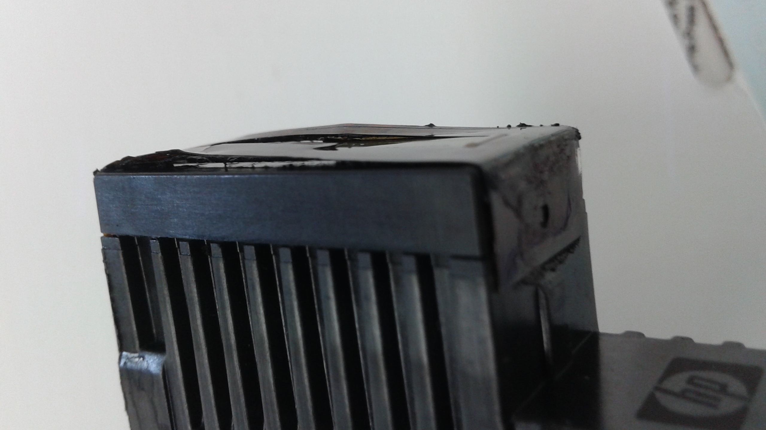

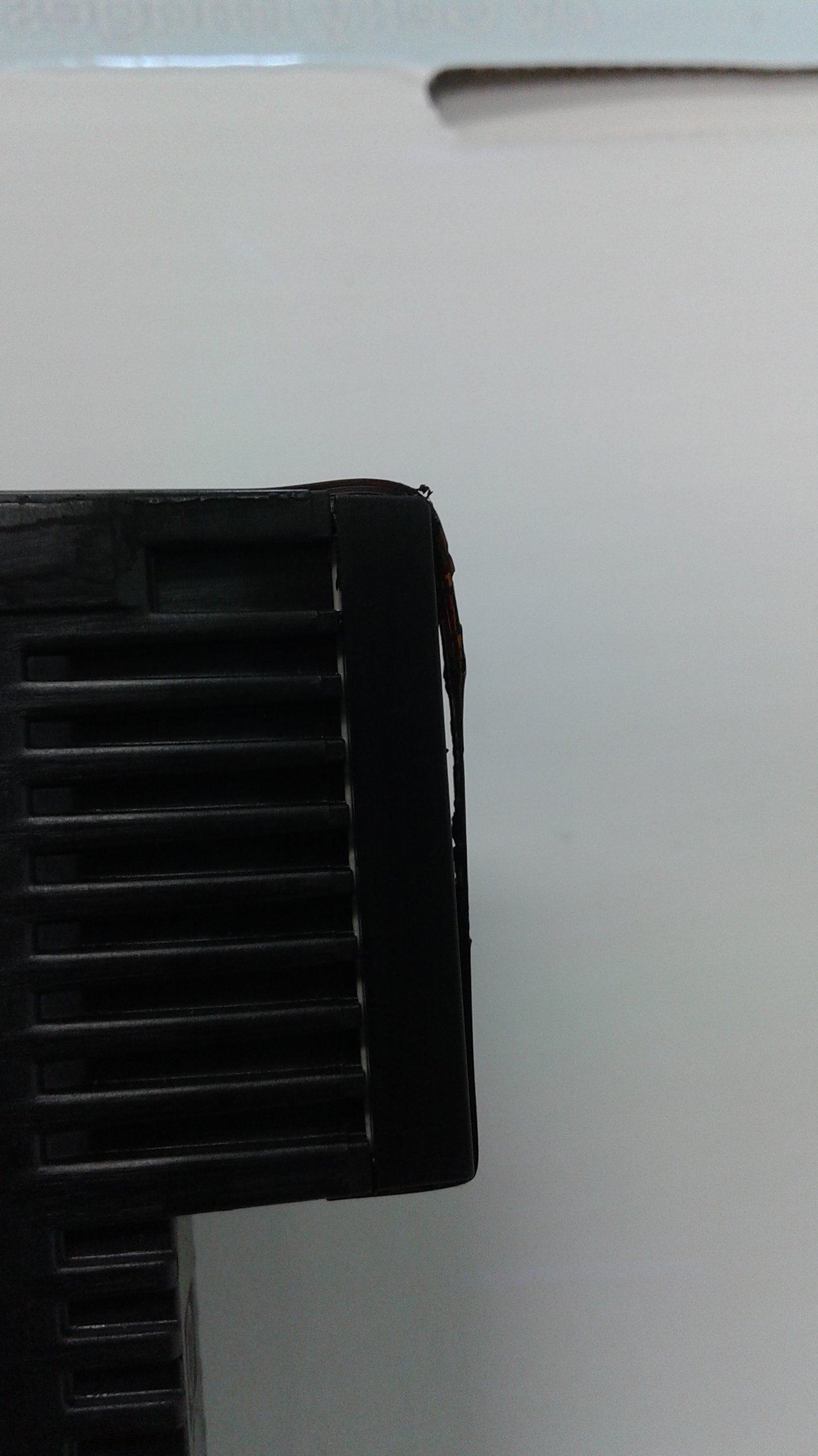

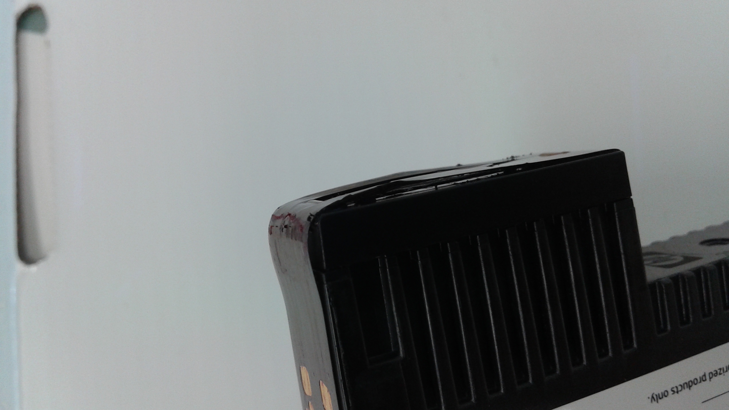

Hi guys,
Has anyone seen this before? Ink build-up under the electrical strip on the printhead causing it to become slightly separated? I'm seeing some banding on light pink colours and on the print test pattern have some misaligned nozzles on the YM printhead #5. Simply a case of replace the printhead or something else going on?

Dan360
Ive only ever had that part separate from head strikes or just age. My guess is that it started separating without any ink build-up and it just got worse as ink got underneath the strip. Typically when I see this type of thing, the head is bust.
Lane J
It looks pretty gooched to me.I would probably replace. I see that from time to time - the ribbon lifts up and begins to tears as it prints. Not sure if it's from physically damage (head crash, head strike) or the ribbon just lifts up over time. I see it mostly on the lc/lm head or Y/M head.
Do you know how much ink went through the head? Fairly new or an old head?
Lea Marc
Funny you should say that. The #5 YM head has 2100ml through it and the #6 YM has 4467ml so they don't owe us anything. We have had some head strikes recently on banner material so that may have something to do with it.
