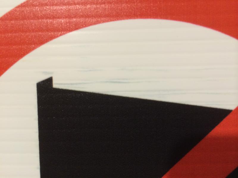

We have a AGFA Anapurna M which has served us well for quite a few years.
Currently we have a problem where the ink is spraying over the material, which sort of looks like it could be caused by static but I'm having second thoughts for a few reasons
as this has only started recently - material and process has not changed.
When I look at the print head base plate when this is happening, the whole thing looks very damp like there is lots of moisture on it so I'm starting to think perhaps it is something to do with the compressed air dryer.
I'm not sure what it is supposed to read but the units seem to be in degrees Celsius and often has been sitting around 0 and slightly above, although my brother sent me a picture with it showing just under 10 the other day.
Attached picture for a visual of what I'm describing
Appreciate any info
