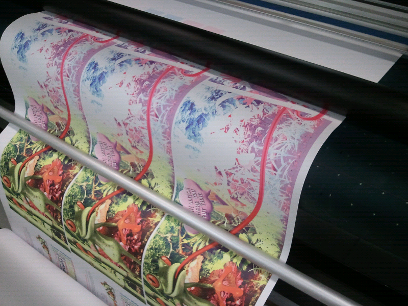

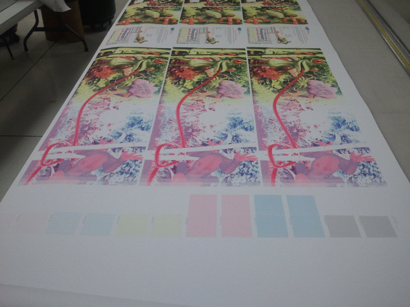

We've got a service call placed but I wanted to see if anybody here has also come across this issue. This is the second time we've seen this with our FB950, luckily this time it was attended to. Ran a prime bar immediately following the cancelled print and had absolutely nothing from black, yellow, light cyan, or light magenta. Not a single jet. Cyan & magenta were firing all jets. All jets come back after a purge, although at least in this most recent case, the machine had completed one of its auto purges before starting to print. You can see in the picture where it lost the inks and the prime bars. Of course, its so random that who knows how long it will.take to troubleshoot....

you are not in as much trouble as you may think you are in. What you are seeing is a firmware bug, and you do not have the latest version of the printers software loaded. It's a goofy issue to try and troubleshoot, because the set of conditions needed to bring this issue on are related to ambient temperature of the carriage, and a particular amount of time between the last finished job, and the next batch to start running.
I'll spare you the mumbo-jumbo, just go get and install the latest ffirmware, and you should not see that again.
