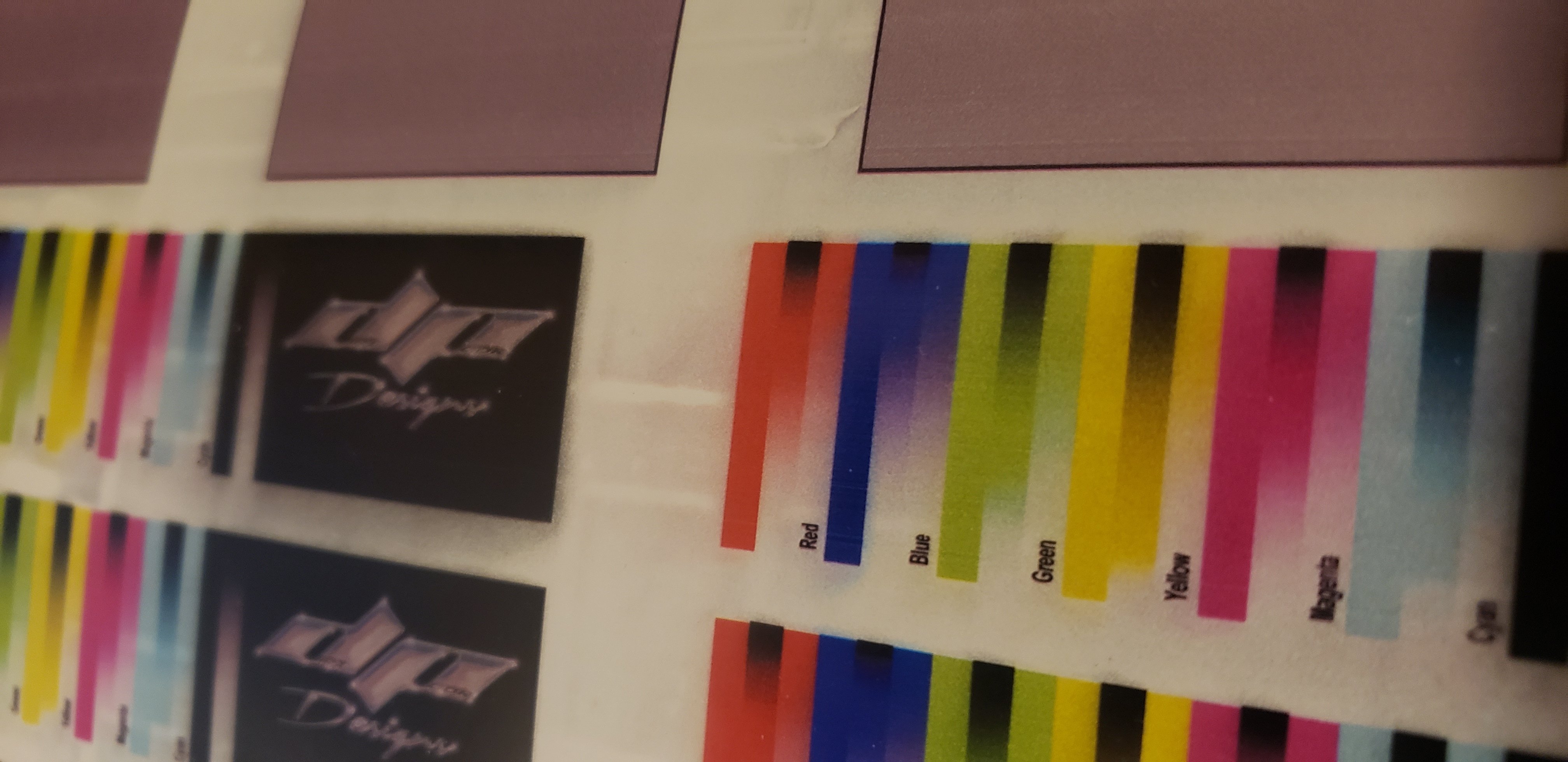

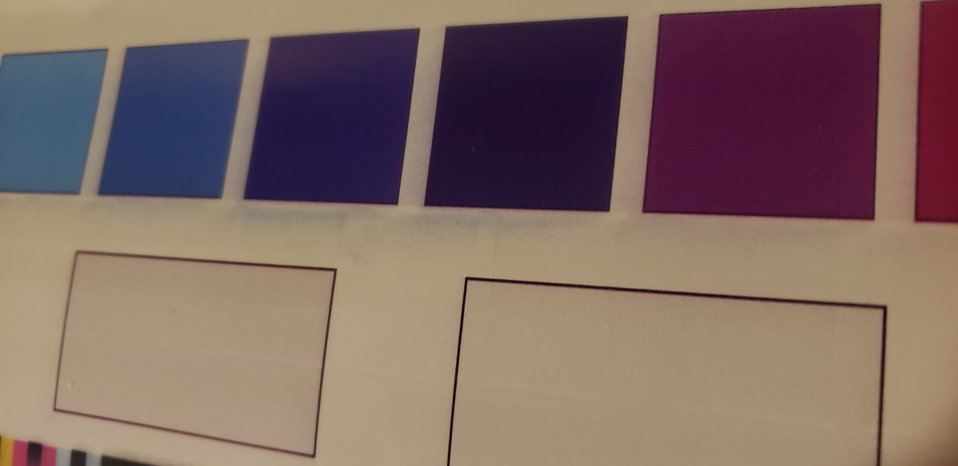

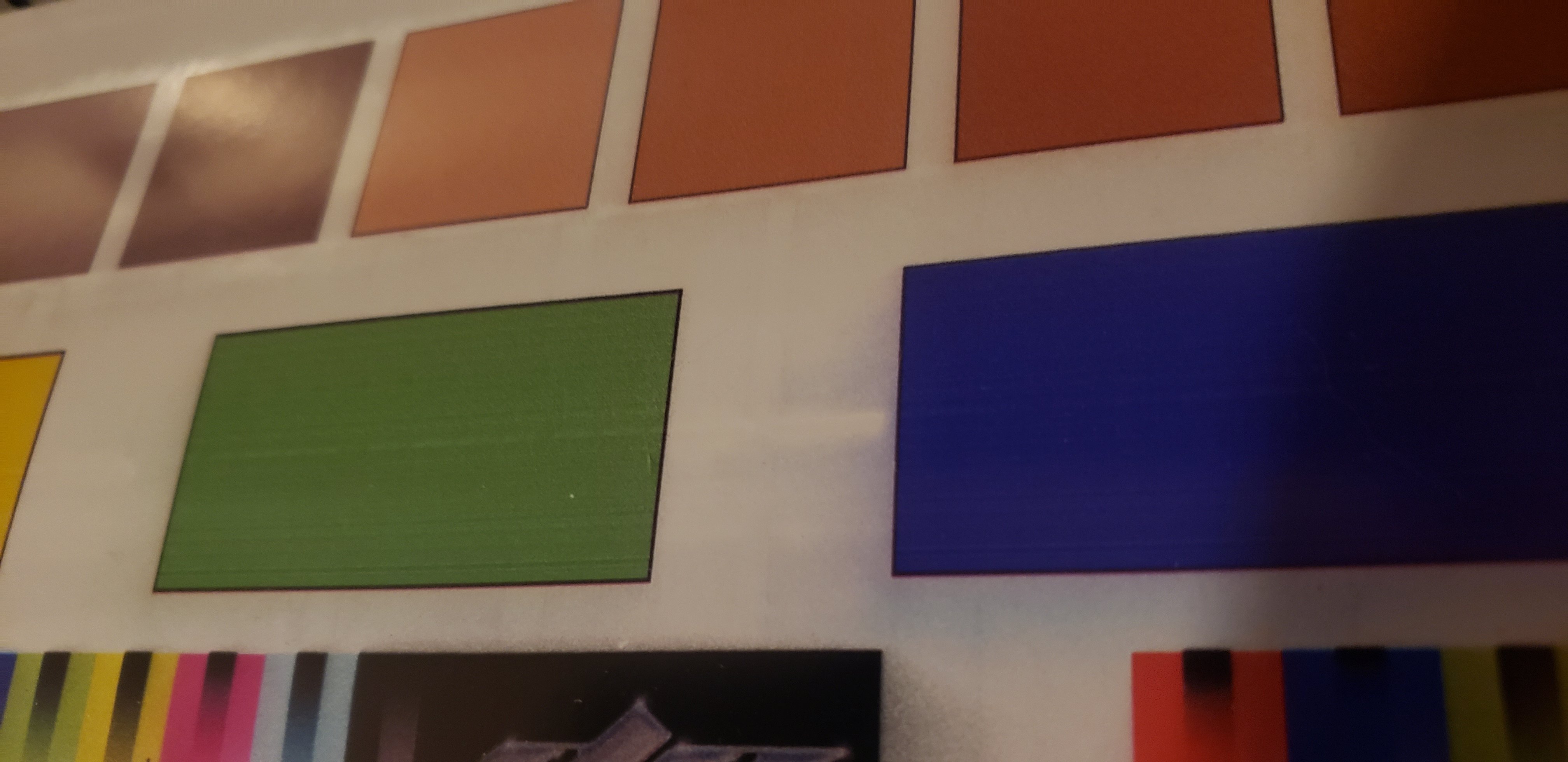

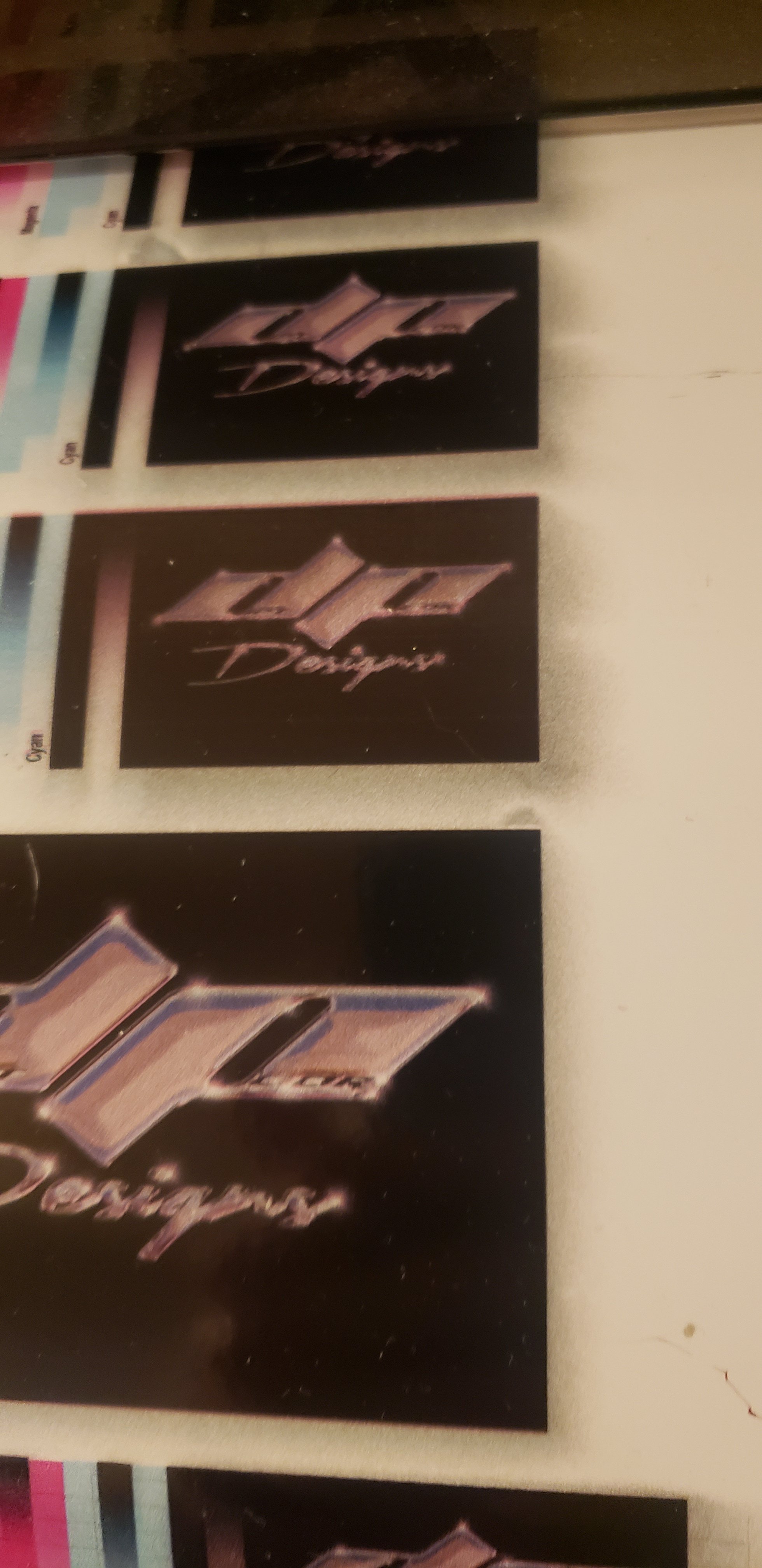

Can someone please tell me how to fix this? We've cleaned it and cleaned it. Last time it did this we just kept printing and eventually stopped. We don't know what is causing it or how to fix it. I dont know the tearm for it, bleeding?, overspray?, leaking ink?, smearing? Its been 5 days and I don't know what to do. All colors are doing it. Please help.

It's most likely a failing head but you can try changing the head cables out to see if they're causing the issue. What does your nozzle check look like?

I'd call that overspray. Are you using OEM ink? Is the ink within the expiration date? Is the printer in a warm enough environment?

My printer did something similar once, tech advised me to clean the decoders strip. Don't know if that will work for you but couldn't hurt.

I had the same issue before few years ago with the Cyan ink only over spraying, it turned out to be a bad batch of OEM UMS Cyan ink. I had to replace the printhead as the damage was permanent.

With many confidence i would tell you that is just printhead cables or printhead connectors dirty or like solventinkjet said, a failing printhead. But begin checking for dirty connectors or ink in connectors
