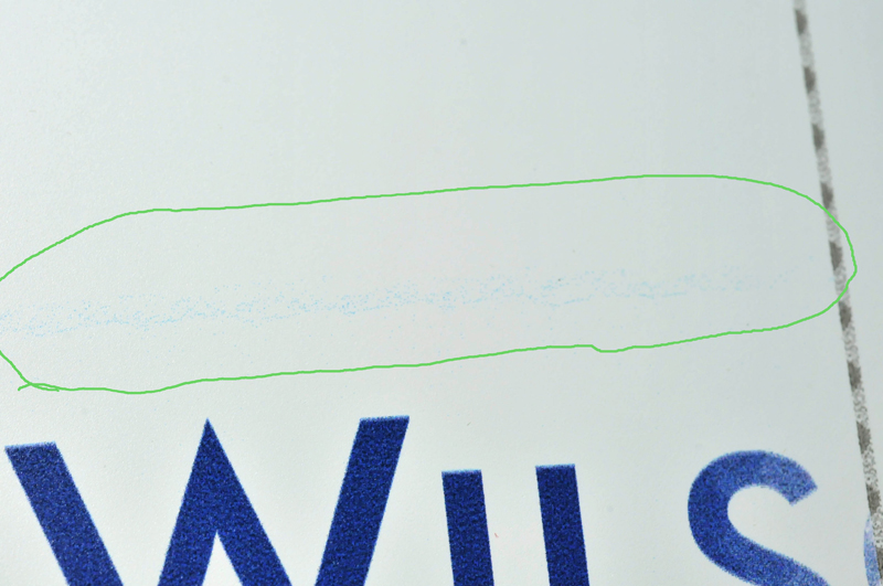

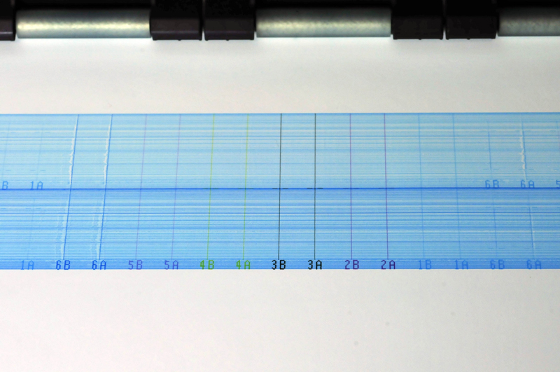

has anyone had this issue with a valuejet it is printing blue lines,
attached is an image
we have aligned the print head, after we have done that we confirmed with a print out and it has blie ink all over the print out
the nozzle checks are fine
Thanks

knabbie
we haven't replaced or changed any parts
I can check to see if a cable has come loose from the print head
Beyond 1
I had the same thing happen to me on my Mutoh... Just had to change the printer data cable... It's not that exspensive... I would buy 4 a change all of them why u have it apart.
Good luck
knabbie
Would you know where the best place to get the data cables from?
We have gotten parts from Lave Ink and they have sent the wrong parts.
SE SignSupply
I have seen that a few times, most likely you are going to need a new head.
However, since you are doing alignments did you just replace the head?
knabbie
I 'm not sure if it is adjusting the heads,
we checked the uni and bi- directional for the heads and adjusted them
we put a band aid on the issue, we have the printer printing a cyan boarder, which prints the blue line just past the image.
It doesn't seam to do this when we print banners on the lower quality settings
we will probably change out the data cables,
