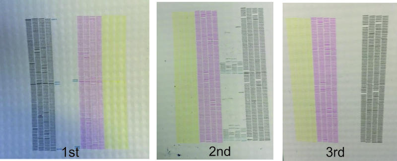

My cyan ink ran out and after replacing with new cartridge, pouring cleaning solution into cap tops, several heavy and medium cleanings and soaking head with swab it stopped printing completely. Help! I have a Roland sp-540v

soak the cap and see if its hose is clogged.. just had to unclog one in our roland. The hose sits low and pools inside... design flaw if you ask me.
Soak the pad pull the hose and squeeze form the top to the bottom when you stop seeing bubbles that's where the clog needs worked out. after you get fluid passing through the hose do a powerful clean on the specific head group.
Ragnabrok
pull with a syringe, listen for a hiss, or lack of vacuum. If it isn't sealing somewhere, running cleanings won't improve anything.

I pulled cap top out and poured solution in top and it came out the bottom? I pulled all little hoses out and ran fluid thru. Still no cyan..

The guy in the video means well, but as he states he is a truck driver and bought the printer used. I would not follow what he says or did. His situation was different than yours, he should have done a head soak.
Powerful cleanings really suck back the ink. I almost never do them.
Never scrub the head. You can embed particles into the jets that will never dislodge. The nozzles are very delicate and can be deformed causing permanent deflections.
You have to watch out with pulling on the heads with a syringe. It is easy to pop a thin membrane in the head which ruins it.
Glad you got it going.
player
For your situation I would have checked the damper to see if there was ink in the damper and the ink line by the damper. If there wasn't, I would have pinched the red/yellow damper and done a few regular cleanings until the ink came back up the line and into the damper and the print head. By blocking off the other head you save the ink, although it would not be a deal breaker if you did not do that step...
I also would consider pulling with a syringe, but very slowly and with very little pressure to prevent the membrane from being damaged inside the DX4 head.
Someone who is not afraid of cracking the carburetor might remove the damper, syringe the ink into the damper from the manifold opening on the damper. When the damper is full of ink, put it back on the head. For me too risky with cracking the carburetor and dribbling ink on the head board.
